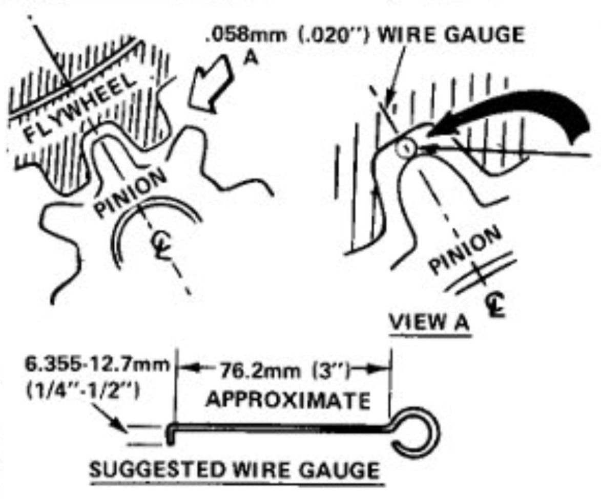

I would check to make sure the starter is disengaging. Check out

Is the pinion to the flywheel gap correct?
