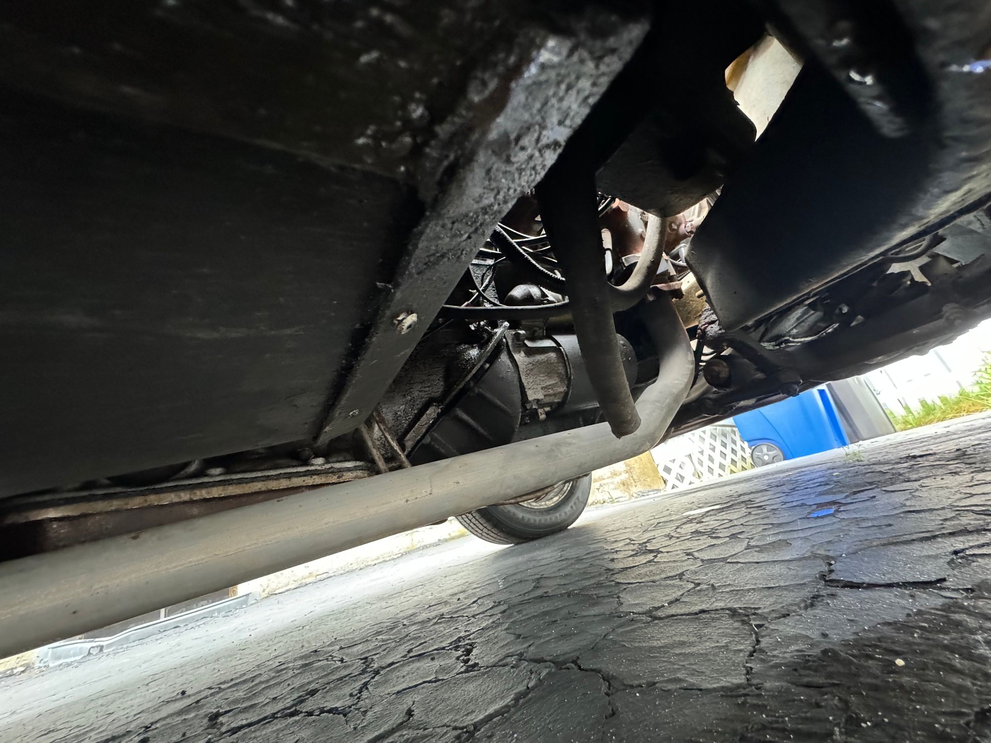

Hi all!
New to this thread, just purchased a 79. It came with a few issues, the main that I am dealing with is the headlights remain up and don’t even attempt to close when the lights are off. What I do know is that the owner before me removed the heater core due to a leak there, which from my research must have caused a vacuum leak? I found this hose that doesn’t appear to have a home, wondering if anyone has any idea where this goes or if it’s the cause of my issues. The car runs and drives just fine.

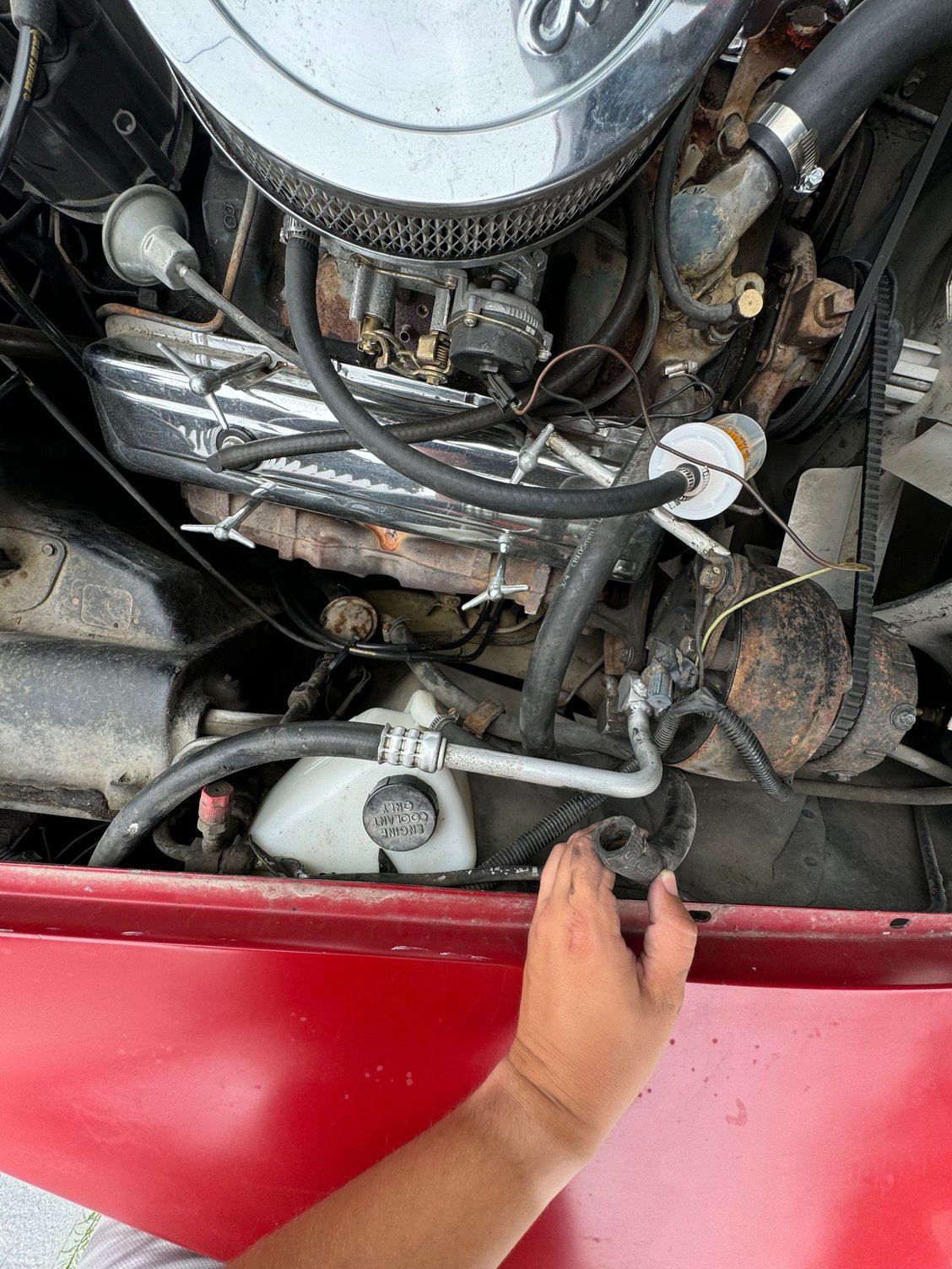

Looks to be a heater core hose that would connect to the water pump just above the lower radiator hose.
You can cut it off where it's attached at the firewall.

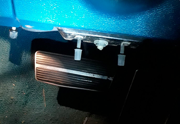

RE: is your headlight override valve under the steering column pushed upward? The override is there if something happens that you need the lights up for some other reason without using the dash light switch.
Your car would only have one of the valves shown in this pic, the other was for the wiper door on earlier C3s.

Looked at your engine pic again: appears they looped the upper and lower block connections for the heater hoses together with a single hose. Just remove what you have in your hand and toss it. That it's still connected to something, I suspect the previous owner didn't actually remove the heater core - merely took it out of the coolant loop.

Thanks for the reply, I checked that valve under the steering column, it was pulled out. I pushed it back in and the headlights came down, however wont go back up.

Would this open hose be the cause of my leak? Its connected to that relay? in the pic. If so how do I go about capping that off?

A unused heater hose has absolutely nothing to do with your vacuum system. Is your car running when you try to get your lights up?

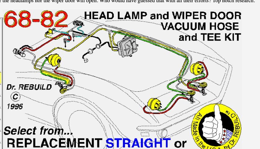

I think it's time to hit the vacuum diagrams for the headlight system. Being that you have a '79 I'm not confident advising on routing from the front vacuum tank (earlier C3s had the tank under the left fender by the firewall). Here's the diagram I have saved, but it is for earlier C3s with wiper doors and the rearward vac tank – the few components on the left can be ignored for your car. Someone here will provide an appropriate diagram for your car.

Yes, you need vacuum both ways. The headlight and under dash valve are small line hoses that go to controllers between the headlights (in the diagram the two centered components with all the hoses connected to them). These controllers move a small piston from one large hose to the other so that the main vacuum signal is switched, causing an open signal or a close signal to the actuators (the large pie-plate looking deals at the back of each door).
Do you have a Mity-Vac sort of hand vac pump? They're pretty handy to have to check these components.

I am surprised no one has mentioned what appears to be a plastic fuel filter in a rubber line with worm clamps over the exhaust manifold area in one of the pics.
