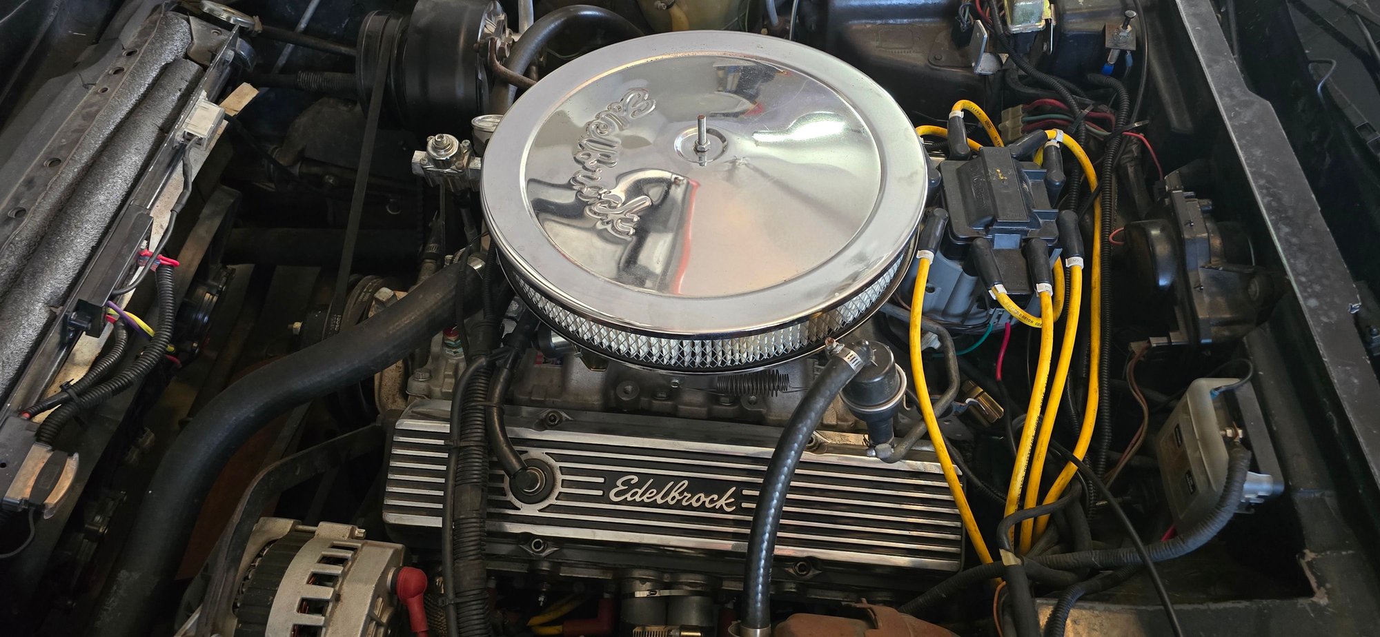

I have the Edelbrock Tall valve covers. They cost a pretty penny, but they look good. If you have a/c, you will have to modify the bracket just a tad. You can either bend it or shim it.
Sorry this should have been first picture.
To Tall SBC Valve Covers
