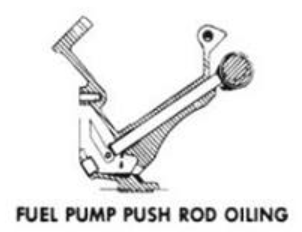

I found this BBC oiling diagram which shows an outline of the pushrod going thru the block.
You can just see the fuel pump pushrod on the lower left.
For the OP it shows that only a little bit of the pushrod sticks out of the block to grab from below.
Based on Reelav8rs measurements, it needs to be at least .330"
And the top portion get almost completely buried in it's tunnel at the same time, and if it has a bronze tip, that is getting mushroomed, I could see how easily it could get stuck in the tunnel.
Now without pulling the manifold I am not sure how you could confirm what is happening up top.
If you have a borescope, it is probably long enough, you could snake it thru the distributor hole, and all the way to the other end of the cam, and find the pushrod tip, and maybe see what is going on.
2nd choice is to pull the closest pushrod and go in that way thru the valve cover.
That one sounds easier to me.
Or yank the intake.

454 block fuel pump pushrod hole behind the fuel pump. Very little of pushrod will stick out.

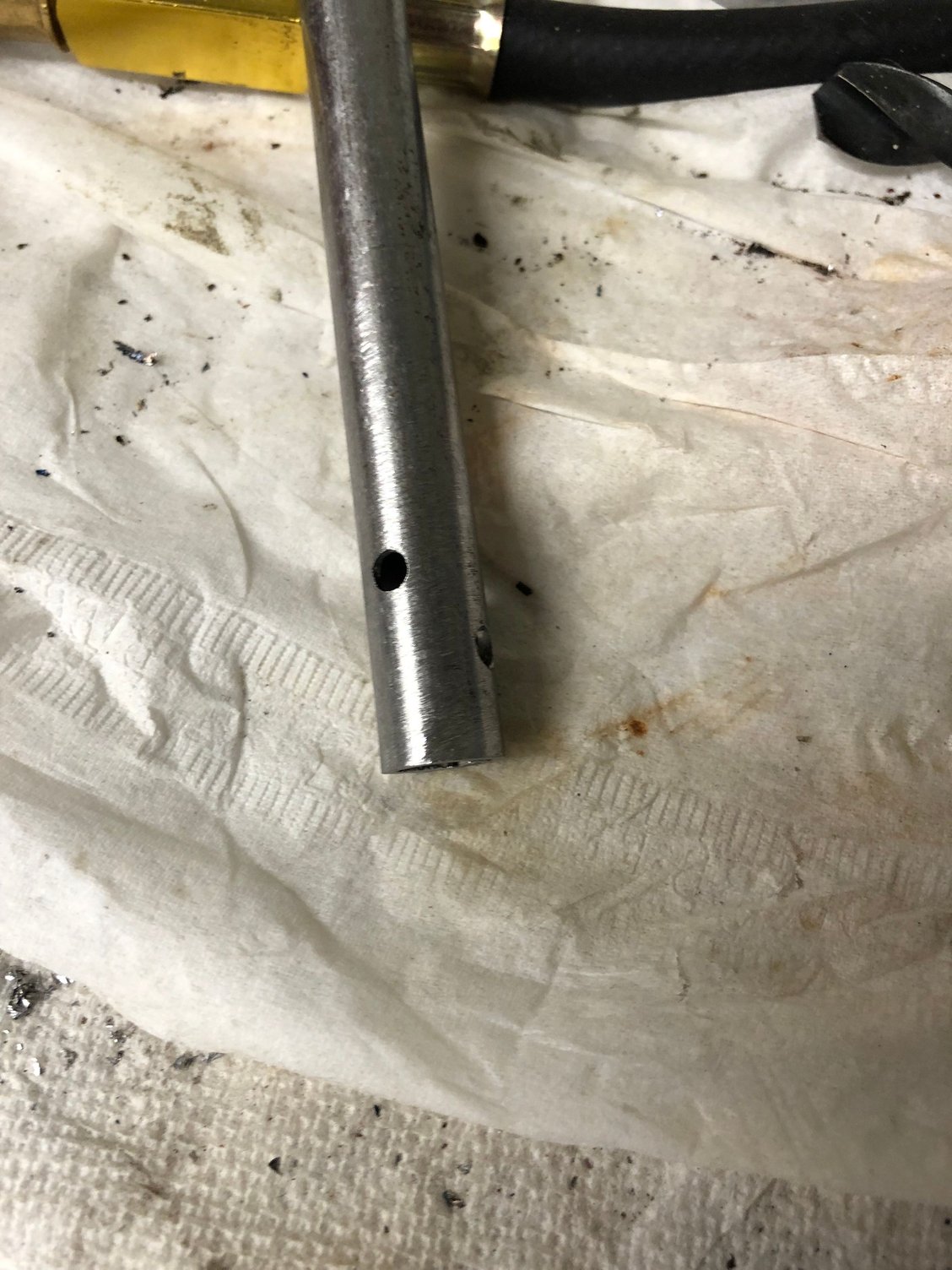

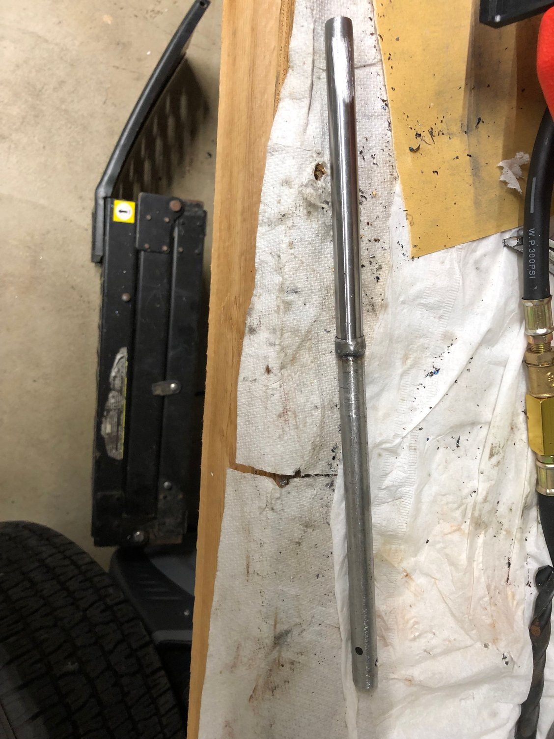

I’ve had bigger priorities but finally got back to my stuck fuel pump rod. I decided to fit a piece of pipe and JB weld it into place. Both ends were cleaned well and the pipe has a few holes to attach a slide hammer if needed. The rod is stuck fairly well so I give this about a fifty fifty shot!

Is that second pic showing success or is that a test fit piece?

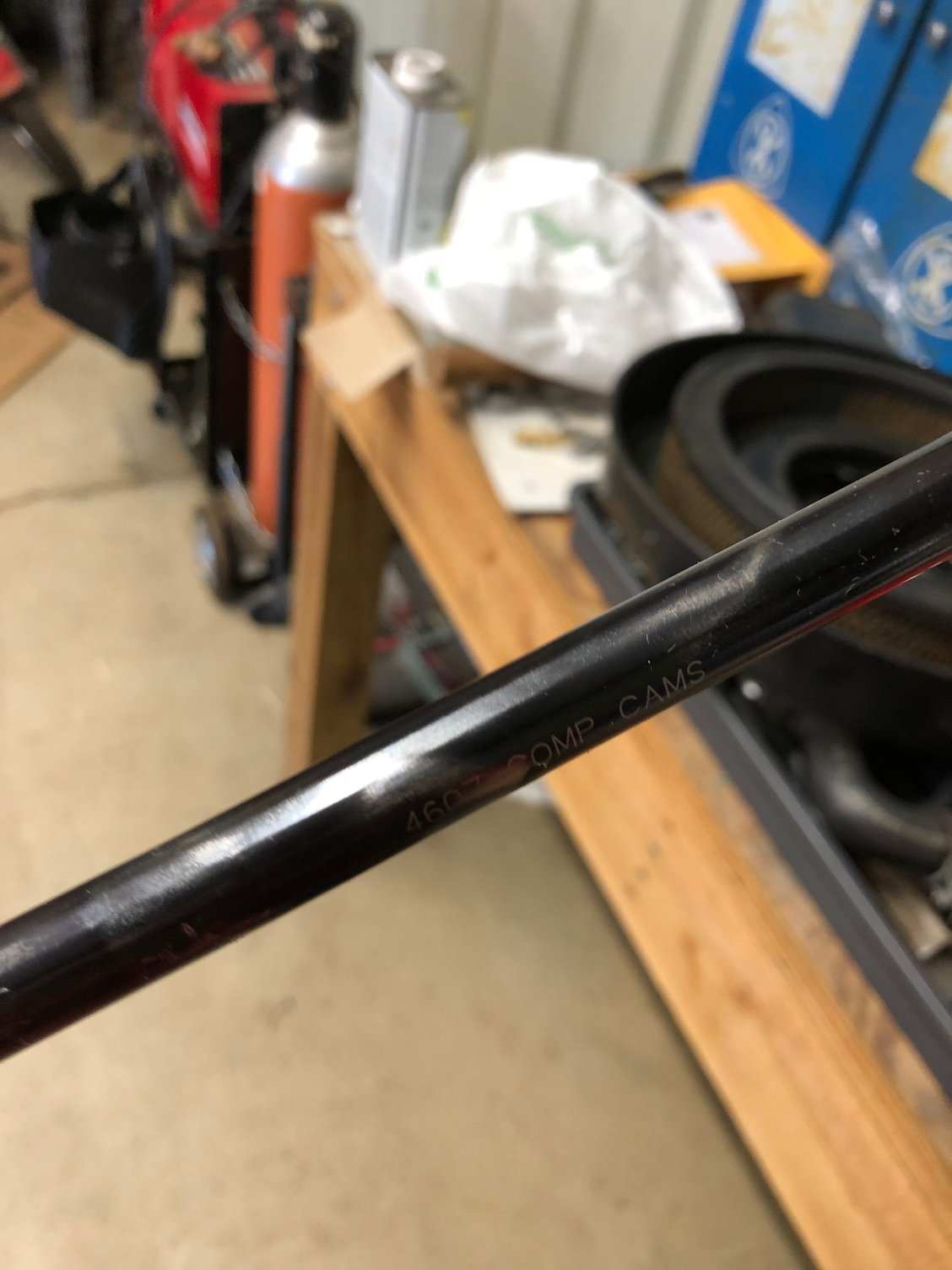

I wasn’t very clear, I bought a cheap fuel pump rod for fitment. No, the rod isn’t out yet. The engine was built by a reputable builder , the reason I requested a few dyno runs wasn’t for tuning but to verify everything before installation. When I went back thru my pictures and video I seen that the builder used an electric fuel pump for the dyno test. Lesson learned!
if I have success getting this out I’ll call Comp Cams and get their input for the correct rod. I’ve seen several post concerning mechanical fuel pumps that have different “arm” geometry causing bent pump rods. It seems impossible to bend rods that are almost fully supported but it happens.
Concerning why this rod was not coming out? I don’t know, I’m thinking it has been sticking for a while. The new engine only has a few miles on it, making great but inconsistent power. I thought (and more experienced owners here), that it was a bad fuel pump from setting so much. I hooked up a fuel pump gauge and noticed low pressure. When I removed the suspect pump it looked like new, I now think it was the pump rod sticking.
KC

Likes: 82

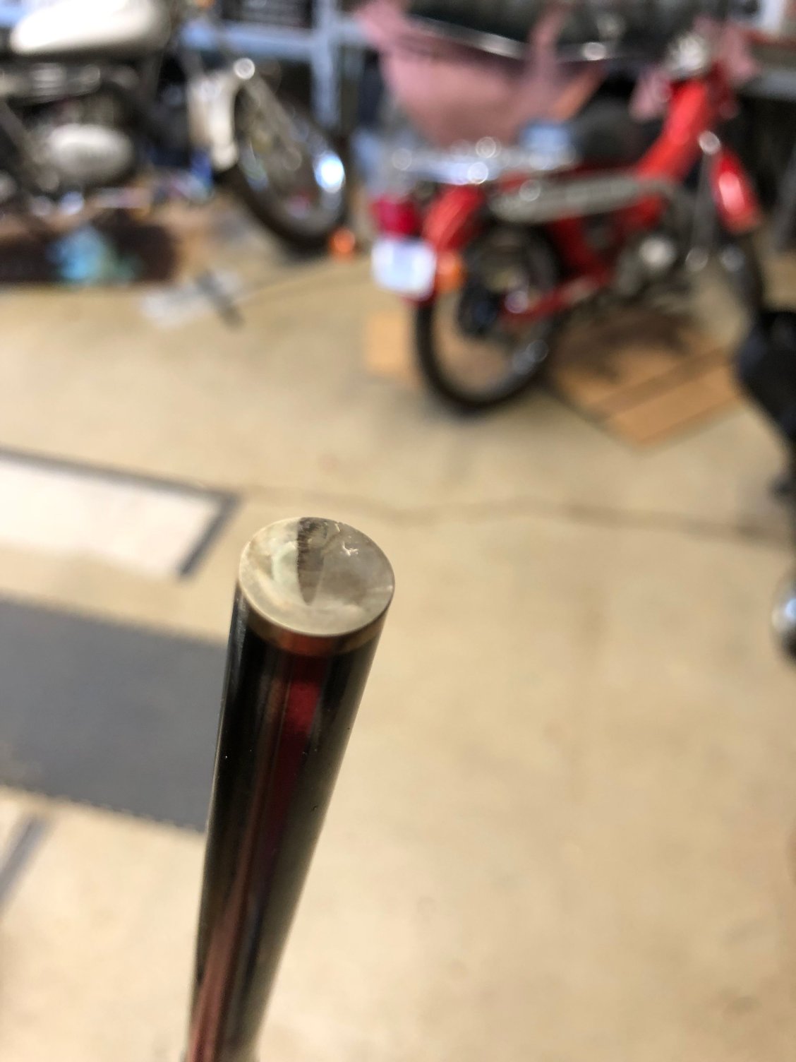

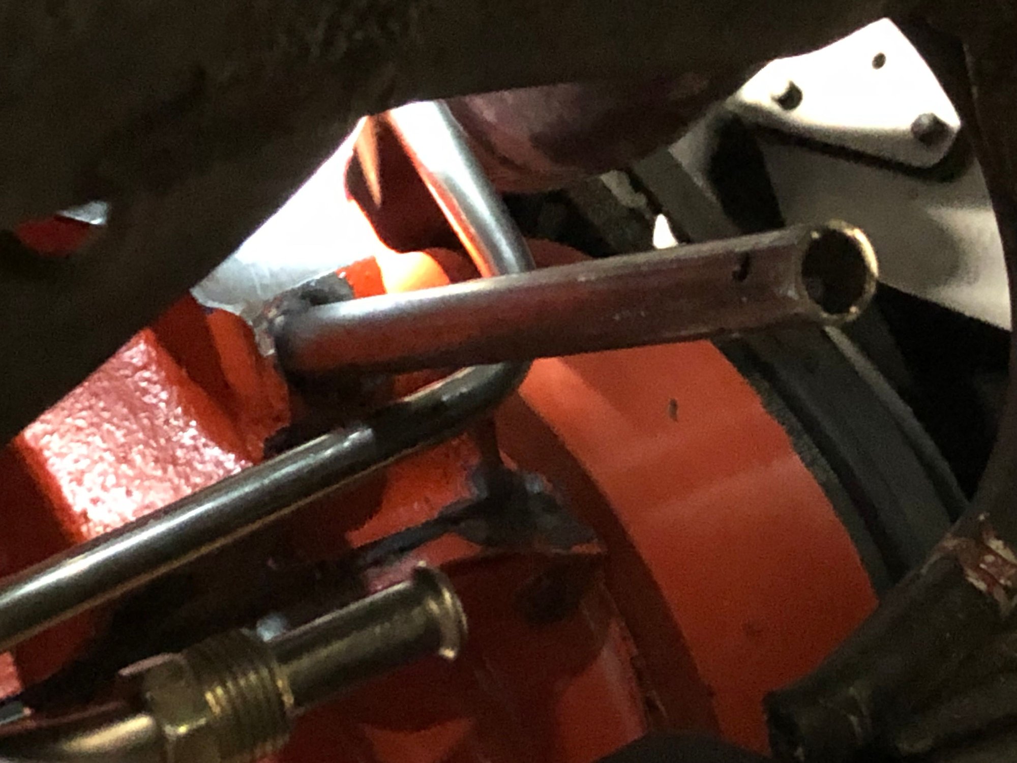

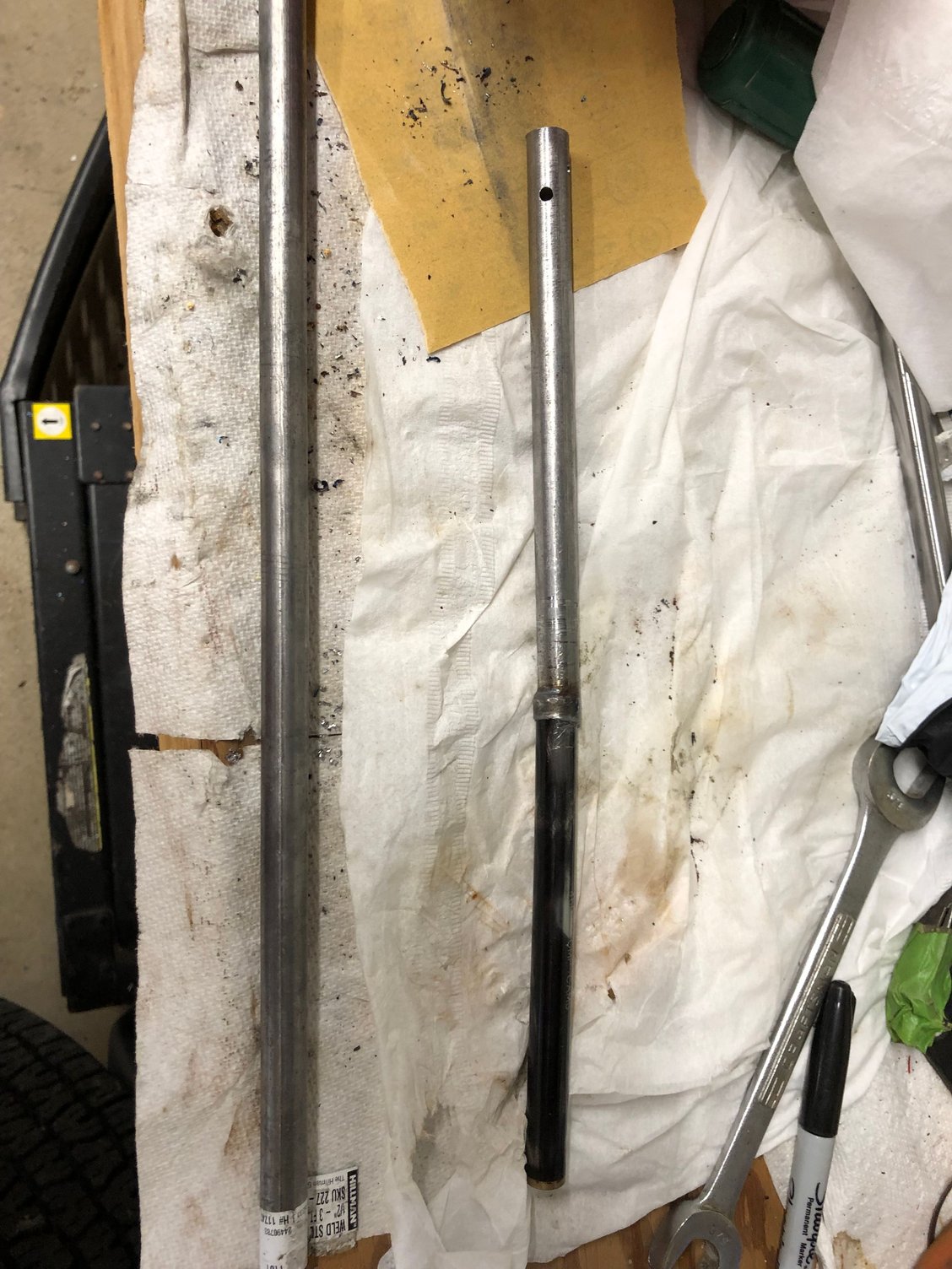

SUCCESS!! I got my stuck fuel pump rod out this morning. I’m not still 100% sure why it was stuck but you can see some wear on the sides. I think the scratches are from me trying to get this out with tools. The bronze tip doesn’t appear to be mushroomed but does have a fair amount of wear on the flat portion relative to the low engine hours (<25).
i welcome input but my plan is to call Comp Cams to verify this is the correct part for my cam. I’ll probably remove this around 5000 miles to make sure it’s not mushrooming or galling. If I have to I’ll replace every 10,000 miles as I don’t put many miles on this rig.
KC

Have you checked for a bend by rolling it on a flat surface (like plate glass or cast iron tool top)?
For those more familiar with these things, is the pump rod supposed to rotate like lifters? This rod appears to have the cam mark in only one orientation.

Curious to know what the rod does when rolled across a glass table.....

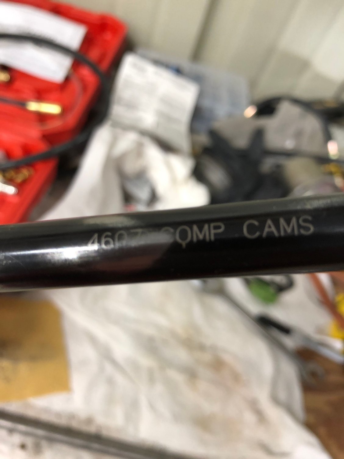

All good questions, I’ll check the end for mushrooming by measuring although it doesn’t appear with the eye. Same for the straightness. To respond to another question, yes, I am concerned about going thru all of this and having the same issue again! It’s kind of frustrating to have a very original Vette and not be able to have it function as Chevrolet designed it.
I was a bit concerned about the wear pattern on the soft tip with so few miles, this part from Comp Cams has been superseded by a new part number.
KC

Unfortunately I have heard mostly bad about trying to use those in a street engine. Just too much wear too fast.
Try the Howard's polymer (Nascar) rod

The 4607 push rod has been “superseded” by 4610 which is a different design. It looks like the bronze end has Ben replaced by a coated end. We will see how this plays out, hopefully this doesn’t wipe the cam lobe. I’ll take this out after 5000 miles and take a peek at it.
KC

Just a thought and dont remember if this was mentioned. These are made by humans and sometime we do miss stuff.
How does the OD compare to a known new/good used one?
Chance that just a few thousands to big causing a bind.
