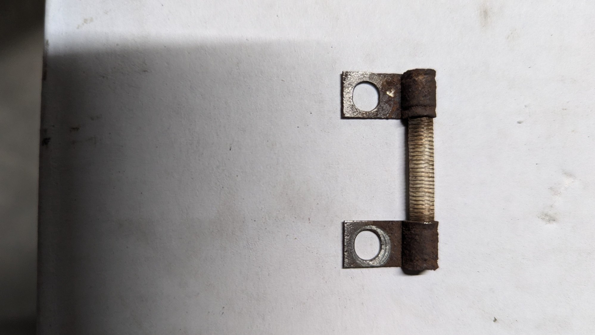

After the resistor starts the charge the diode trio takes over. A failed resistor might indicate a bad diode trio or a short somewhere. If you cant find what you need PM me and I will send you what you need. Here is a picture of a used resistor tested 46 ohms.
