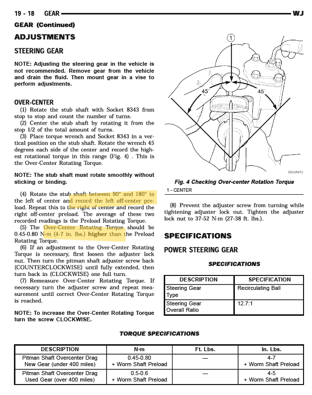

Both shafts in the above two designs, each have their own pre-load adjustment. Both must have zero play and "drag" in the low inch lb range to have no slop at the wheel. The adjustment procedure is attached. Most people know where to find the one top mounted adjustment screw, but the second one is what causes major amounts of slop. Both need to be correct, and adjusted on the bench.
The Borgeson box "conversion" for our C3s, is a much newer style Delphi 600 box. It has completely newer style internals. The power piston is controlled by a rack-n-pinion style gear, which was originally developed for this box. That control gear was later used in rack-n-pinion steering gears, so it is the same part design, and is much improved over the older Saginaw box. It also uses multiple needle bearings inside on the main shafts, for less internal slop, and has no thrust washer, or second pre-load adjustment. There is only the top "over-centering" adjustment.
The Delphi 600 "Borgeson" box for our cars was built for a Jeep. It has the long pitman shaft our cars require. They weld a bracket on to make ita bolt-on to our cars. It is not a brand new box, it is a rebuilt box. The feel is controlled by the lightweight torsion bar inside. Around 28-30 in-lbs. This is about the steering wheel "heft" or weight of a stock C3 power steering system. However the steering ratio increases from 16:1 to 12.7:1 setup. So it will tend to feel more sensitive.
I strongly recommend using the Manual Steering or outer holes on the C3 steering arms. The overall quickness of the steering will still be faster than even a OEM C3 PS steering setup.
Warning: If you use the inner or PS steering arm holes, you may find the steering entirely too fast for comfort. At that point it will be faster than a C7 or C8 or a Viper, and most any other car on the planet. With the light feedback/feel the entire steering effect often feels uncomfortable to the driver. Especially if you have low caster settings of 1-2*.
Add as much caster as you can in your alignment. Strive for at least 4*, or even more. It really helps with a Borgeson setup especially, even more than a OEM PS car, due to the faster gear ratio inside. If you have added as much caster as you can get, even with new upper a-arms, and 6* caster, and are using the MS holes, and you still feel it is too light and too twitchy for your tastes, that is when I would mail it off to Turn One for a re-valve.
Attached are the two overhaul manual sections that describe how to adjust the lash or pre-load in each style box.
Two Gearbox pre-load adjustments for C3 manual box or early Saginaw PS box
Single pre-load adjustment on Borgeson Delphi 600 box
