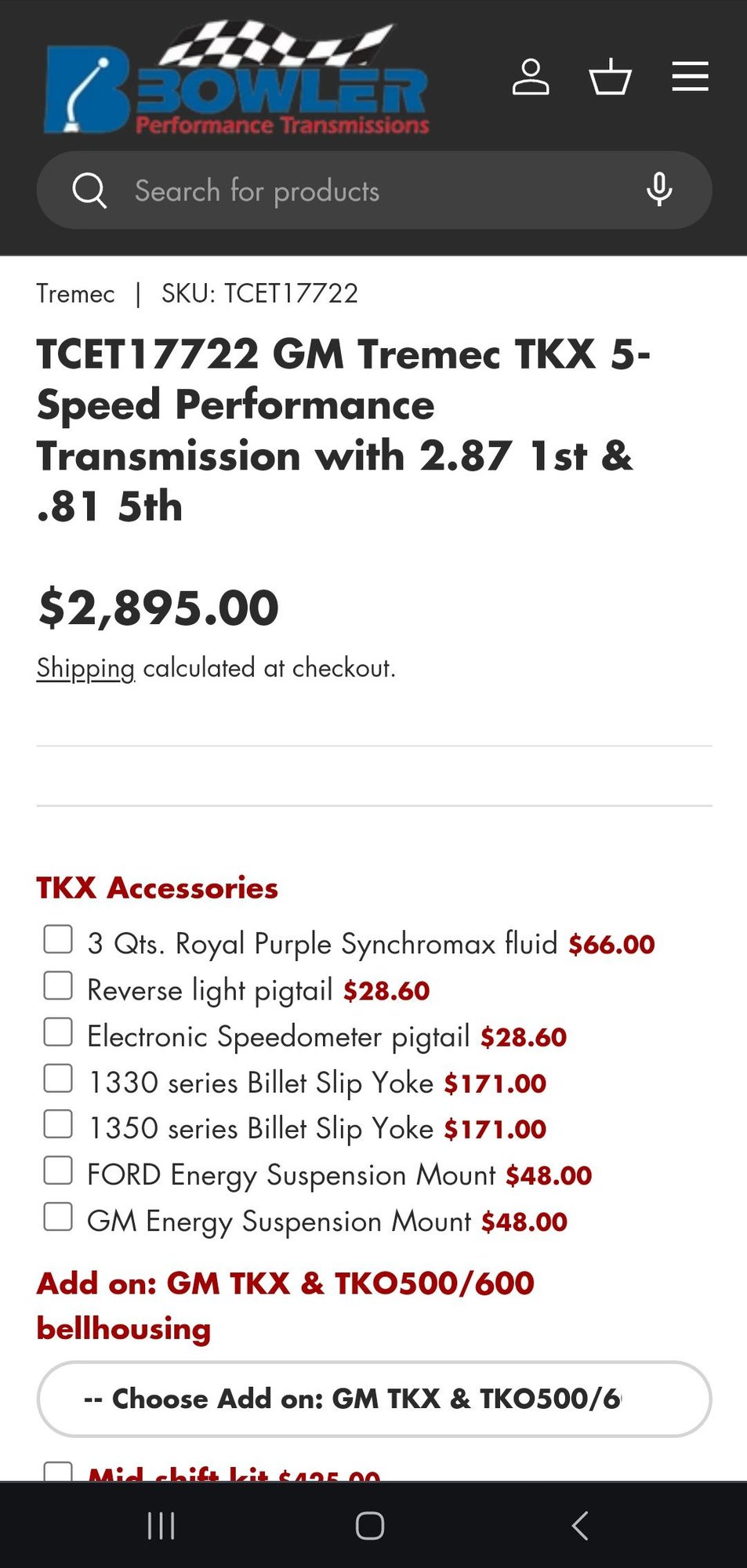

Thanks for your reply. I poked around on tremec's site which led me to a shop's website that is decently close to me that supplies these transmissions. A few questions/ comments about my options. It does give the option for a 1330 slip yoke. Will I need a mid shift kit? Also for the bellhousing, it gives the option for aluminum vs quicktime steel with steel costing more than twice as much as aluminum. Is the steel worth the price difference? Would I be a fool for going for the aluminum?

The steel housings are usually rated for racing, draracing and high horsepower. How much horsepower is you max desired?
You need the offset mid shifter to fit the corvette shift consoles. The link on ebay is a perfect choice. Very easy swap.
You need a split yoke. One that you can unbolt the straps to remove the driveshaft from the yoke. You need them at both ends for a c3 corvette, one on the differential which is stock and you have, and the split slip yoke in front. No one makes a spilt 1330 that we have seen.
No you are not a fool for using aluminum bellhousings if you drive like a normal responsible adult...I on the other hand have a steel bellhousing.
And you will need to research how to zero your bellhousing so the transmission is centered on you crankshaft. It's not hard but you will need a few tools like a magnetic base and a dial micrometer
