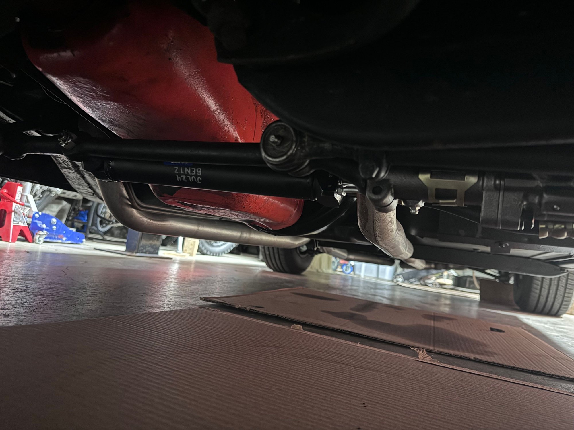

I took the car out for a ride today to check the power steering system for function and/or leaks. Everything worked fine and I haven't seen any evidence of leaks as of yet. I'll check again in the morning as I left some pristine cardboard under the car.
Here's a strange observation though. The steering wheel is no longer aligned when going forward in a straight line. It was perfect prior to replacing the power steering valve and the cylinder. I assumed it would remain the same with the simple replacement of the parts, but it seems that I've changed the relationship between the Pitman arm and the steering relay rod. Maybe the new PS valve body isn't an exact duplicate of the one I replaced. 🤔

Nahhh, nothing to worry about. It's in the way that control valve is threaded and screwed onto the draglink. Adjust the tie rods to recenter the wheel. Keeping your steering box on high center.
And I like to keep clean cardboard under mine as well. Just good to A. Keep an eye on everything. And B. Keep the concrete clean.
