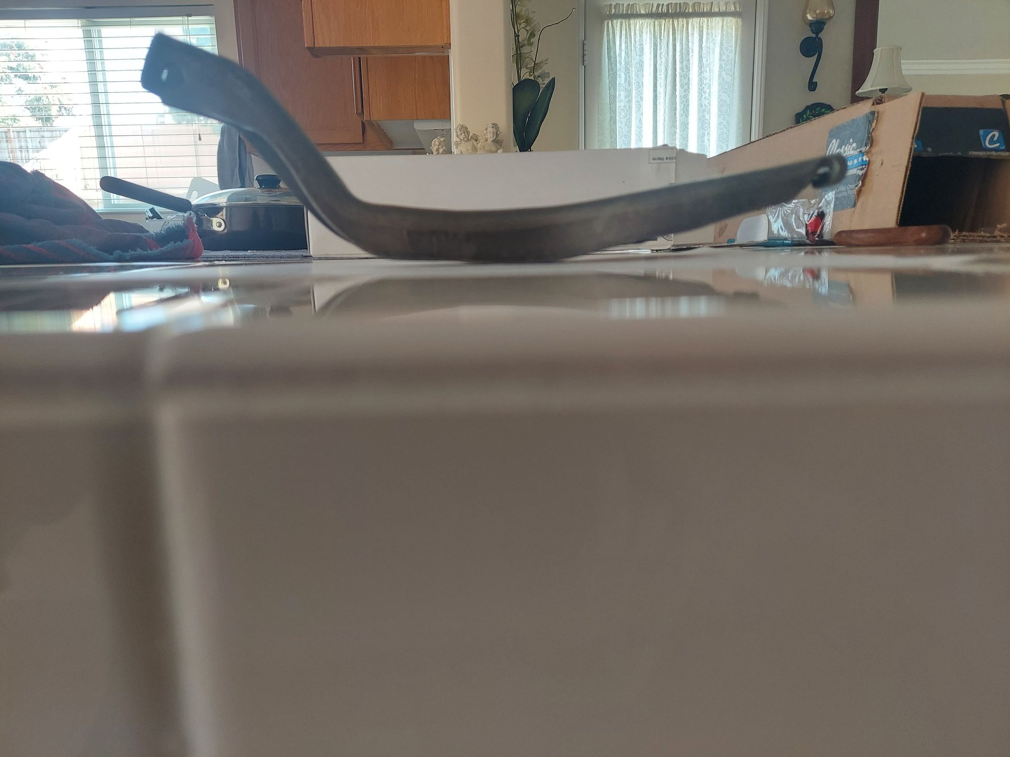

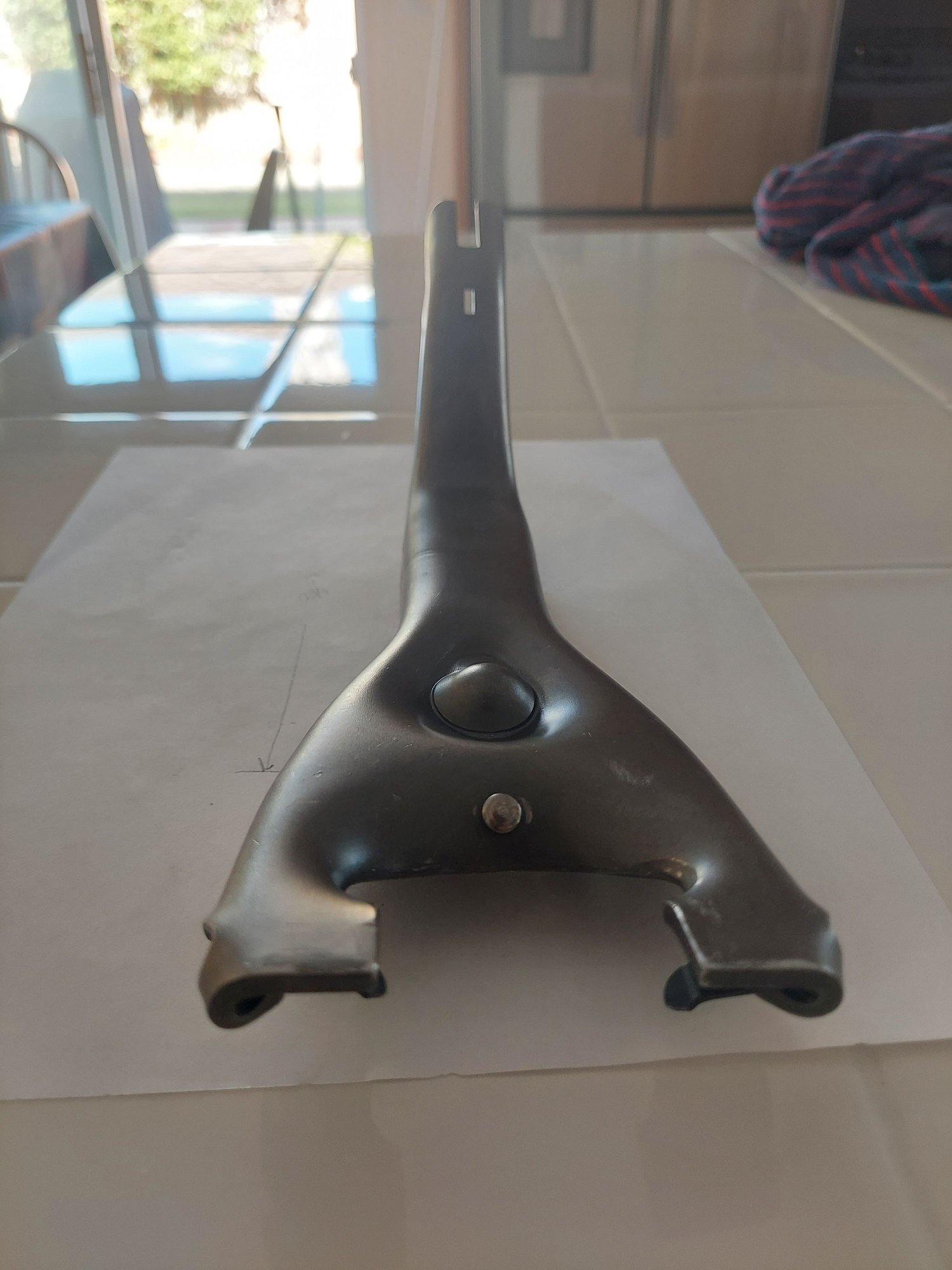

Originally Posted by J-Vette1
Dusky - Let me know if you still need further dimensions. I am supposed to have a new fork arriving in the mail for the auto - manual conversion that I'm doing on my '72.
Hi, yes actually. I'm installing the bellhousing tomorrow so if you could measure it, that'd be great!
My plan B was using threaded rod with the same swivel as on the pedal to Z bar rod.
plan C was some guesswork based of internet pictures 🙈
Old Aug 13, 2024 | 05:36 PM
J-Vette1's Avatar
J-Vette1
Posts: 72
Likes: 7
Default Best estimate on height..3.75
Old Aug 13, 2024 | 05:48 PM
J-Vette1's Avatar
J-Vette1
Posts: 72
Likes: 7
Sorry, I originally didn't see any reply, so may be too late. There is an optical illusion, but center of pivot ball to center of clevis pin hole estimate is 6 5/8. The height is trickier because it does not sit flat. Estimate to a "neutral location" where the fork would just be contacting the t.o. bearing: 3.
75 iinch. I sat it on a flat surface, and pushed down until the contact area looked about neutral, but this is merely a midway guess. It can range taller or shorter. As tight as these guys are....I recommend getting one from a supplier.
