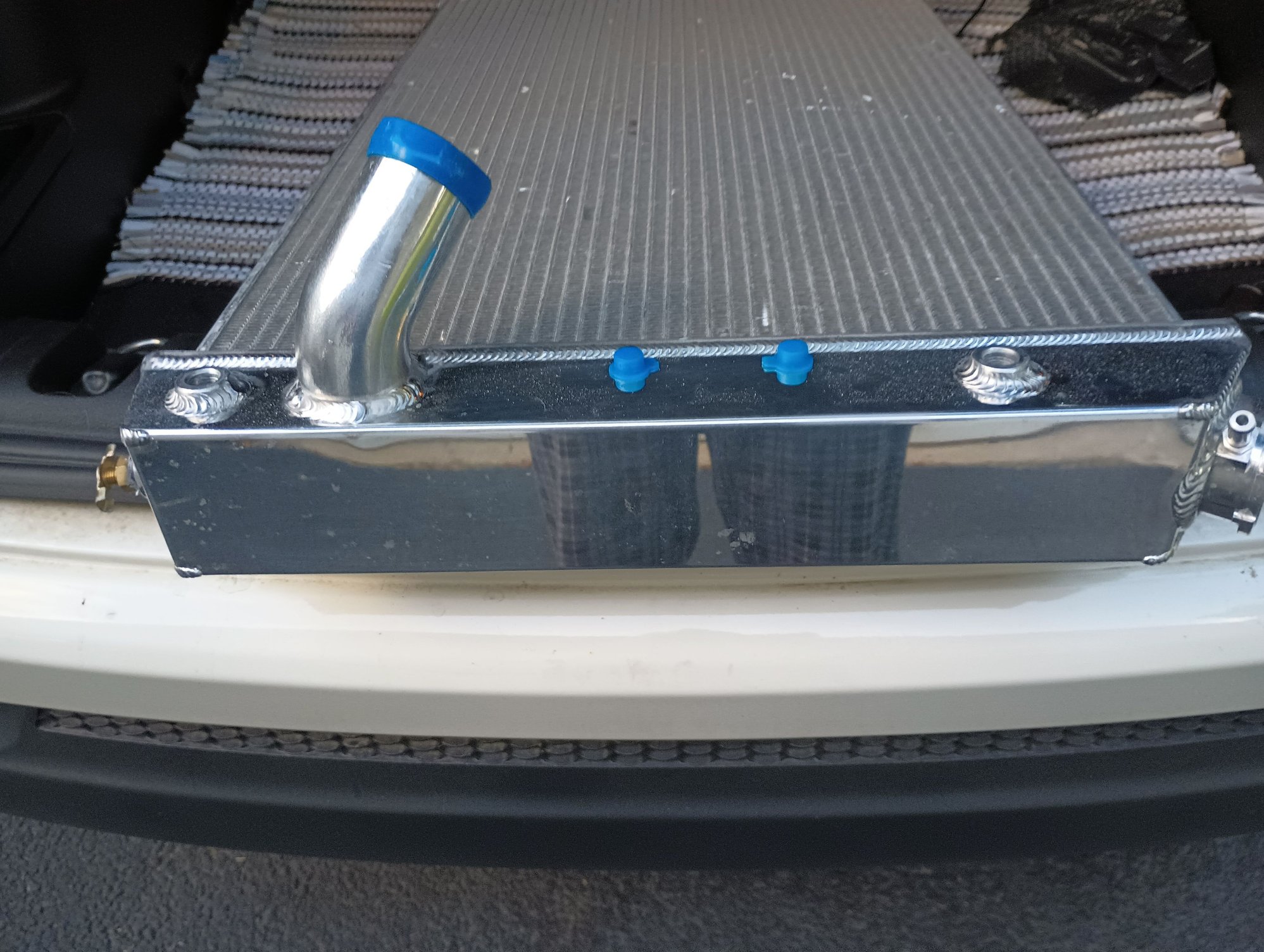

I have a 77’ with an L-82. And I’m looking into a new aluminum radiator from
Cold Case. I was reading on other forums and different websites that there was a problem with the radiator hoses. They are saying that the inlet and outlet necks on the radiators are a different diameter than the hoses. Has anybody experienced anything like this with the hoses not fitting.

I have a Coldcase radiator in my 74 L48. It fit really well and no issues with hose sizes. My only complaint is the drain pepcock is too close to the rad mount

1976 was a split year with some cars using the 73-76 radiator and some using the 77-79. The inlet sizes were different between the two different radiators used in 76, so I could see how this could be a issue on a 76, but all 77's used the same radiator and hoses.
