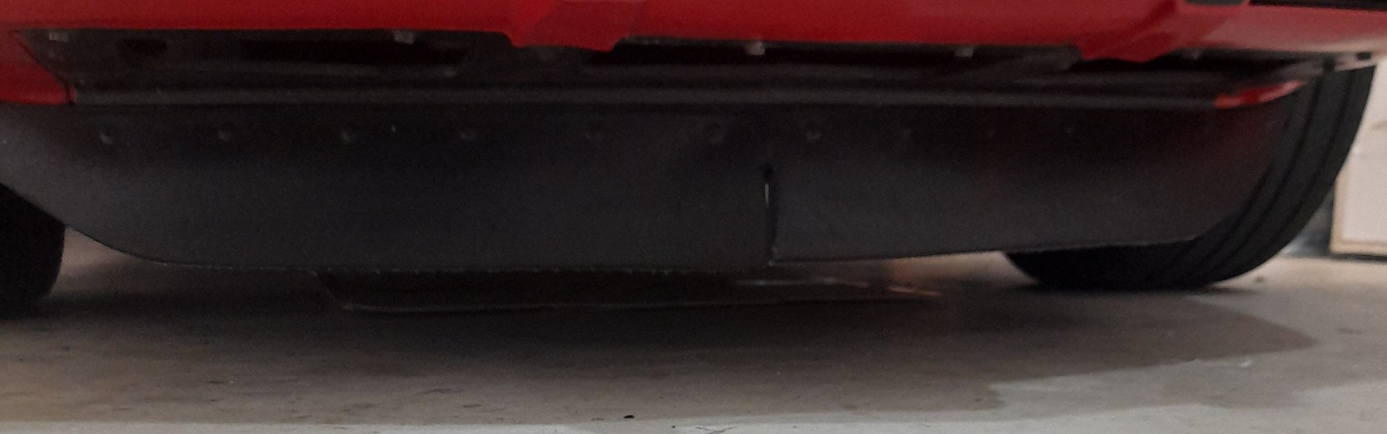

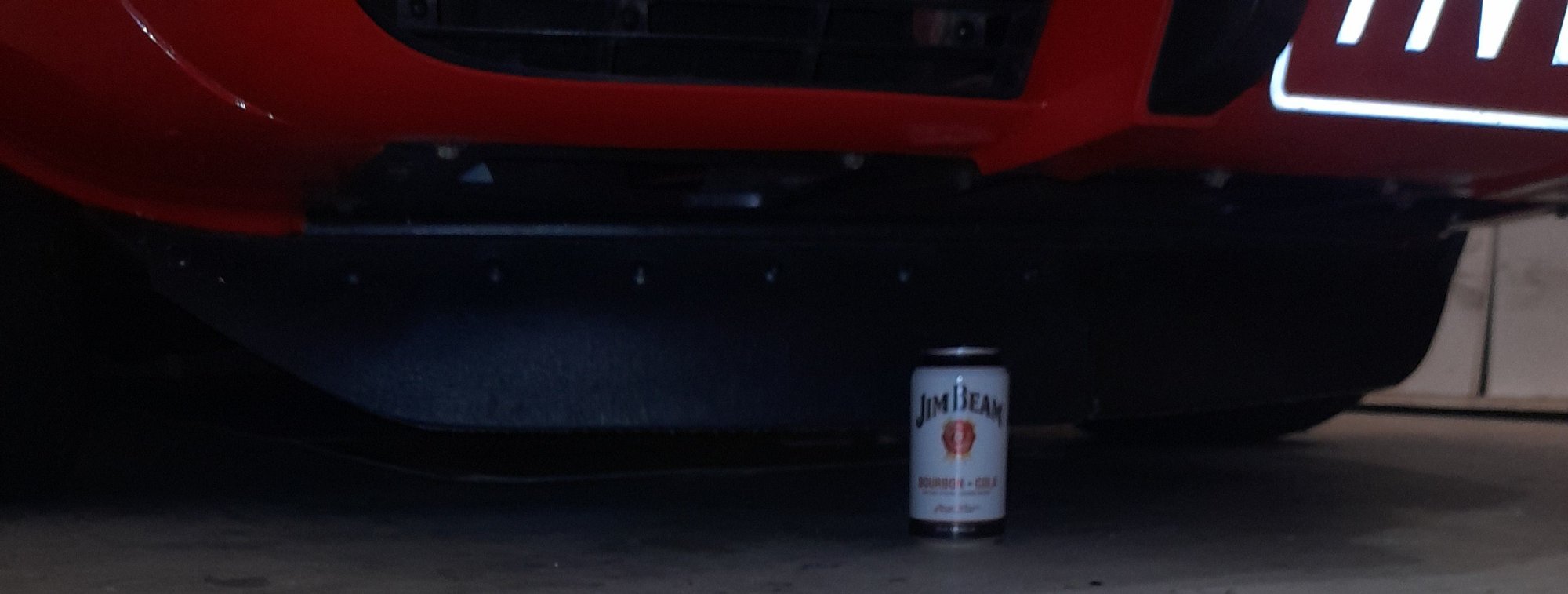

Air flow on the highway.
77 - 79 front spoiler extension part of Heavy duty cooling option in those years. It's made out of conveyor belt kinda reinforced rubber. These really do help scoop some air through the radiator. Although getting hard to find nowadays. If you google it I have found a couple out there.
A couple pictures of my car in the garage just now. Hard to get a good picture under there. But here ya go.
I don't think the original retainers are available at all anymore. I've added extra rivets to mine over the years anyway due to abuse. Might not be super pretty but doesn't break on every driveway and speed bump. And it does really help.

Mines a 77 to be clear. And the heavy duty cooling option probably wasn't all that popular in these years. I really don't know for certain. I do know it really helps pull in air on the highway.
And it doesn't break left, right and center!
And it fits right on your car!
(OK you will need to drill holes, come up with rivets and reinforcement plates).

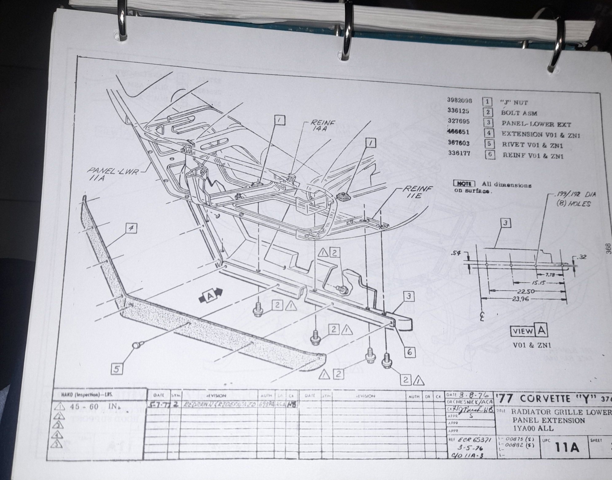

I know I suck at photos, so, from the 77 AIM.
As you can see, a factory option. It bolts right onto your 77.
Thank you! I've seen home made ones that look ok but I'd be thrilled to find on of these
