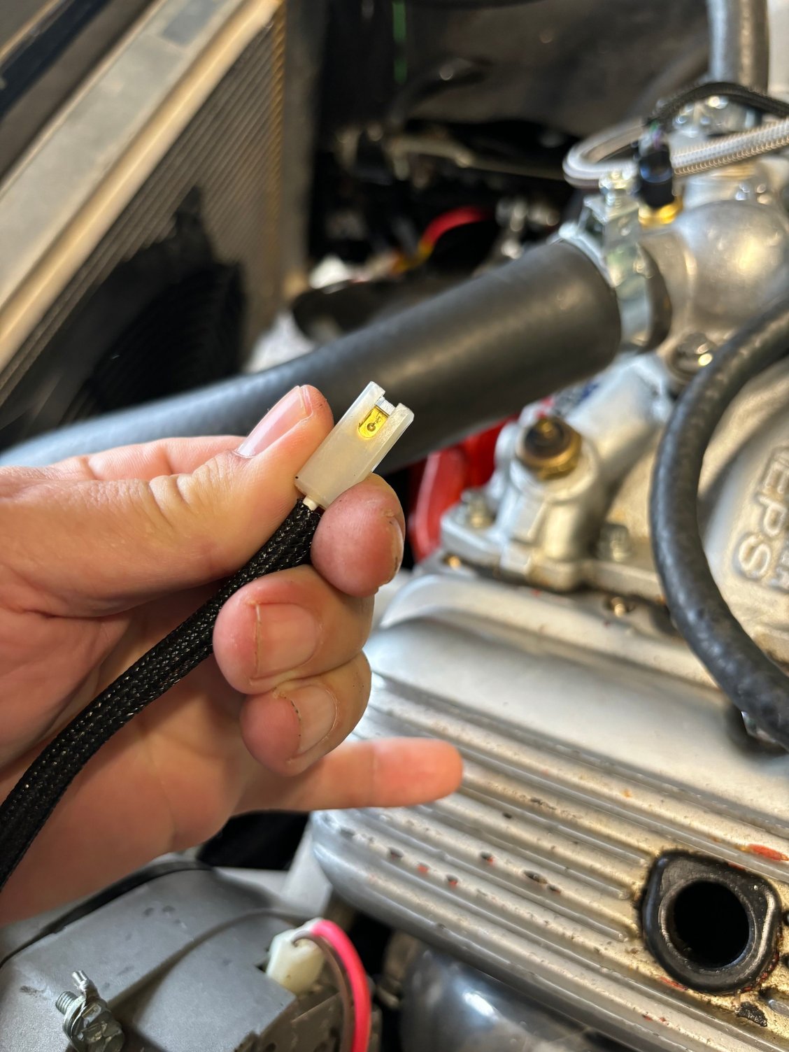

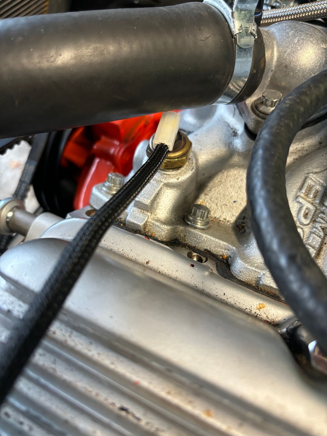

What do you gents use on this so that it doesn’t come loose ?

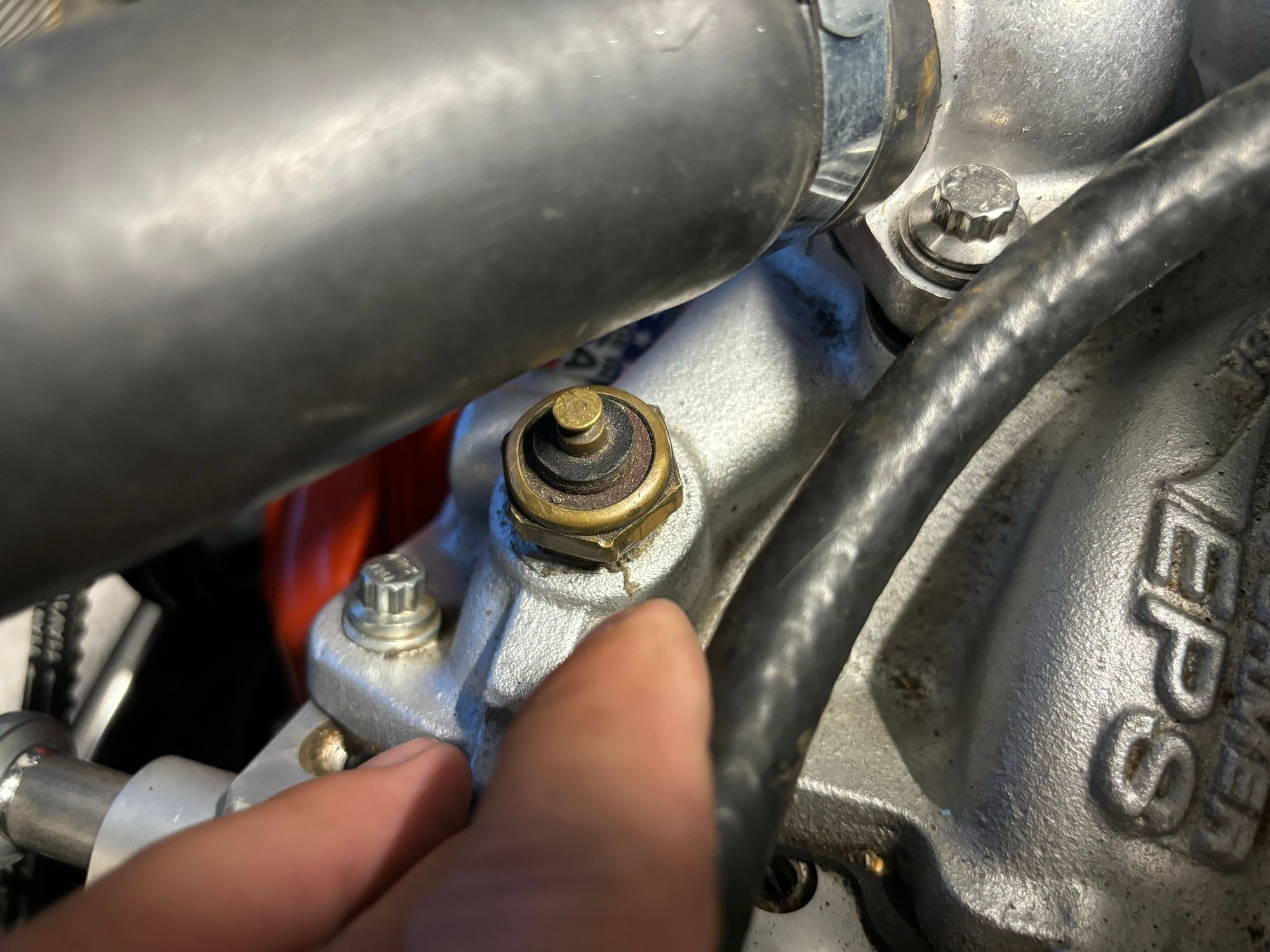

We were just discussing that temperature sender.
One possible replacement comes with the connector. Link to AC Delco G1852 (at Amazon).
I'm not sure what that connector is called, though.

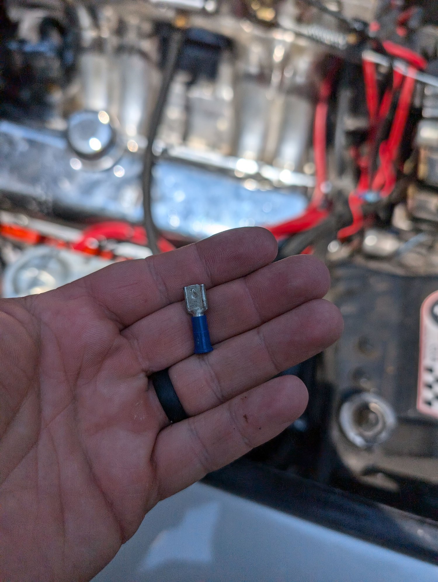

I just use a female disconnect and use the plastic cover that comes with the new temp unit, at least they do at napa or O'Reilly's anyway.

Thanks gents. This is all super helpful

Muuuuuch better. Thanks, gents.
