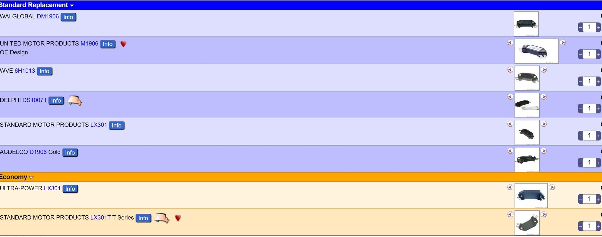

D1906 is the 4 pin GM HEI module.
Lots of other choices
