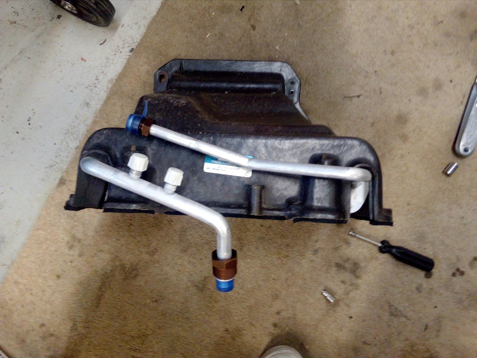

Old Aug 5, 2024 | 03:42 PM
ukjohn's Avatar
ukjohn
Joined: Oct 2018
Posts: 457
Likes: 132
From: England
These pictures from when I took the evaporator out on my 78 might help. I had to remove the coolant expansion tank to get the evaporator box out.
