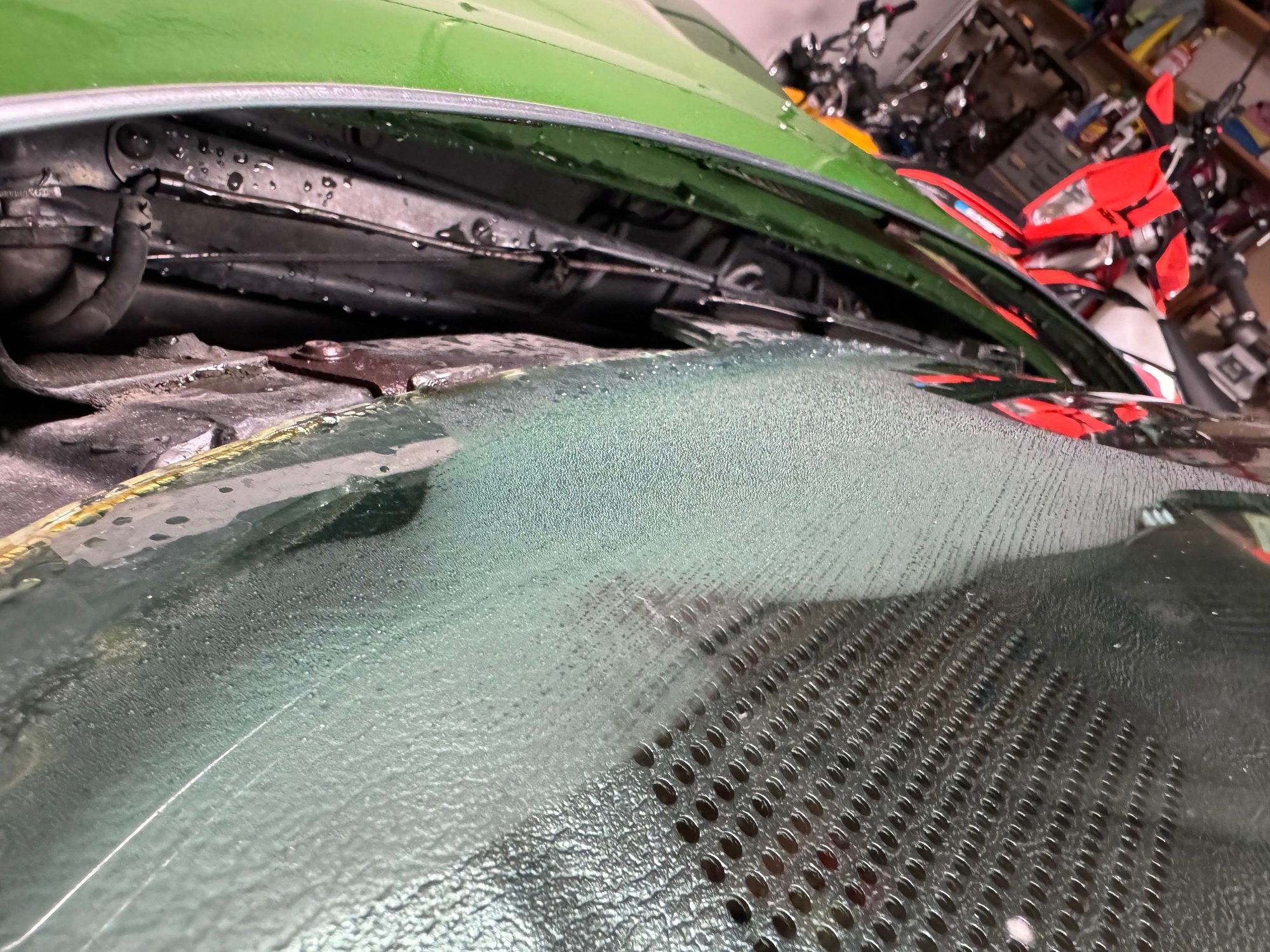

Since buying my ‘72, people love to talk to me about how awesome it must be to own and drive a classic. I’ve taken to telling people that you buy a 50 year old car because you enjoy working on cars - not because you enjoy driving cars. If you enjoy driving, buy a modern one. After my first week of ownership, my power steering sprung a leak and I replaced everything besides the pump. I’ve driven it about 30 miles since then and today, during the first rain of my ownership, I came to realize that my windshield wipers do not function and my convertible top leaks like a wire strainer. 🤣
Now I have fresh new topics to search on the forum and I can share my experiences with the next guy.

Oh I see your problem. You drove it in the rain.
And yes you are correct. If you don't like working on old cars. C3 Corvette's are not necessarily for you.
I've grown old with mine. I don't really find people asking me anything about owning an old car. Except maybe at car shows.
Best of luck with current issues. I'm no expert on those earlier wipers and I certainly have no idea how to get the top to stop leaking. I've tried everything. Best method seems to be to avoid rain.

There is a large round black **** in line and below with your steering column. The **** maybe missing if it is use a wrench or pliers and rotate the shaft. This is a windshield wiper electric shut off switch so changing your wiper blade is easier.

Oh ****! I know exactly what **** you’re describing! I forgot all about that! I’m going to feel like such a fool if that is the solution! Thanks for the recommendation!

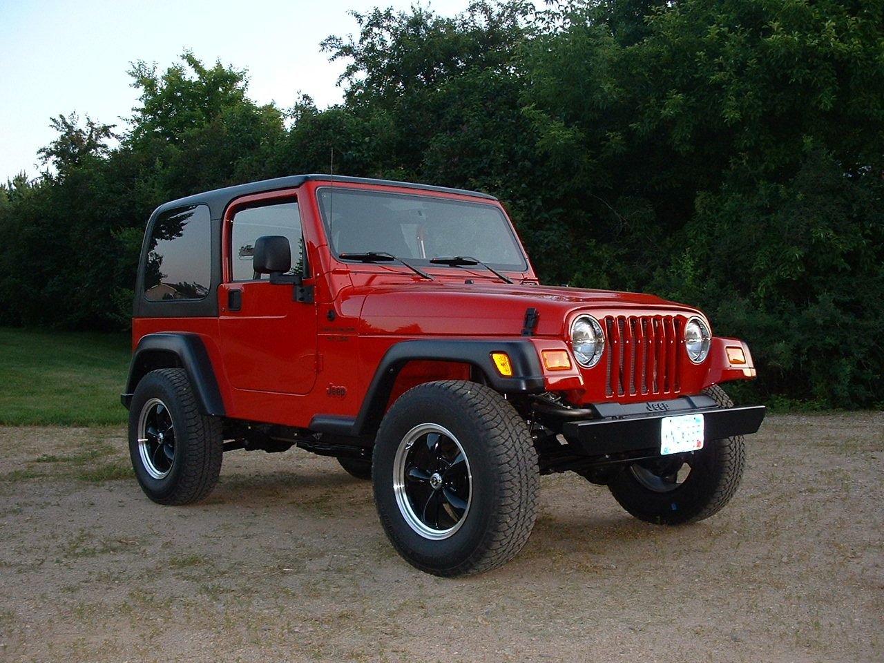

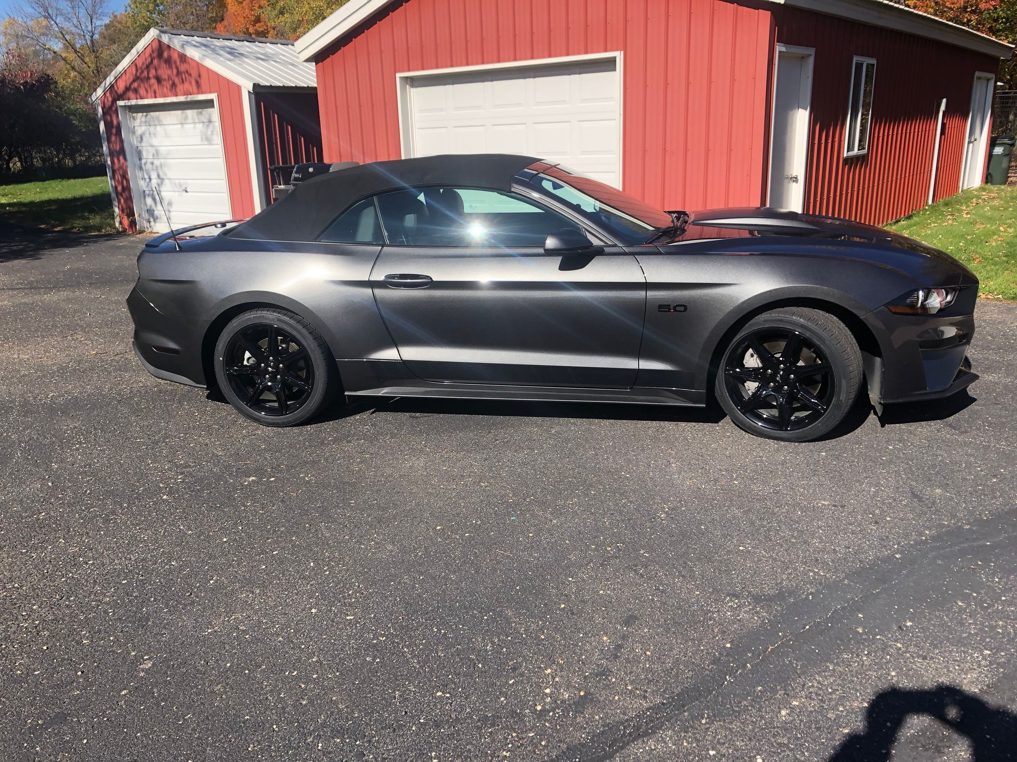

I to am a lucky guy my wife is totally fine with my hot rod projects. I like the build. Always have. Current hot rods are a 80 Camaro with a LS3/4L60E swap. It was a 28K original paint hit car. Zero rust. It's our short distance hot rod.
We have a 20 Mustang GT vert. Sweet car. It's our long distance hot rod.
My summer time mall crawler and winter time snow plow vehicle is a 98 Wrangler with LS6/4L60E swap.
Nothing better than spending the late afternoon and evenings building a new hot rod.
A few pics.

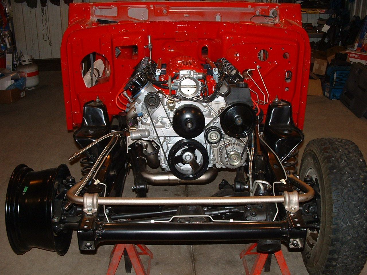

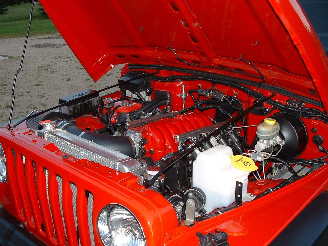

I done a couple of LS swapped TJ Wranglers. The one in the pic has a 2002 LS6/4L60E combo. 4:10 gears. Rubicon 241R transfer case. Explorer 8.8 rear end. Bought it as a theft recovery out of TX. Was a 4 cylinder 5 speed. So slow it was painful.
I started picking at at and then the body was off the frame. Powder coat the frame. Complete repaint.
Its been 15 years since the rebuild and swap. Its been bullet proof. Don't drive it in the winter except to move snow.
Couple more pics.

So I posted this thread on the same day that I was leaving for 2 weeks of vacation. I spent every day of the trip thinking about that little black **** and whether or not that could be my issue. I finally made it home at 3:00 AM this past Sunday after a marathon day of air travel with layovers and delays and all the typical crap. When we walked in the door, we dropped the bags and my wife and daughter went straight upstairs to go to bed. I, on the other hand, went straight to the garage, got into my car, and started it up. I turned on the windshield wipers and nothing happened. I reached under the steering column and turned the black **** - THEY IMMEDIATELY STARTED WORKING!
By this point, my wife and daughter are dressed for bed and standing in the garage, looking at me like I'm a lunatic - car running and windshield wipers flipping back and forth in a closed garage.
Thanks to PJO for the timely and helpful response to my technical/operator error issue.
