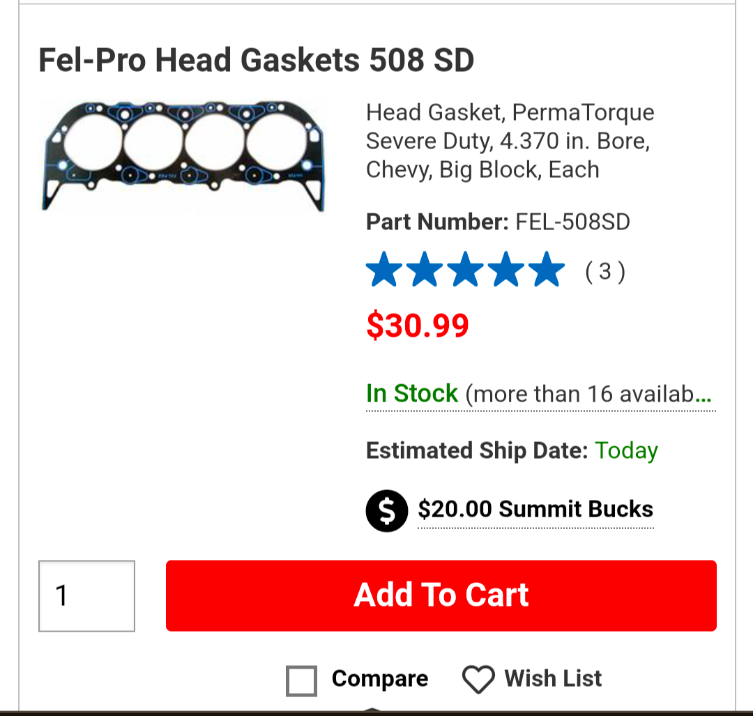

My motors .30 over. I think my bore is 4.28....Will these work? I know I should measure deck height too.
4.370 in bore .41 thickness
