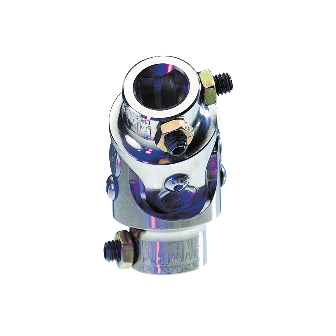

Is there any advantage to installing a Flaming River steering coupler instead of a traditional rag joint? What is the difference between the two in steering and handling?

The Flaming River coupler is a U-joint.

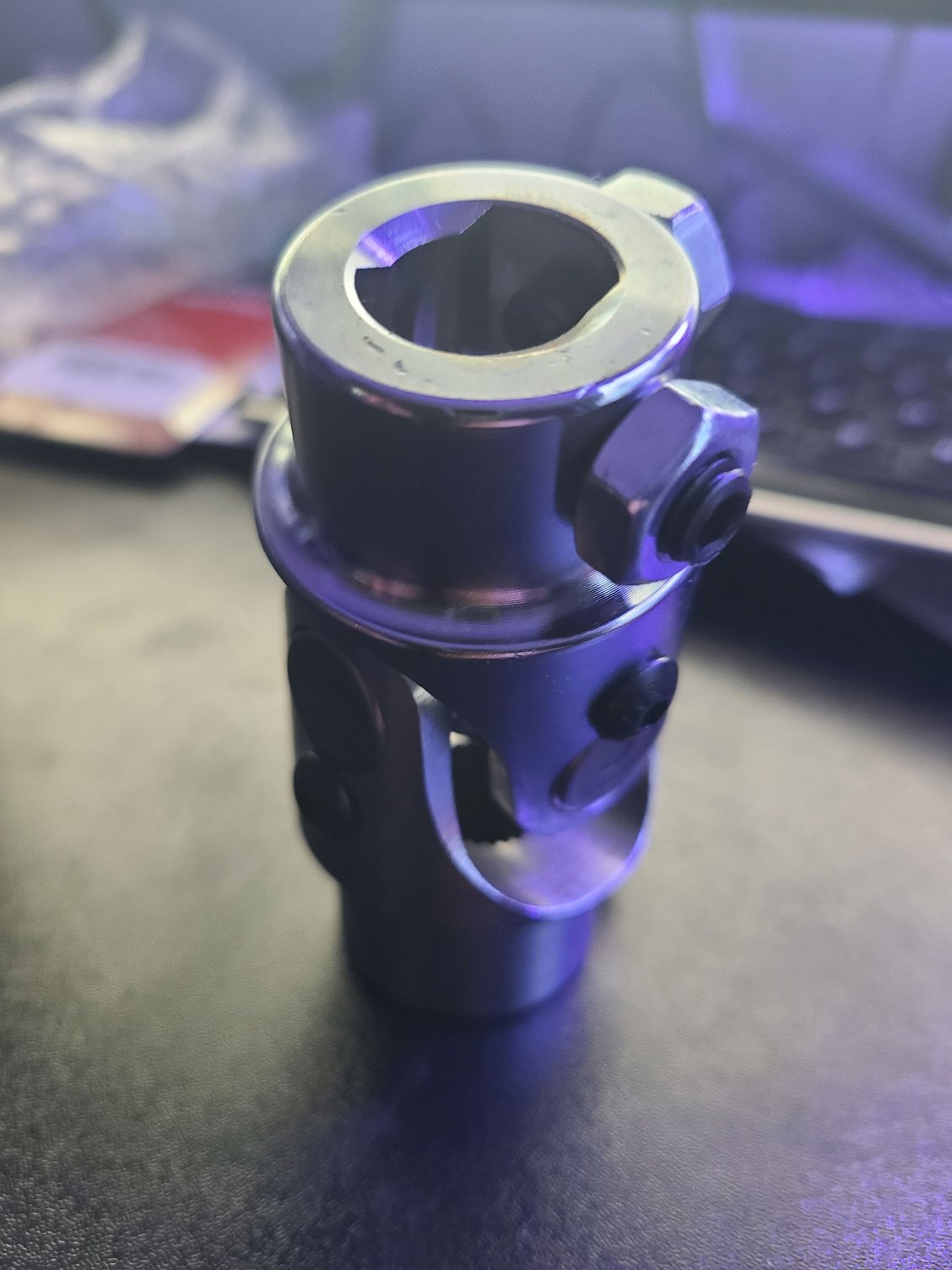

I was shocked at the cost difference between this brand of ujoint and all the generics on ebay for like $10-20... I bought a chrome plated generic off ebay and though it appears to be suprisingly well made, it had the wrong type of spline (I ordered the wrong one). This and the fact that others here advised me to stay with the rag joint convinced me to do so when I installed my borgeson kit.
I put an ebay poly rage joint in it a couple years ago I just pulled out when doing the borgeson conversion and the rag joint still looked new so I dont know how much of a real issue the new rag joints really are unless its a daily driver that sees a lot of use.

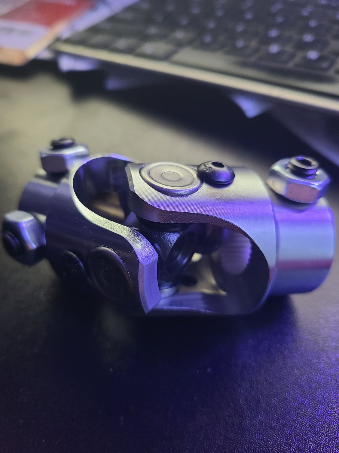

The flaming river joints have a higher angle of deflection before they start to bind, I believe it is 60 degrees vs 45 for the others...Useful for the rack and pinion conversions....and that makes them more expensive...

Other than the rather large cost difference the generics look to be a pretty close copy of the flaming River brand joints.. not sure how there would be a difference in the binding aspect.

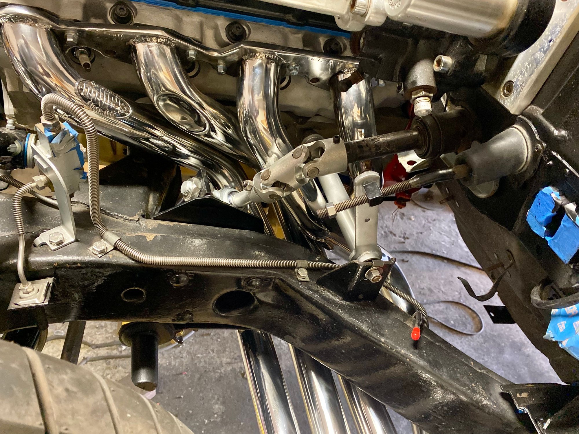

The U-joint gives a little bit of extra clearance if you're going to install headers. I removed my Saginaw PS steering system and installed a Steeroids rack and pinion system when I realized it would give me some extra room for my headers. This got the big Saginaw steering box out of the way and also the large diameter rag joint.
Caveat: I've read that the Steeroids rack and pinion system can interfere with some of the stock off-the-shelf headers. For my headers, it resulted in extra clearance. The dimple in the #3 exhaust runner is now not needed. It was put there to clear the factory steering box. The Steeroids U-joint can accommodate small motions between the body and frame. Notice if the steering column moves...say.....a 1/8 inch forward or so, the Steeroids U-jiont body just rotates a little bit counterclockwise to accommodate the motion.
