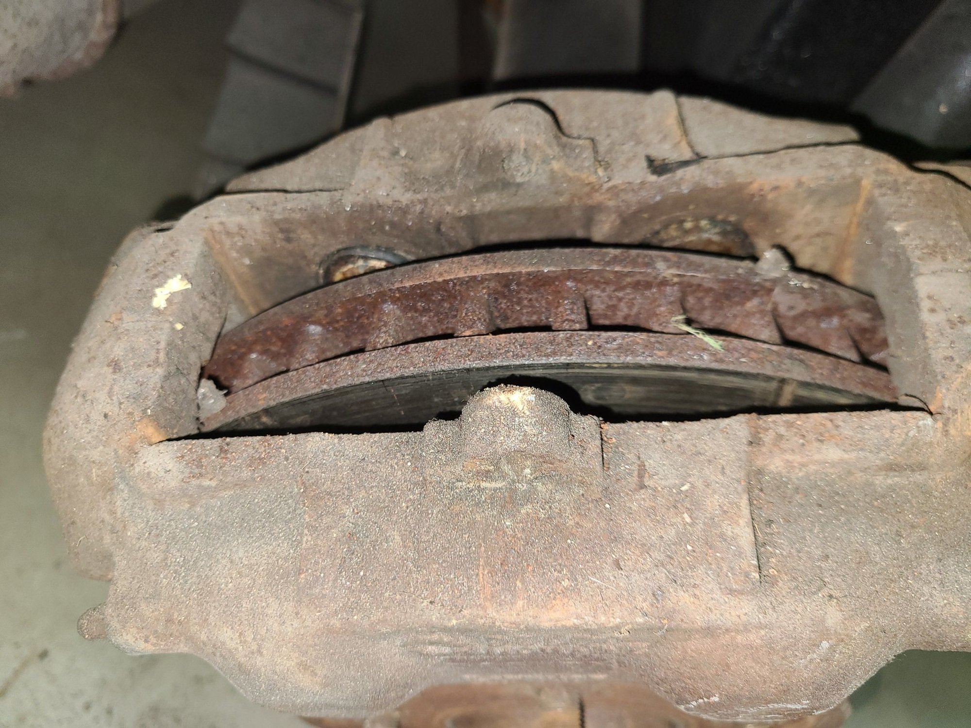

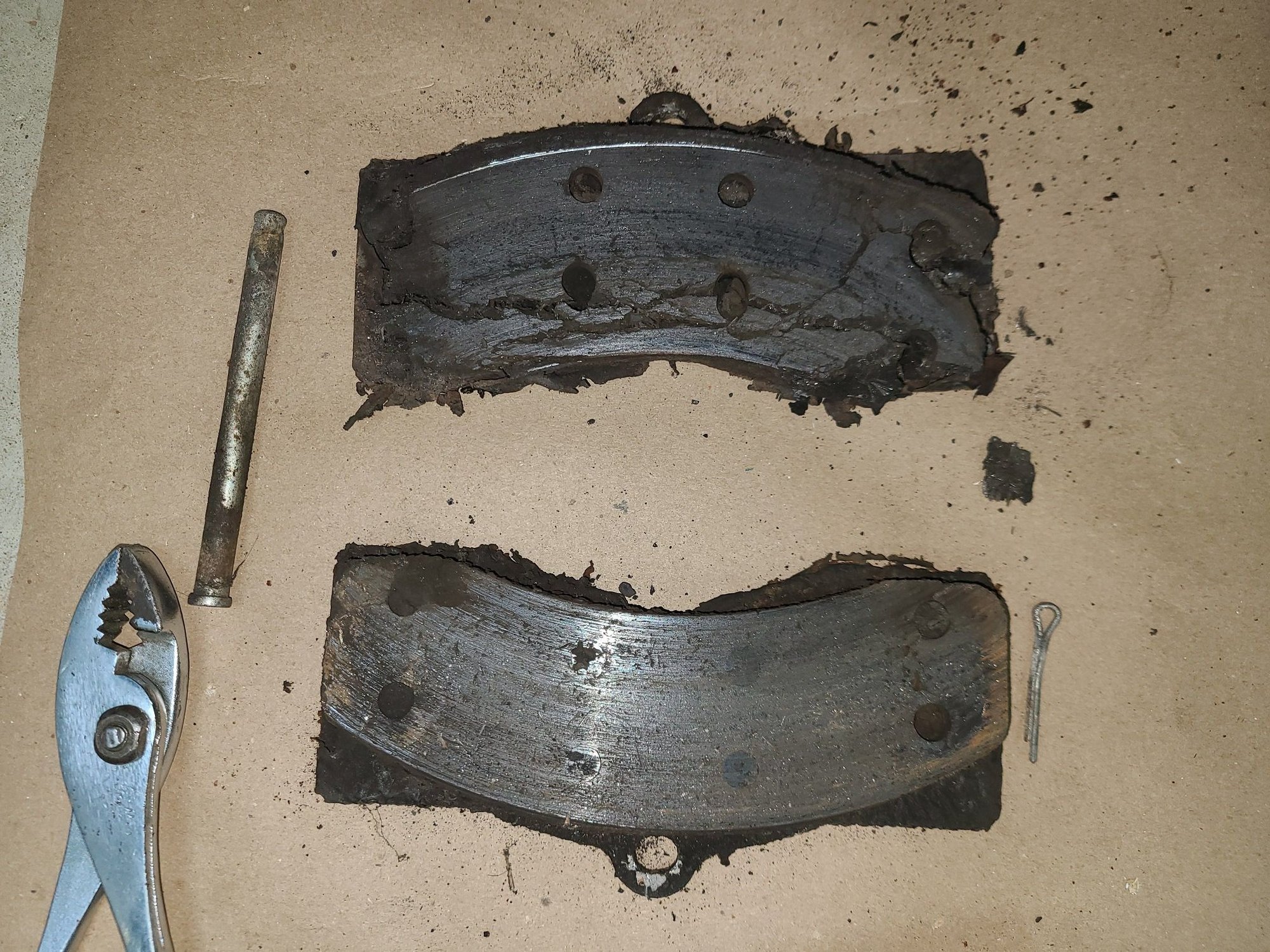

Got the rear end up and the right rear inside pistons were leaking.
I'll pull both calipers off and take them apart to see if they are pitted or not. The rotors look ok, didn't measure them though. Anyone know the minimum thickness of the rotors?
Both reservoirs were very low so I suspect the front may have a leaker as well. Anyway the most important thing for me to fix first is the brakes.
JT
the minimum thickness should be stamped on the face or the edge. I’m thinking 1.25” but someone should check me on that.
