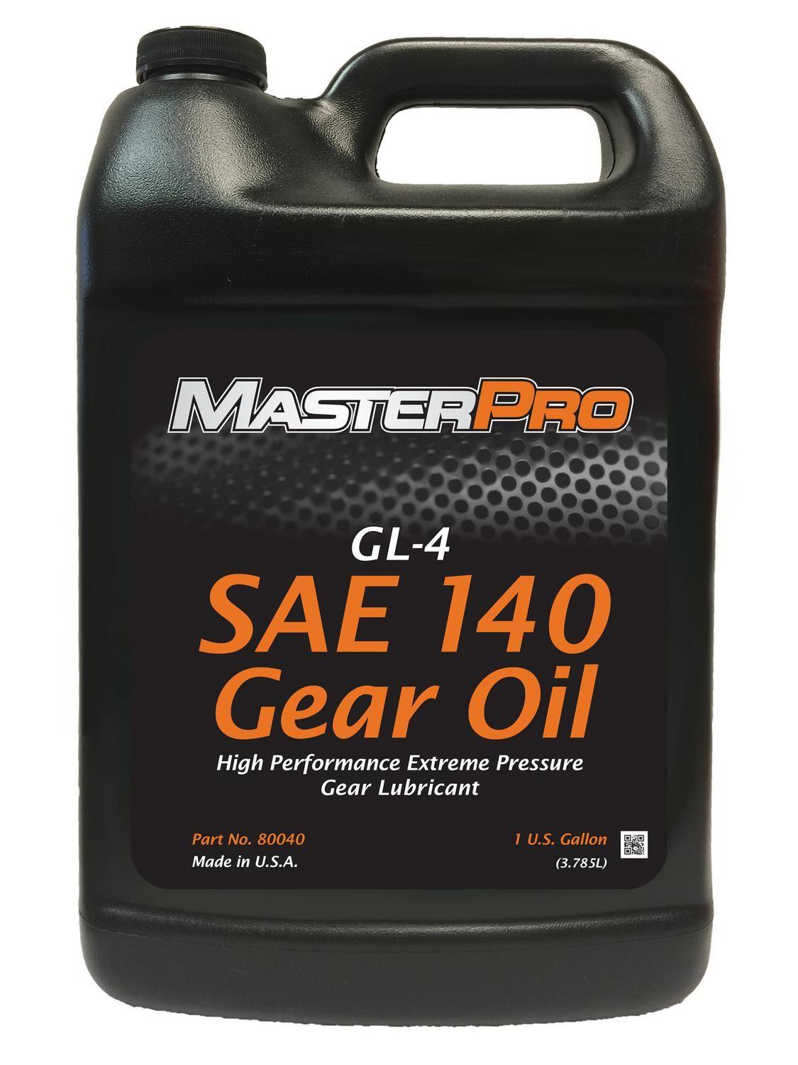

All I could find locally was this. Next big town is an hour away, ordering online takes shipping almost a week to get here. I bought it and put it in without thinking. Is this acceptable in my 4 speed?

Presume you have a Muncie?
No major harm done but a better choice would have been PennGrade1 80W90. You might encounter some issues with shifting responsiveness with the heavier viscosity you put in though.

Yup, I'd order the correct stuff. Sucks to wait. But that 140W really isn't the best.

It's going to be really fun to shift in cold weather with that 140W.

It never sees cold weather. Thankfully

Equal to SAE 40W engine oil, 90 weight gear oil is equal to SAE 30W engine oil. So say the charts.
(same viscosity/weight, not the same oil as)
