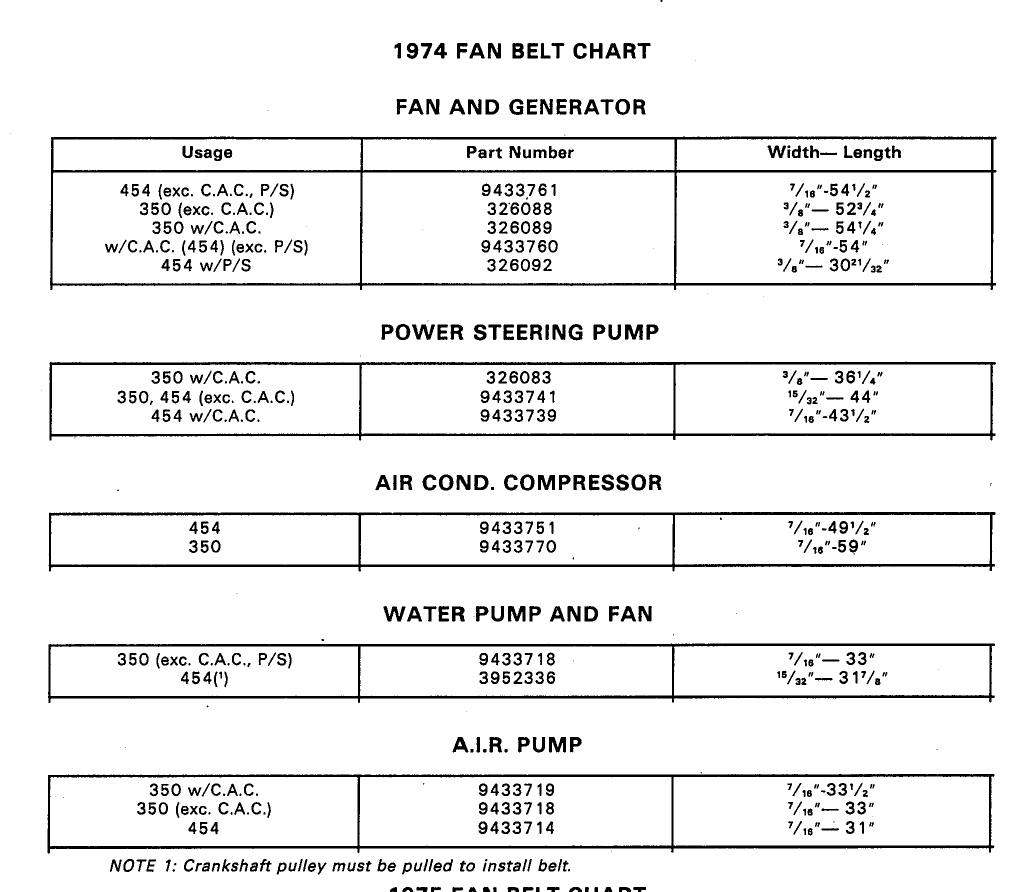

Here's the GM Corvette parts book page for '74 belts:

Visit the GM parts link I posted above and go back a couple pages. You still won't find that 3940992 belt. I found one reference to '69 Corvette using it for P/S (43.5") but not in the Corvette-only parts books. The 992 belt was used for other GM products.

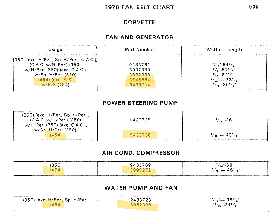

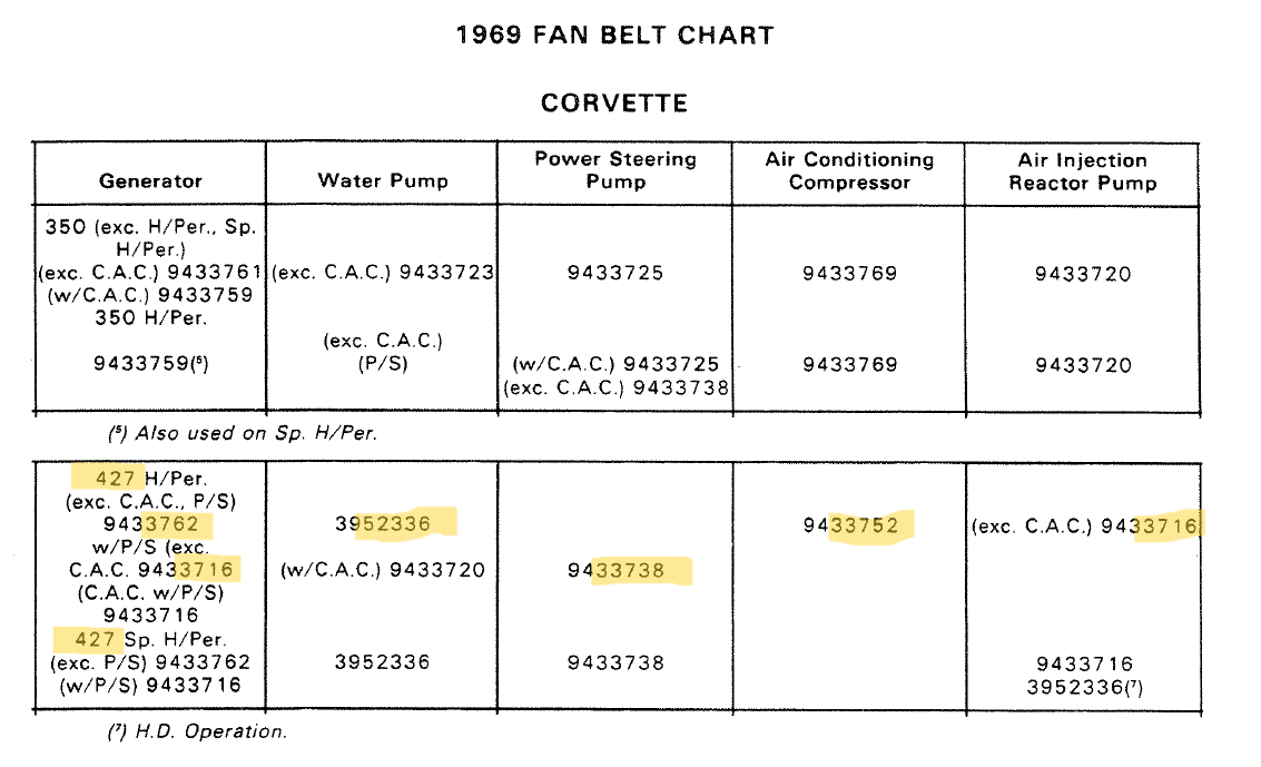

These are from my 82 Parts Book.

I have the belt charts as well, and they vary by year, but they are pretty useless until you know exactly what pulley combination you have, and if it exactly matches a stock optioned setup. with: PS, AC, AIR pump etc.
69 BB Drive Belt Chart
70 BB Drive Belt Chart
71-72 Drive Belt Chart

GM says the 9433738 is the right belt for all BB PS up to 73. It should be 7/16" wide at the top and 43.25" long circumference. Measure the depth also.
Measure your current belt specs against that.
