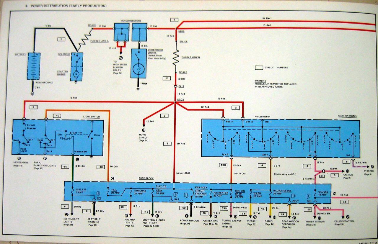

This is for an early 77

sounds like a fusible link
