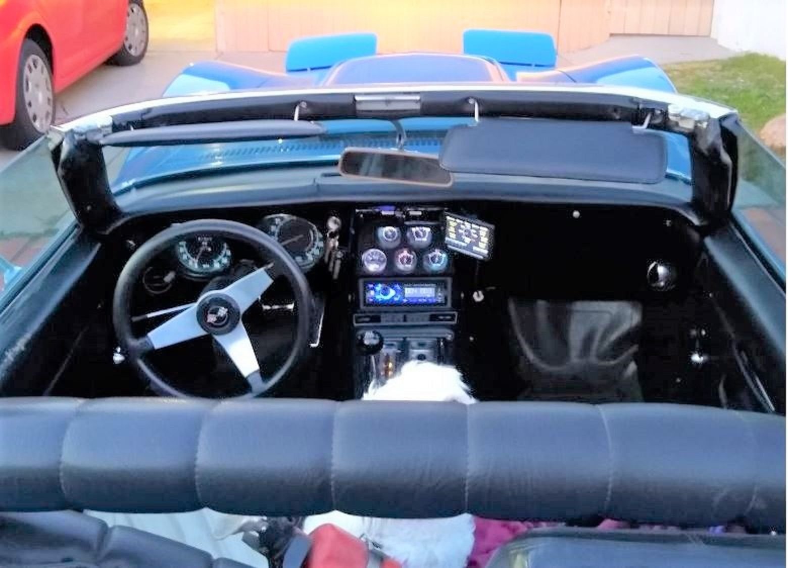

Was able to get the ETuner to work on a car play single din display .. Cleans up the interior !

Proflo 4 is more user friendly.. The Holley software in my opinion is great for some one who knows how to use all the features . It’s made more for a professional tuner .. The Edelbrock ETuner is geared more for the DIY guy like me it has what u need to get it tuned where u need it .. The learning does the rest .. I found the Holley very confusing and time consuming to learn ..I could never get it to where I was happy how it ran .. The Proflo 4 is running great so far .. Looking back should’ve just spent the money for the Proflo in the first place ..

I like the way you were able to integrate the Edelbrock display into your dash. Nice job!
Really like my Edelbrock Pro-Flo 4XT system. Biggest issue I've had is that I get a bit of vapor lock on hot starts on hot days. I believe it's related to the fact the crossover fuel hose between the two fuel rails is too long and lays on the intake manifold right up against the thermostat housing. I improved the situation by insulating that crossover hose (and other fuel lines in the engine bay) and taking out a bit of crank fuel at higher temps. At some point, I'll find a new shorter hose which will hang in the air space below the intake and that should keep it a bit cooler.

Look at the dash pictures , the AFR gauge is on the right bank O2 sensor 14. The Proflo display is the left bank O2 sensor 13.9 ! Sniper was always off sometimes quite a lot …Could’ve been the corrosion in the Holley distributor .. Engine running super smooth .. Alohas !

Tell us about this Single DIN display? Where did you get it and what does it do (is it also a radio?)? How deep is it? I have a separate handheld unit for my EZ-EFI but yours is way cooler.
