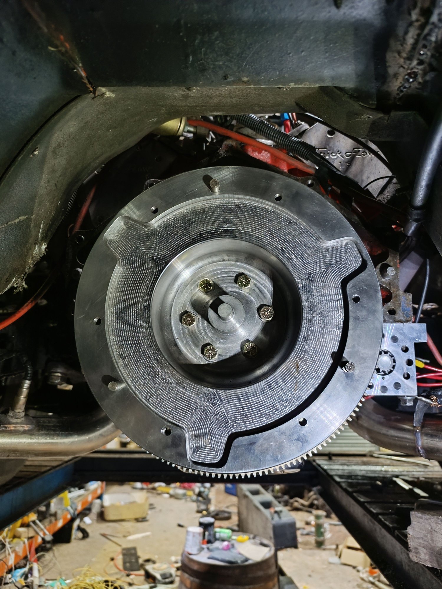

Wooforduk, could you share with us how you performed your BMW 6 speed conversion? The BMW transmissions that I am familiar with have integral bellhousings.

I can do indeed, I made an adapter to take the chevy pattern to the BMW pattern and also had a custom flywheel made too.
I had to modify the transmission tunnel to make it fit but that didnt actually take too much to do. also made a custom prop shaft.

What are your 6 speed gear ratios? How much TQ can the tranny handle? Years ago I liked the idea of the richmand non OD 5 speed. but the problem was lack of TQ handling. I installed the TKO 600
Very impressive work on your adapter

Yes, very impressive. Did you do all the measuring, designing, programming yourself? May I ask how much time and money machining something like this takes?
