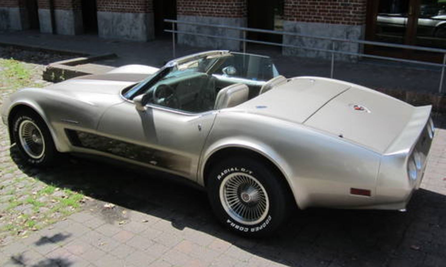

The 82 SE I refer to was owned by a friend. He had it brought to Australia. I believe it is now down on the Gold Coast. ( Same general area I guess).
And it is near perfect. You really wouldn't know it wasn't factory if you didn't know it's not possible. Right down to the fading graphics. Paint color, interior, it's an 82 convertible. Didn't make them you say? Well, explain this one!
So, yes it can be done. A 74 rear clip complete with birdcage, with a 80-82 style replacement rear bumper cover. A 82 front clip spliced on with all the dash, interior of a 82. Details like getting the carpet in the rear to match up would be a challenge one would think. The Devil is in the details.

Here is a Mecham Auction car:
1982 Corvette Convertible

Thanks, This is what I have been looking for! it's perfect, I owe you.
Old Oct 2, 2024 | 10:24 AM
Racerjoe's Avatar
Racerjoe
Joined: Jul 2021
Posts: 19
Is this your car? looks great. I see you don't have the vents, is this something that is not needed? Looks like they started to make my vents in the deck lid? Strange

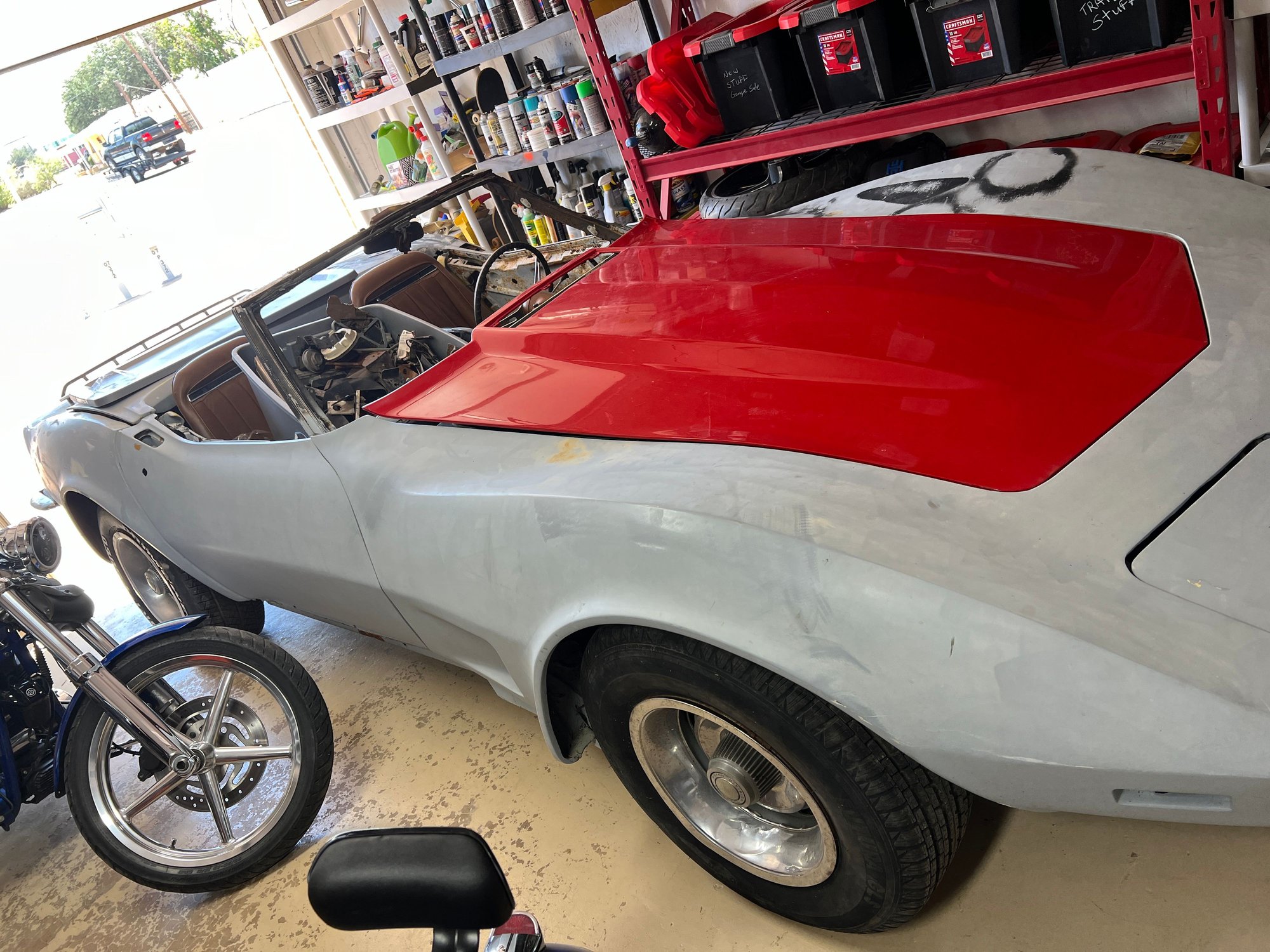

Pics of your project ???!!!!

Old Oct 5, 2024 | 02:11 PM
Racerjoe's Avatar
Racerjoe
Joined: Jul 2021
Posts: 19
