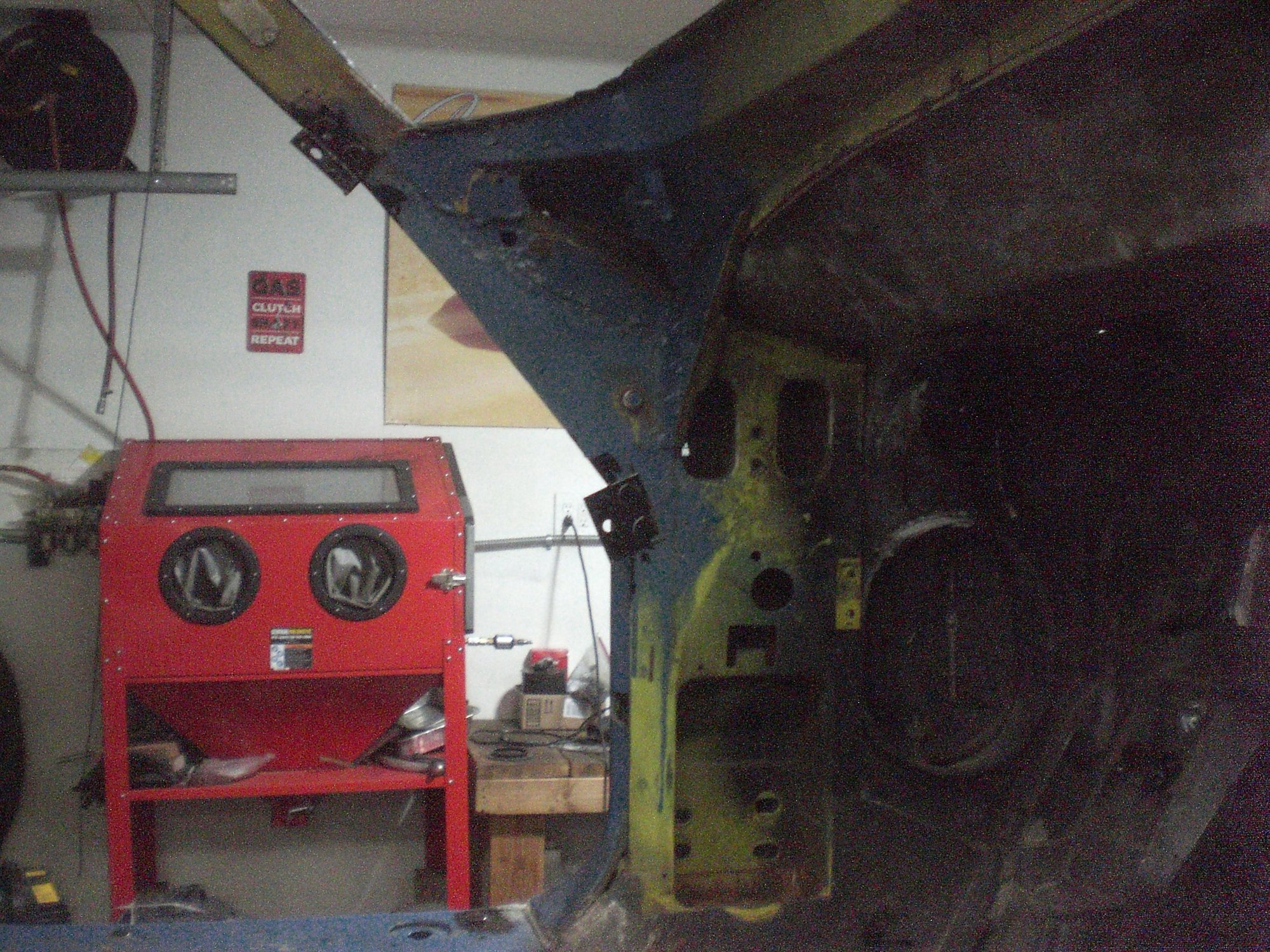

So I have been troubleshooting a gauge/dash illumination issue and have tested the tail light fuse (good), the headlight switch and rheostat (good) and the 7.5A dash/illumination fuse (good) and have concluded that since every dash/instrument/transmission/AC light bulb (12+) is out (courtesy lights work tho) it must be a common single point ground issue. The manual schematic calls out this single point ground as being on the left side above the door switch. Does anyone have a picture of this common grounding point and how to reach it?

Disregard the rusted out inner windshield frame corner that will be replaced...
I believe that the bolt head in the center of this photo (directly above the lowewr black bracket) was my '71's dash ground point.
Hope this is what you're looking for

Thanks I will look into it
