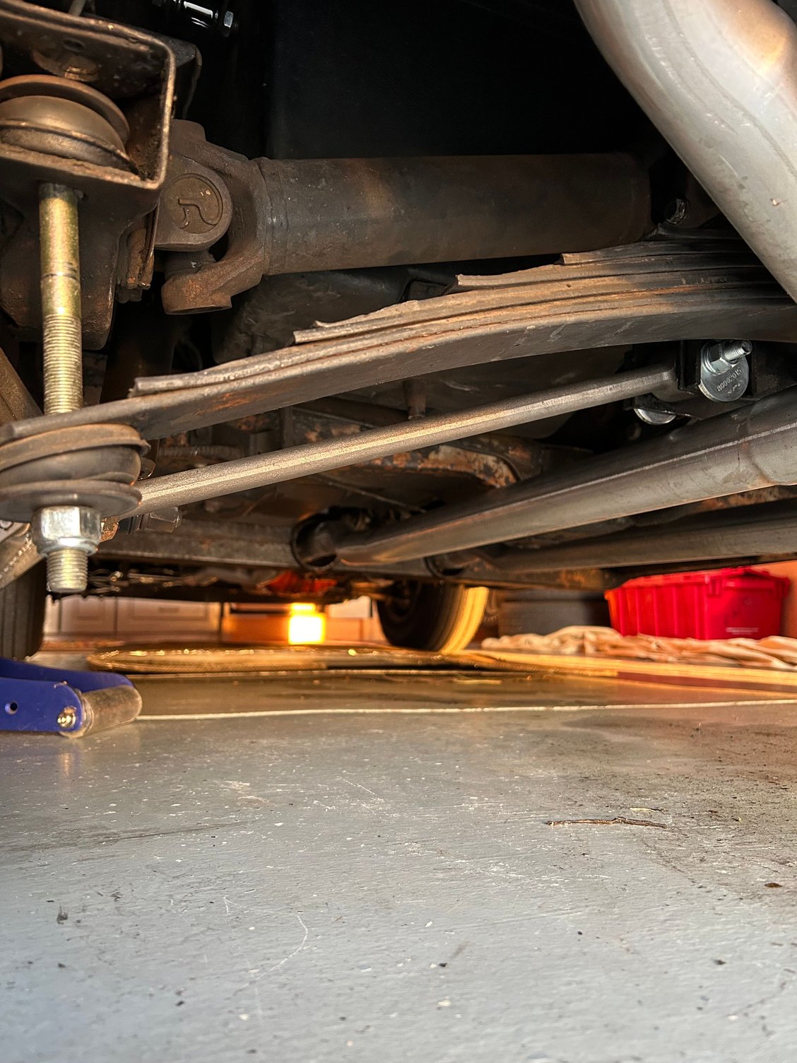

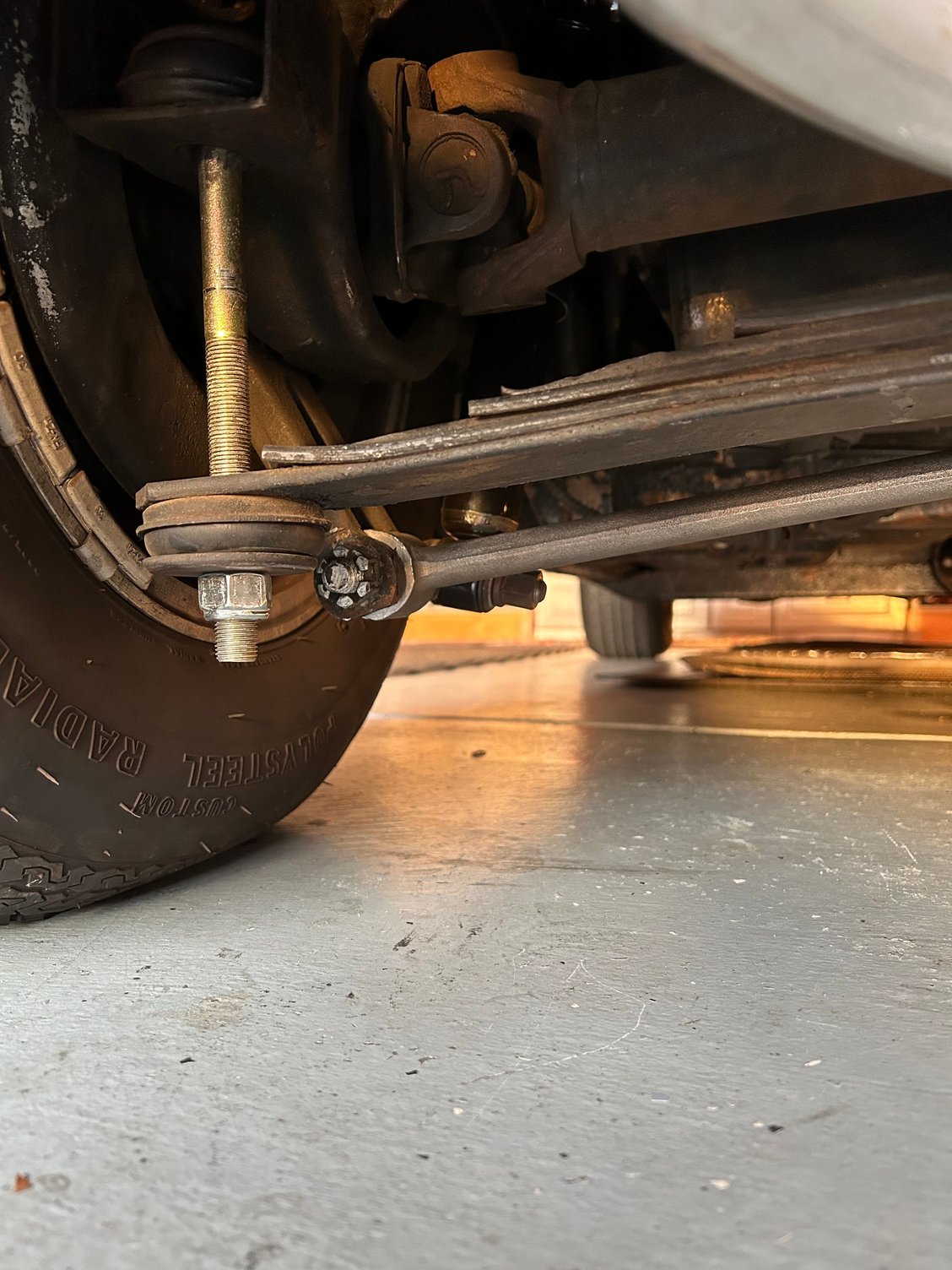

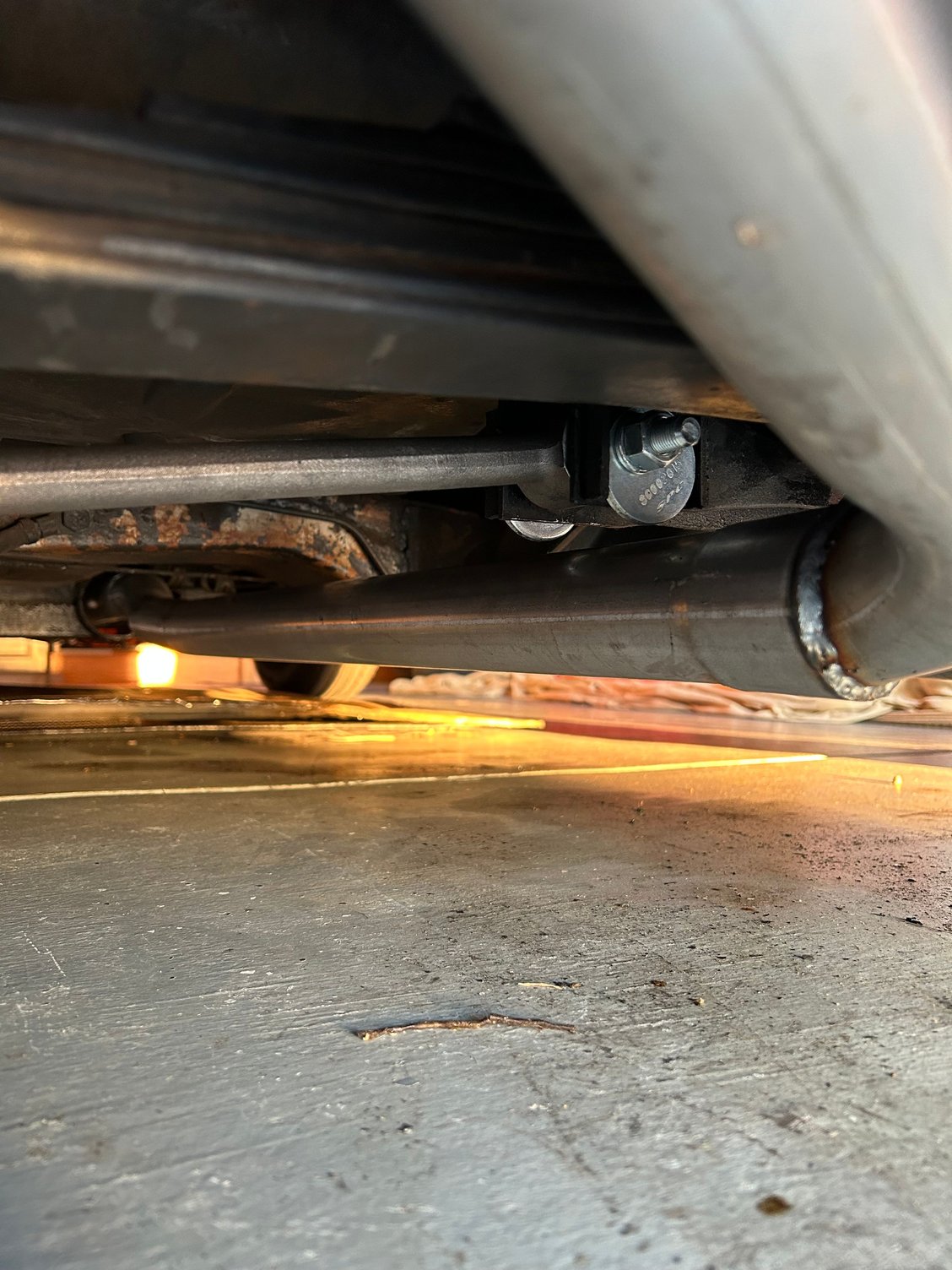

Rear drivers wheel jacked up off the ground
Here's a closer look at the driver's side rear suspension. I tried to move the rear wheel while jacked up and could not get the wheel to move at all. I tried to take a picture of the yoke but was too dark. I did not see any evidence of "machining" into the case. Thanks for all your ideas.

the circled area of strut rod shows it is almost max, moving bottom of tire out and top in.
I would start with adjusting to max in, and see

It looks as if you have new lower strut rods and adjusters.
If they were replaced recently, and set to where the crumbling bushings once were, that could easily be your problem.
You just need an alignment.
If you already had an alignment, then perhaps the adjuster has slipped.
That bolt needs to be really tight.
And I suggest marking the eccentric with a sharpie or white paint stripe so you can easily check it for a while to ensure it has not slipped.

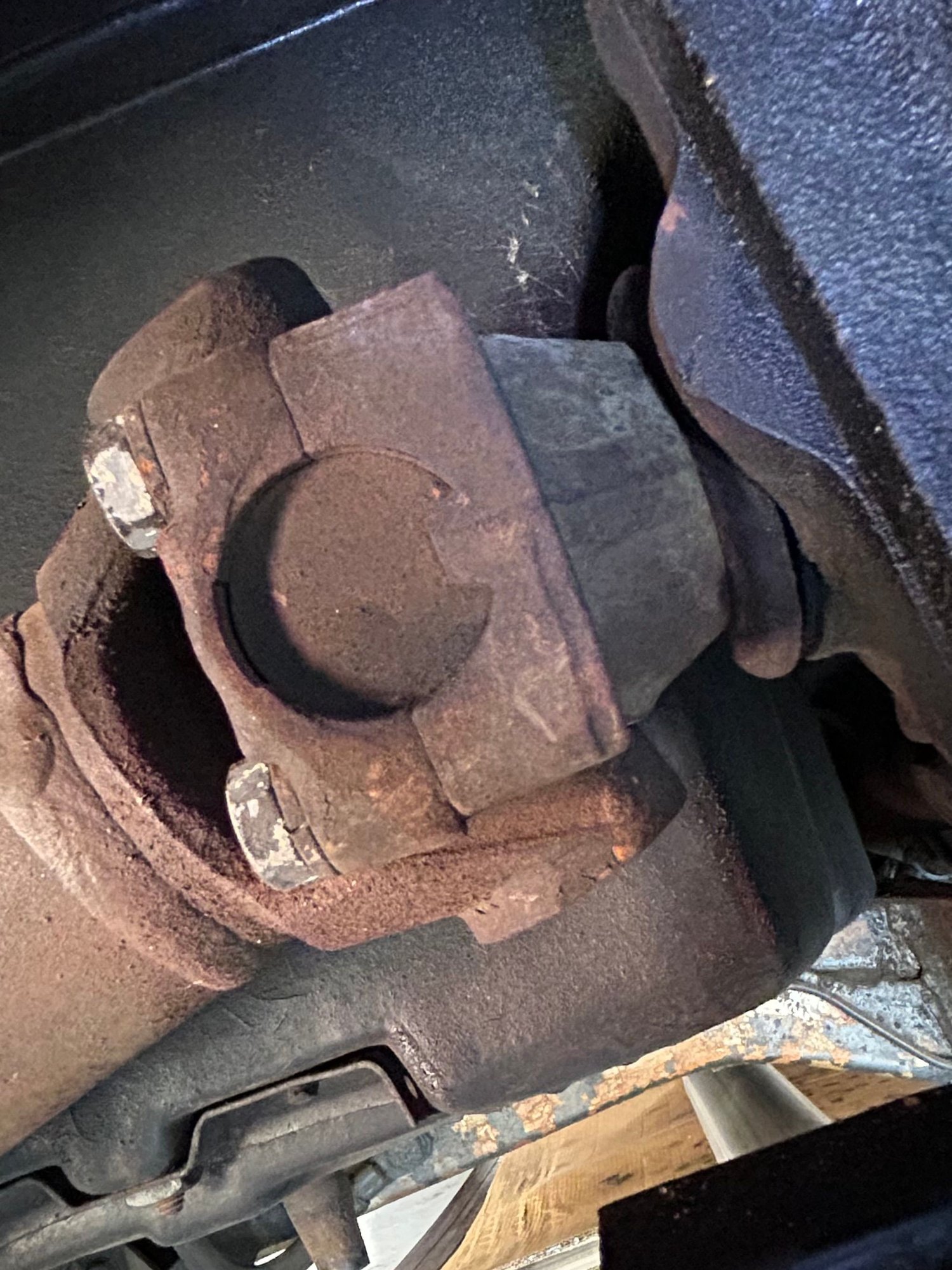

But you also still need to show us a pic of the inner yoke, perhaps use a drop light.
Guys have done video mode while you yank/push on the tire top.
It will move, some. The big question is, how much?

Here's the yoke next to the diff on the same side as the leaning wheel.
