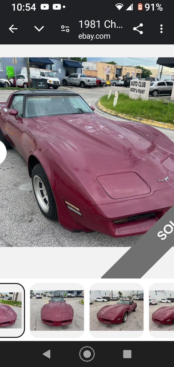

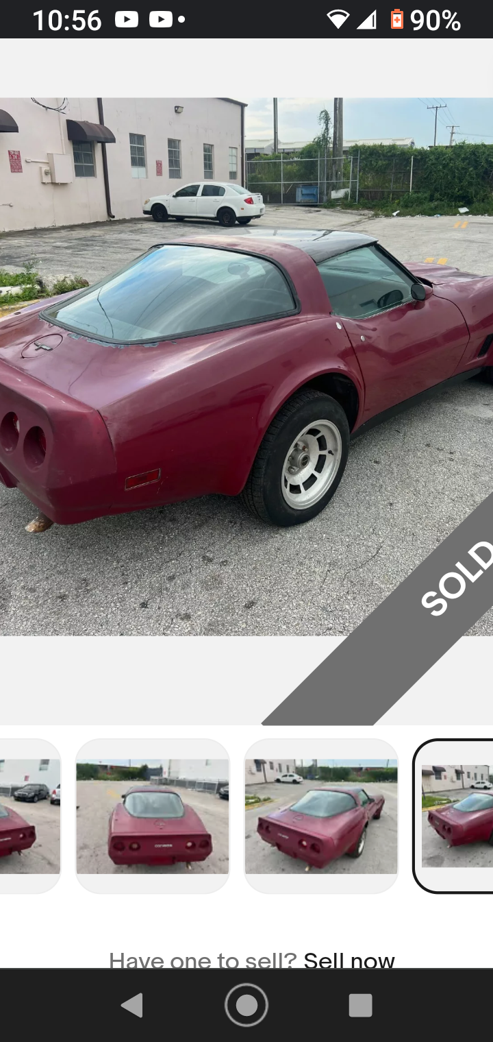

Well dang..this thing does have a dist in it..my glasses do work after all

Thanks!
Looks like a carb from a 1979 Corvette or earlier (NON-electric choke, no other electronics, that I see). It could be any random Q-Jet, but it is certainly not original. Check the numbers when you get it to confirm.
That is a pre-HEI points distributor, and does not have a coil (or spark plug wires). So, yes, you need an HEI dist, and a bunch of other stuff.
You are missing all accessories, pulleys, and brackets on that engine. It does have a radiator, though. It is a 77 or later engine, judging by the engine stamp pad shape. Please post the numbers/codes when you get it!
That would make a great LS/TKX swap candidate. Good luck with it!
