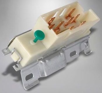

New ignition switches come with a greenish locating pin inserted in them. This keeps the internals from moving until the electrical switch and the mechanical switch are aligned. With the pin inserted it is quite easy to align both parts.
Standard steering column and tele-tilt use slightly different switches.
