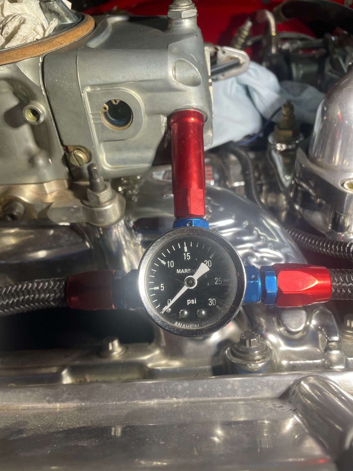

my fuel pressure meter shows 7.5 psi but I guess its under what's advisable to have a correct flow, specially at highr revs.
what would be a suitable pressure in PSI?

Fuel pressure needs are determined by what your feeding.
Looks to be a Holley carb in the background there. Not the best pic, but CLEARLY not EFI. So, Holley carb. 7.5 PSI. A tad on the high side maybe, but should be just fine.
Not clear where your getting your information. Definitely NOT LOW! not for a Holley carburetor.
Now, the EFI in my car, ..... But that's an entirely different kettle of fish!

Yes, Holley carb, its what I read on the meter at idle 7.5 PSI.

Not certain what if any issues you maybe experiencing. But your fuel pressure at idle is certainly not the problem.
Perhaps your pressure above idle is a issue?
Perhaps you could clue us all in as to why your drawing these conclusions.

I draw these conclusions because the engine seems to loose its strength above 4 k rpm, it seems that it gets short of fuel flow while in the low and mid ranges it shows a strong pulling torque.

Wonderful thing about that under hood pressure guage. At the speeds and RPM's you are experiencing issues. Are you able to read this guage?

For a lot of carbs including Holley you do not want pressure any higher that 7-8 psi. I would strongly suggest if you can afford it to get a fuel pressure gauge you can mount in the cockpit then you will know what your fuel pressure is all the time not just when parked with the hood open

If you are running out of fuel at 4k, the problem is flow, not pressure. You can only get so much fuel through the stock fuel lines.
I actually went from 58psi through the stock lines to 42 psi and a full AN-8 (1/2") line from the tank to the rails for my EFI. Runs much better.

You haven’t given enough information about the engine, and your use of the car for anyone to help you solve your problem.
What are the engine specs and what components are you running?
You state it seems to starve for fuel at 4000 rpm.
How long are you running at 4000 rpm.
Are you racing the car, just driving on the streets or just being a street cruiser with an occasional blast?
In your picture, it looks like you are running a -6 feed line to your carburetor.
Unless you are running a 700 hp monster with an 1150 dominator Holley you are probably fine on your feed line.
You also stated you changed fuel pumps.
What did you replace the “racing” fuel pump with?
Mechanical fuel pumps are rated for “gallons per minute” and a pre set psi.
What were the specs of the new fuel pump?
Are you running a fuel regulator?
With anything other than a stock fuel system, you need one.
If you have one, what type, where is it mounted in the system and what do you have it set to?

There should be a 4 digit number cast into the carb, like 4150 or something similar.
Find that number and then go to Holley’s website and try to match your carb up to one of Holley’s.
give us at least some better pictures of the engine with the air cleaner off so people can at least see what you have.
