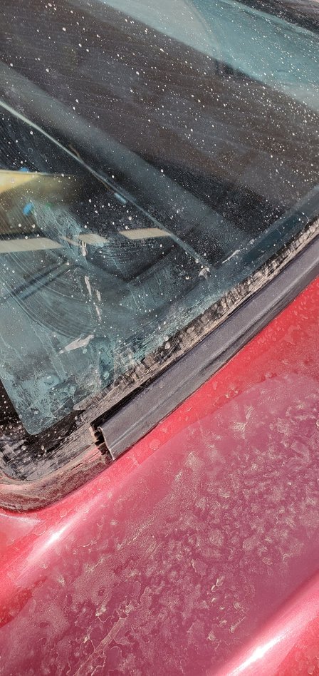

Hey folks I took the rear louvers off my 1979 better and I only see some trim that goes around the bottom of the rear glass. Is there a piece that should go around the sides and the top. Attached are pics. Thanks in advance
Upper window no trim
Lower side no trim

Yep. 2 short corner pieces and a large curved one that goes across the top. I don't believe reproductions are made and decent original pieces are a little hard to come by.

Looks like you have a couple of brackets at the top which presumably held the louvers. You'd have to remove these to fit the trim, that could be a problem if they are screwed on underneath the glass. Also you will need some clips to hold the trim, these can be tricky to fit with the glass in place
