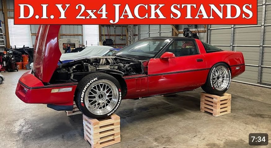

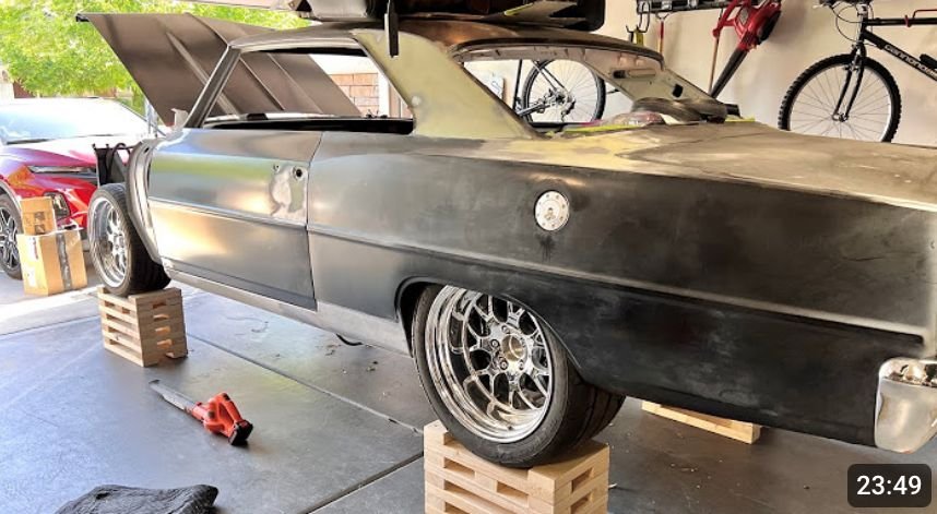

I will soon be building “wheel cribs” for mine. If you plan for it to be in the air a bit, this may be a good idea for reasons mentioned.
There are a gazillion vids on youtube showing how to build and use them if interested.

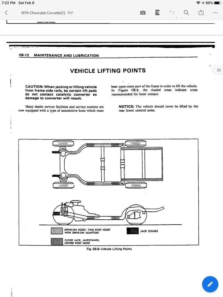

If you have an owners manual it shows the correct spots...
