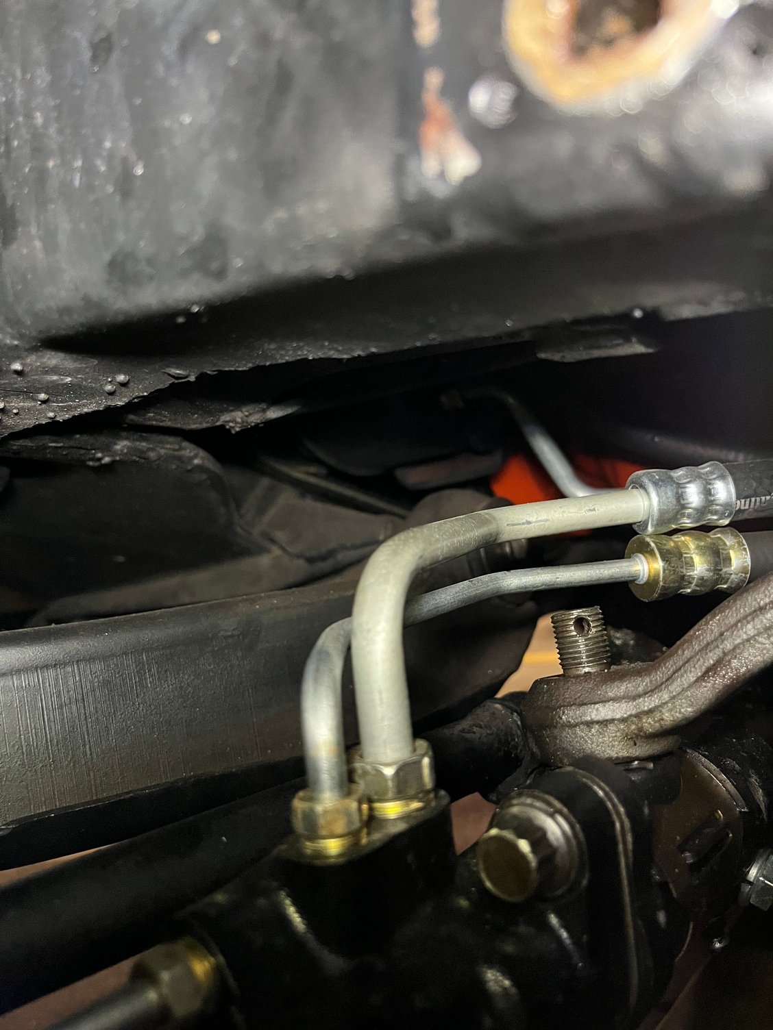

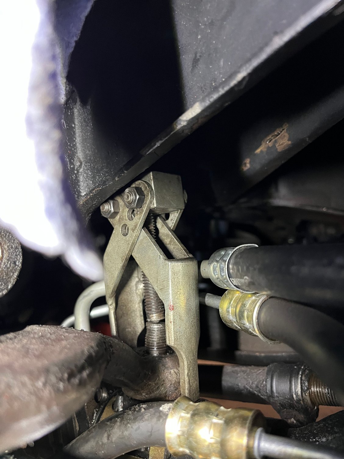

Default It's done

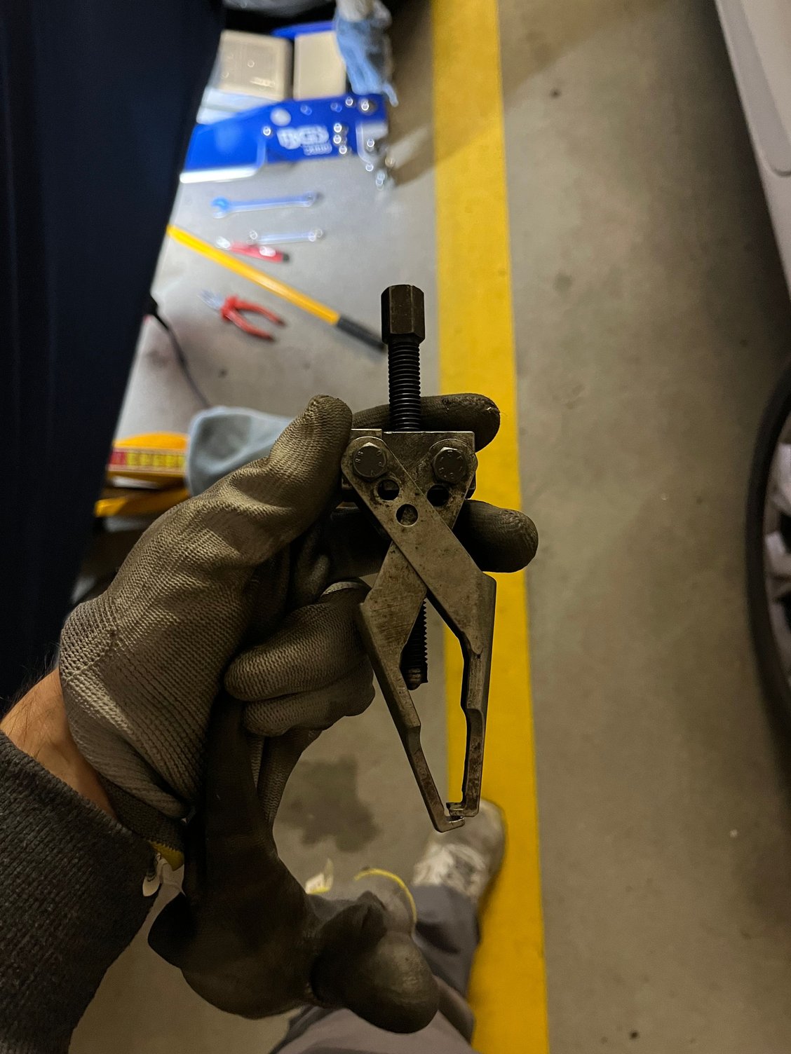

I managed to pull the arm off with the right tool, it was tight, but it also worked with the hoses, as has already been written here.
Here are a few pictures:
The puller that I used:
