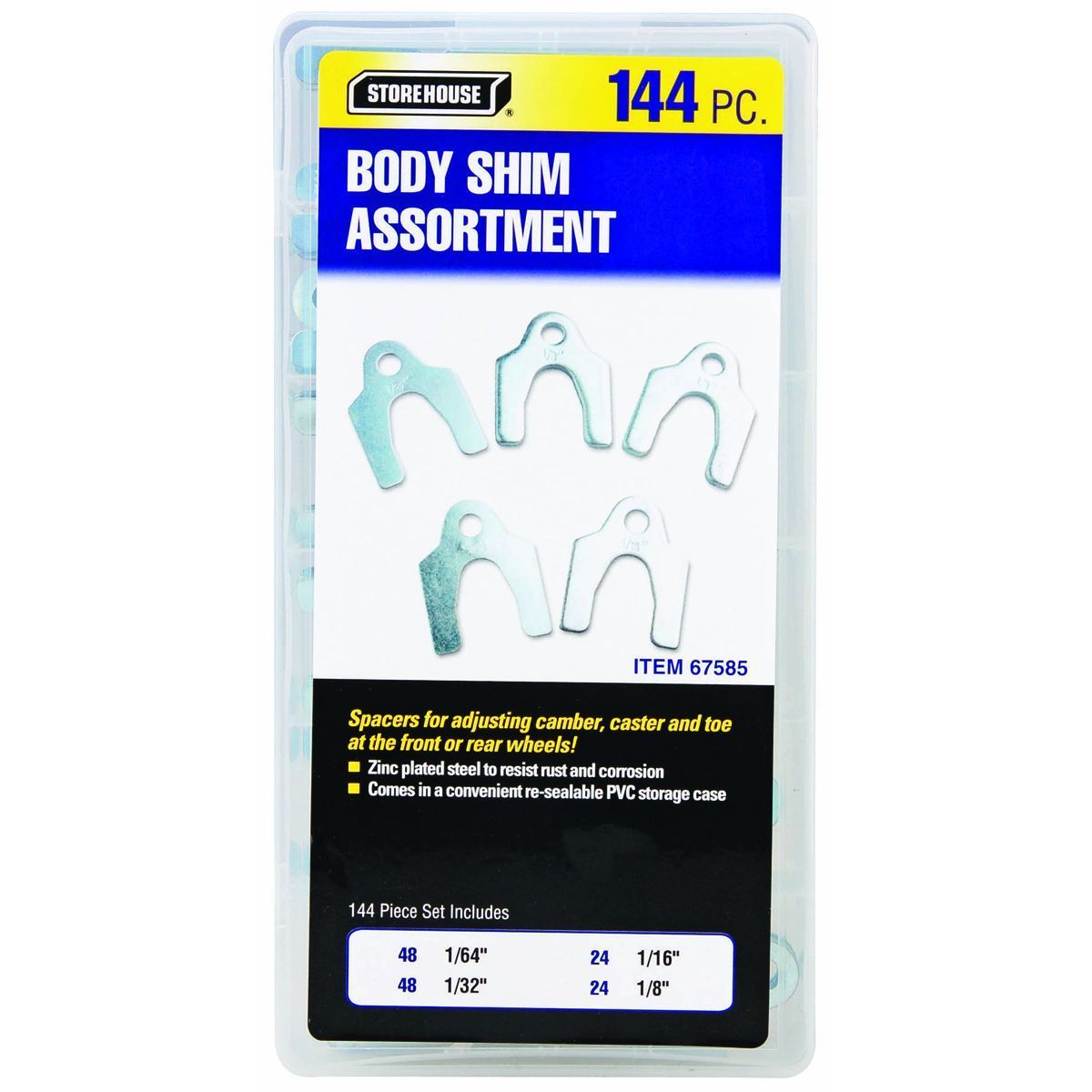

Harbor Freight sells a 144 pack of shims in different thicknesses that look very close to the original style, all for 10 bucks. I wish I would’ve saw them before I bought mine online.
For the rear I bought a stainless shim kit, it had 4 large, 4 medium, and 8 small shims. (1/4”, 1/8” and 1/32”)
