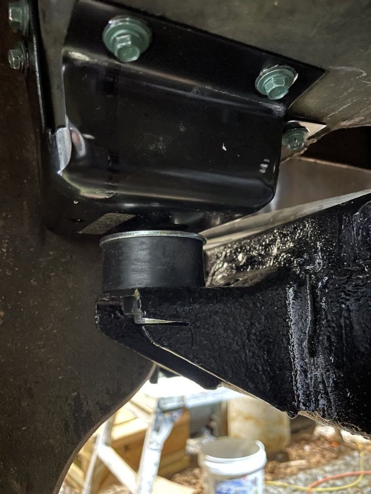

I did all the rubber body mount bushings on my 77 about a year ago. In a small one car garage with hand tools.
Check your number 1 and number 4 mounts. Those were the really bad ones on my car.
That said, it was a job I put off as long as I could. And WOW, Were they bad!
Back to the question. How big a pain is this job?
On a scale of 1-10, this job is a 18.
Good news is my thumb did finally heal!

Case in point.
Passengers side number 1 mount after removal.
Passengers side number one mount as found.
just look at the corrosion on that number 1 bolt!
Numbers 2 and 3 on both sides were in really good shape. They are out of the weather! Number 4's get all the spray off the rear wheels. WOW! Lots of people need to do welding back there. I was fairly lucky. But I did need to replace the reinforcement cages on both number 4's which is a job!
Bottom line, do a Google search of C3 Corvette body mount replacement. Lots of the hits will take you right back to this forum. Tons of reading for you to do.
Go to Zip Corvette's Web site. In addition to selling Corvette parts they also have a number of videos pertaining to Corvette repairs. I looked at a few all over the net. I'll save you a little time here. The Zip Corvette instructions work really well for the little guy at home, using the scissor jack that comes with the car to lift the body! Bloody brilliant!
I used one really small floor jack. And I borrowed another med. sized floor jack, so 2 floor jacks. And the scissors jack that comes with the car and a few hunks of wood.
Took me about a month, I work 6 days a week so, spare time. Lots of time soaking bolts.
The BEST penetrating oil hands down, is ATF Mixed with acetone 50/50. Mix some up because you are definitely NOT getting a sawsall blade in there!
Do a TON of homework! Keep in mind if I can do it in a tiny one car garage in my spare time, So can you!
Did I mention I am also very old?
You can do this!

When it comes to converting a early C3 over to rubber bushings I only know what I have read.
C3 rubber mounts are thicker than aluminium. Raises the body slightly. Alignment issues with steering column/steering box?
I read on here at one time that C2 bushings could be used and are thinner than C3 bushings but have no way to confirm that.
Good quality rubber isn't as easy to get nowadays as it once was. Regulations have changed the way manufacturers are making rubber parts. And not for the good.
I purchased my replacement rubber mounts from Bairs Corvettes. Fingers crossed that they last!

I have bought the c2 rubber mounts and placed them side by side with my aluminum 72 mounts. Almost identical in height. Both roughly 1/2" The later 73+ rubber mounts are 1" high and cause fan blade to shroud issues and at steering column. Plus you see more frame under the side under door mouldings.
Solid mounts would have more buzzing and vibration and noises. The rubber helps cut that down.

Found my pics
Here are my oem 72 aluminum mounts vs the c2 rubber mounts
al = .385" high vs c2 rubber = .585" high
73-82 rubber mounts below
roughly 1" high
