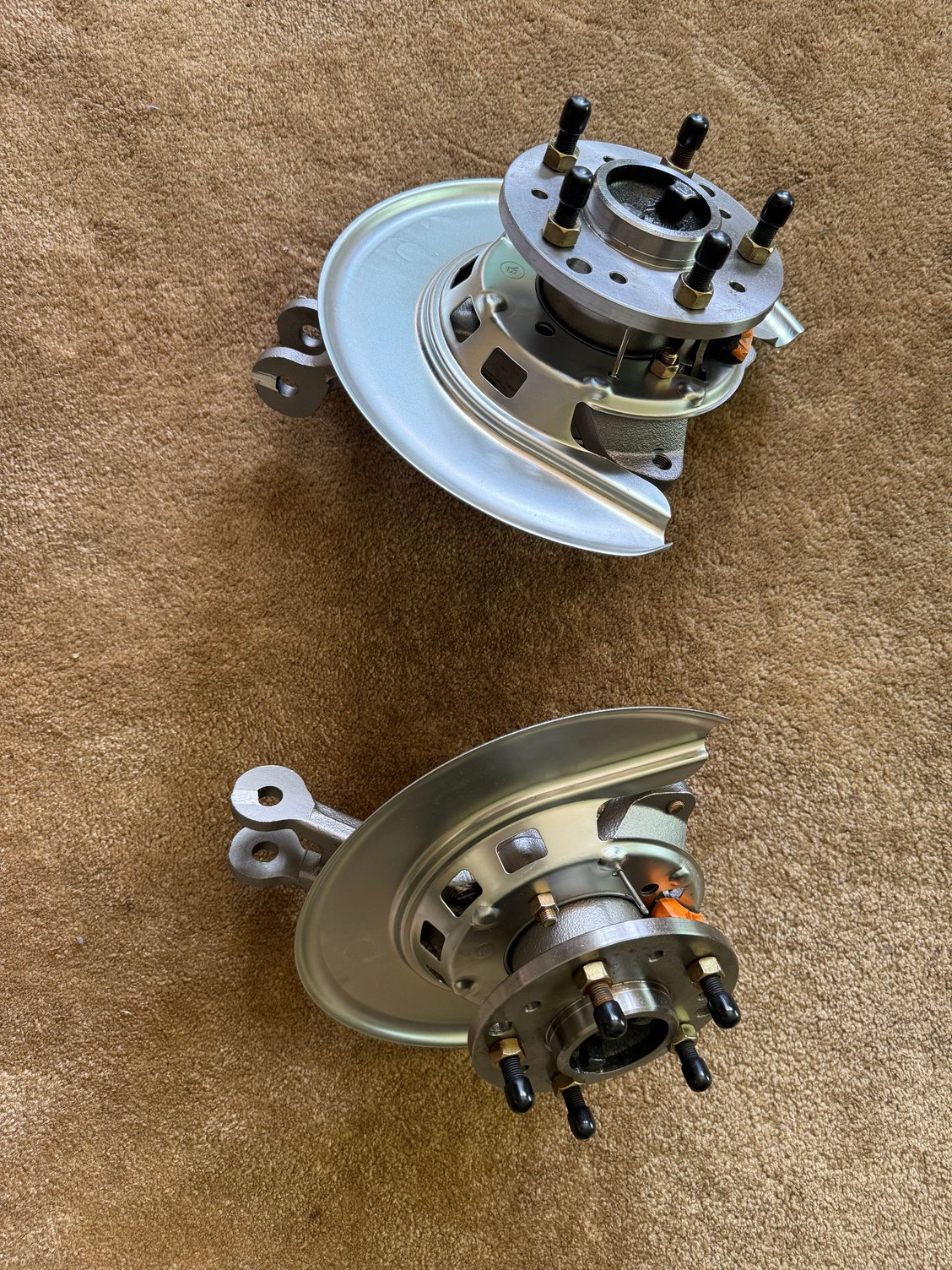

Just replace my rear bearings. Also did the front. For the rear I bought one of the kits with the tools on eBay which I thought was cheap. I planned to buy additional bearings and not use the bearings in the kit but ended just using them anyway. Considering it's taken me over 10 years to put 10000 miles on this car I just don't see it being an issue soon. I watched about3or 4 different videos on YouTube and found the best way for me to do it correctly and found the job fairly easy. I did buy the bearing race install tool from hf which I used for the front as well. No issues. Getting the trailing arm out of the vehicle to replace it was the hardest part for me as the passengers side arm was damaged. I already had the dial indicator and mount for end play but those are cheap at HF and good quality if a person doesn't have them already.

I replaced the rear wheel bearings in my 1976 Corvette recently without removing the trailing arms.
The most difficult part of the job was knocking out the old bearings. I purchased an inexpensive tool kit (less than $100) for removing the old bearings and installing new Timken bearings purchased from The Spindle People.
