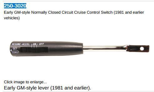

Use this beast on your 77 T&T column...lol
$22.00 classic industry's

I have a 75, not a 77. But, you feel it should work on my 75?
Old Oct 20, 2024 | 11:36 AM
bmotojoe's Avatar
bmotojoe
Joined: Oct 2007
Posts: 4,383
Likes: 1,754
From: Seattle Area Washington
No, that stalk is for 77 and later.
From what I have see there's also a difference on the 75 between a T&T stalk and a standard column stalk.
Also, if you go with the Rostra kit you will need to install a inline speed sensor (incorder) this one sends 16 pulses per revolution.
