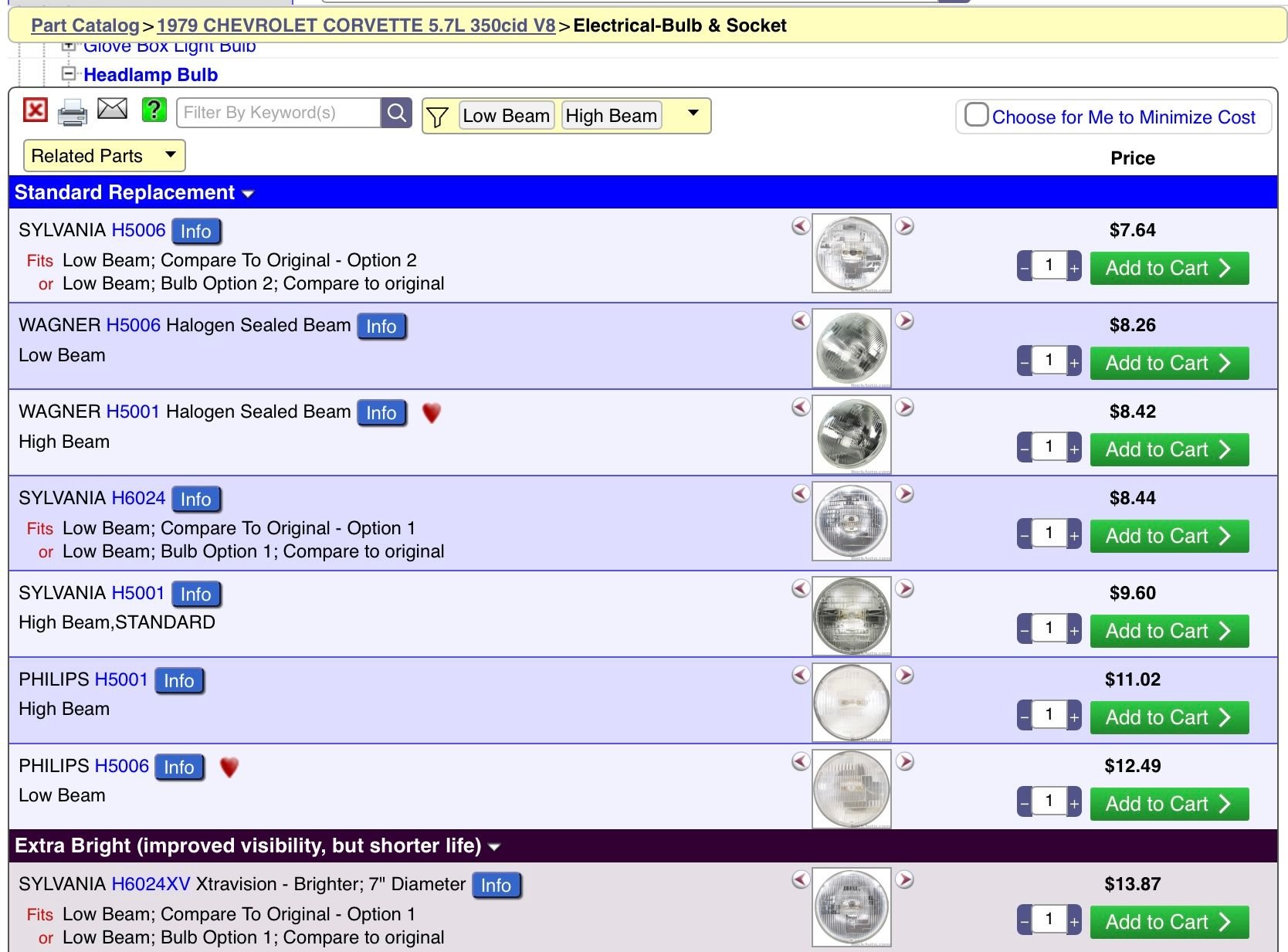

And a 79 or at least my 79 and I pretty much had full battery voltage going to the headlights ( i think 0.3v lower) so I don’t think that’s your problem unless there’s a issue with the wires. I was surprised that when I put new headlights on that, it was significantly brighter than the old ones I replaced and there were still halogen. I would try that first. I also find when I turn the bright on it gives plenty of light, even for a car that says as low as it does. I thnk i got them at napa and were wagner.
still wouldn’t hurt to measure your voltage
