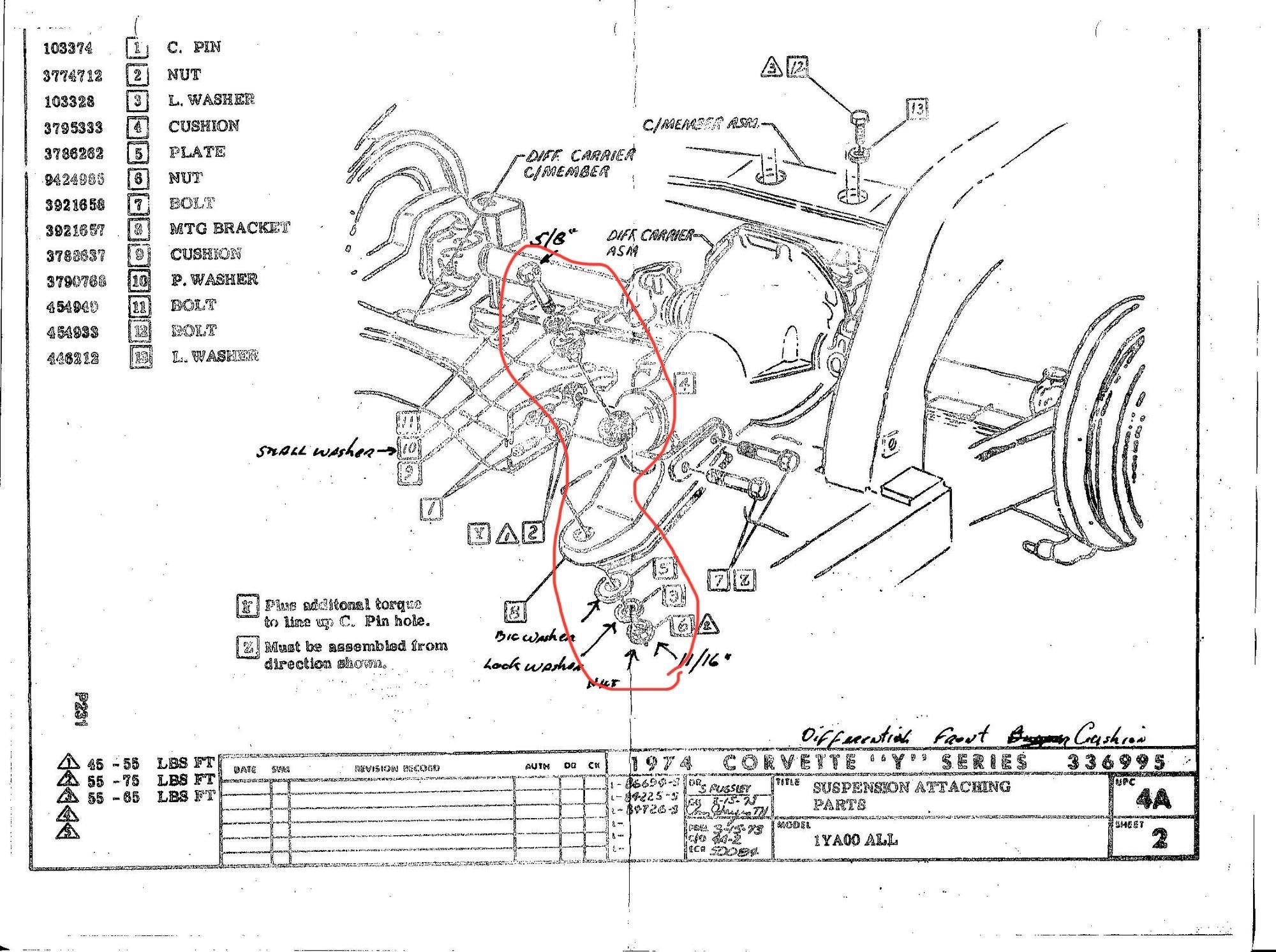

Does it also do this when going into drive? The most common cause is the snubber busing on the differential going bad. There’s a number of vendors that sell replacements.
