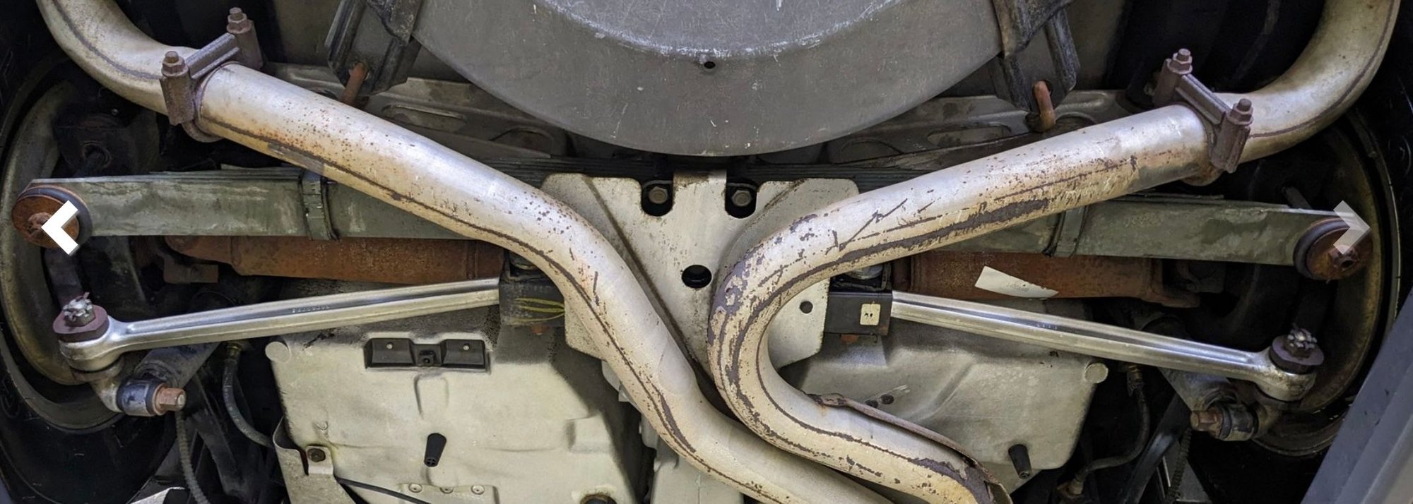

Of interest in this picture is the C4 style Strut Rods. I have only seen one 82 that has had them. I believe that not many cars came with them, probably late in the production year. Just another oddity that GM liked to do to our Corvettes just before production ends and a new model replaces it.

Why would you think that's a 84 strut rod? 80 to 82 used a different strut rod than earlier C3's.

Take another look. @Buccaneer 's strut rods (not the OP) are aluminum, which I thought correlated to FE7 gymkhana suspension.

Is the picture in this thread? I looked at Buccaneer's post in this thread and did not see a picture. Thanks.
