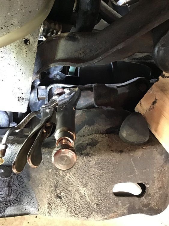

@Jerry1978 I don't have any room to hit the bolts with a hammer, the passenger side has the fan shroud about 1/4" away from the end and the AC brace is about 1/2" from the end of the rear bolt. The drivers side the power steering pump is about 1/2" from the bolt...

note post 3 and in my thread..yup not easy but doable.. i thnk i grabbed mine with vice grips and pulled off.

@interpon Thanks, I'll try the vise grip.

The bolts have ribs on them, like the wheel studs. I mentioned it because I couldn't figure out why they were not moving and pulled on them until I got them to turn. On the other side, I was able to tap them out with the side of a crescent wrench. Had to pull the AC to get the passenger A Arm out, but did not have to mess with the shroud or PS components. I dont recall them being super tight, like a press fit. I expect the ribs are there so the assembler did not have to hod the other end.

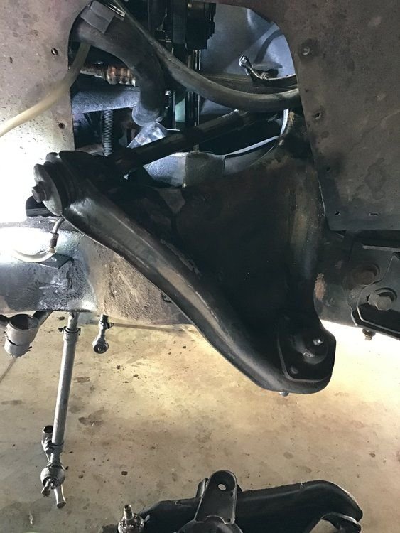

@interpon the more I look at your photos the more I can relate to what I have to do to get my control arms out. Thanks for posting the photos.
