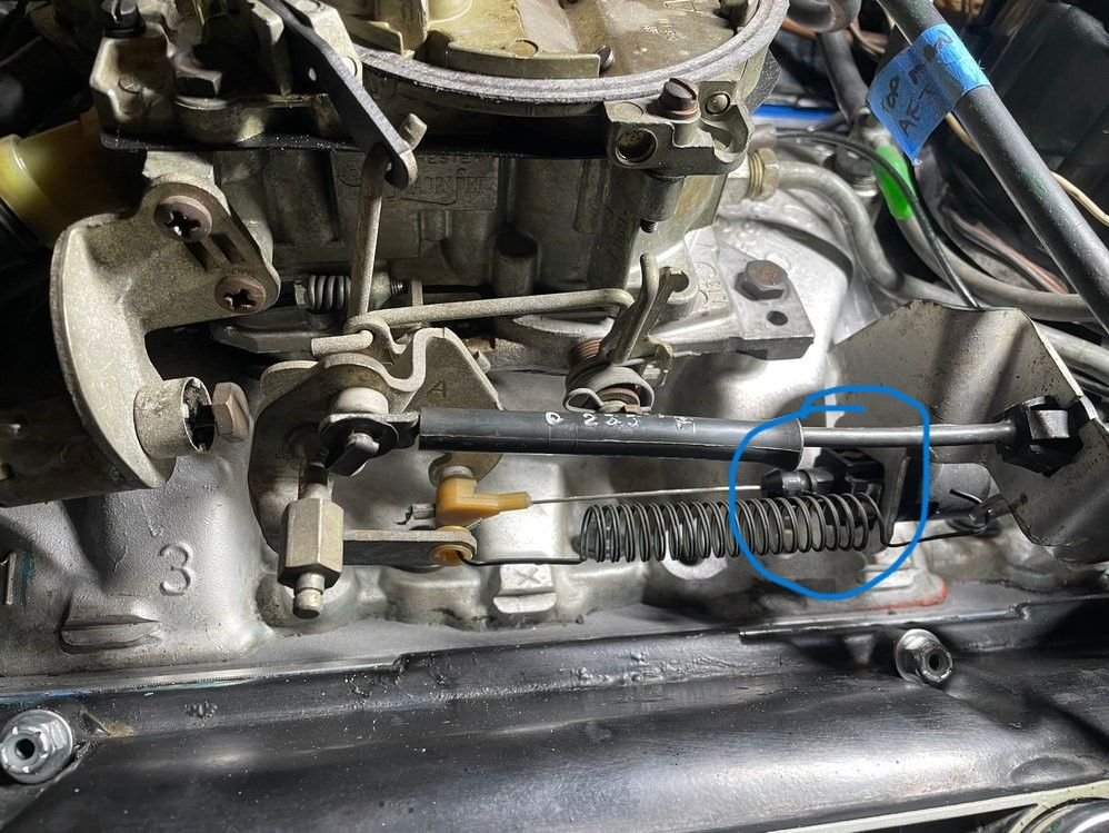

there is a metal tang/button on part circled.
press and hold while you move the black sleeve(cable comes out of) towards fire wall.
this shortens how much sleeve extends from circled part.
then, move carb throttle to full open.
this will move sleeve to proper length for shifting.

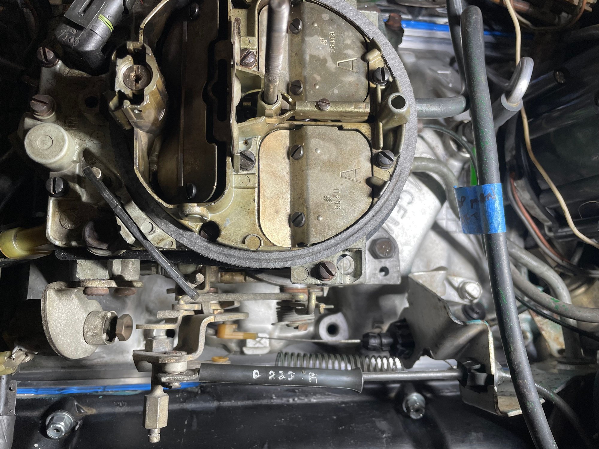

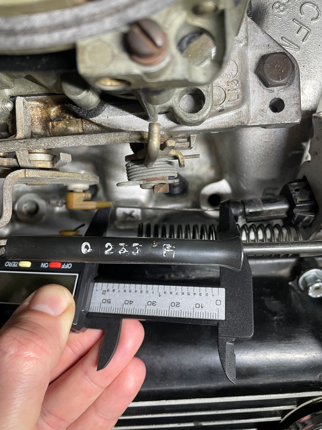

Thank you for explaining! I adjusted it the way you described it, I measured the initial exposed wire length (about 66mm) and after going thru the steps that shrank to about 55mm. I’ll let you know how the road test goes, I’m a little worried though because after looking at my pictures before I started my project it was set at that “backed out” length.
