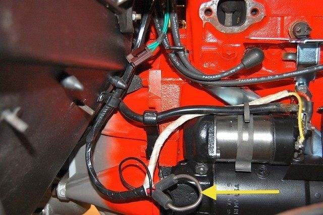

Not uncommon to have blown or damaged the fusible link feeding the horn relay. Located at the starter....here is a picture from Alan71.

Will the horn relay have any power if the fusible link has blown?
Old Nov 7, 2024 | 05:12 PM
Redvette2's Avatar
Redvette2
Joined: Nov 2013
Posts: 1,572
Likes: 486
If totally blown open I do not think so...but if burnt up maybe. Could also be a loose bolt or broken lug on the main battery terminal at the starter solenoid bolt assembly where the battery + and horn relay wire come together.
