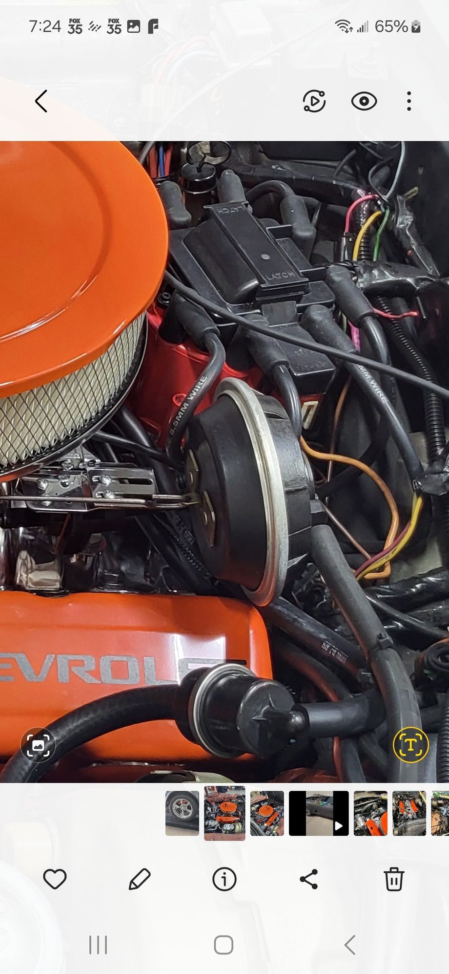

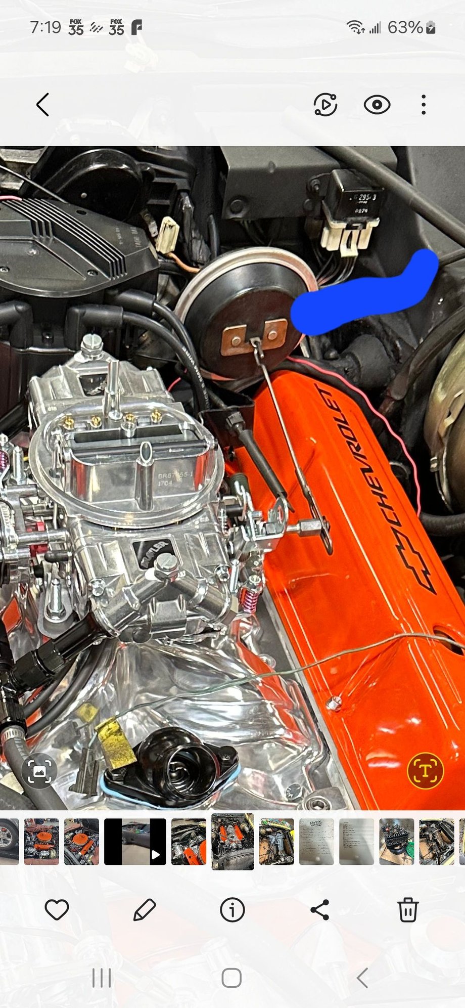

I am not that knowledgeable when it comes to carburetors but I was told that this carb had vacuum secondaries and the vacuum module for the secondaries was (see pic)

On vacuum secondary carbs, the vacuum more or less holds the secondaries closed until needed.
Without vacuum, which is half-throttle to full throttle, there is little to no vacuum.
But here's the thing. I see a secondary accelerator pump. That's a double pumper.

That module with the blue line is for factory cruise control I believe.
