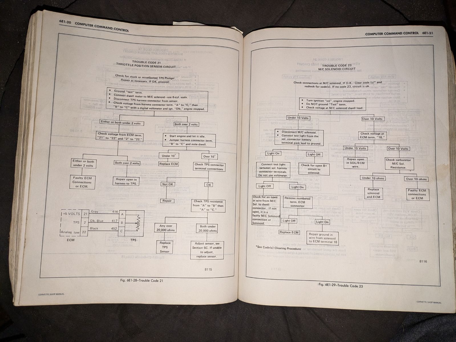

Notice it says adjust or replace.
Do you have the 1981 factory shop manual?
https://www.corvetteforum.com/forums/c3-tech-performance/145466-1981-comuter-codes.html
https://www.corvetteforum.com/forums...ter-codes.html
I don’t have the manual yet. I guess I’ll have to order one from Haynes. Wouldn’t the engine just run rough by bypassing the throttle sensor?
No not Haynes, it doesn't go into sufficient detail for any specific year. You need the factory manual for your year available from most Corvette vendors.
