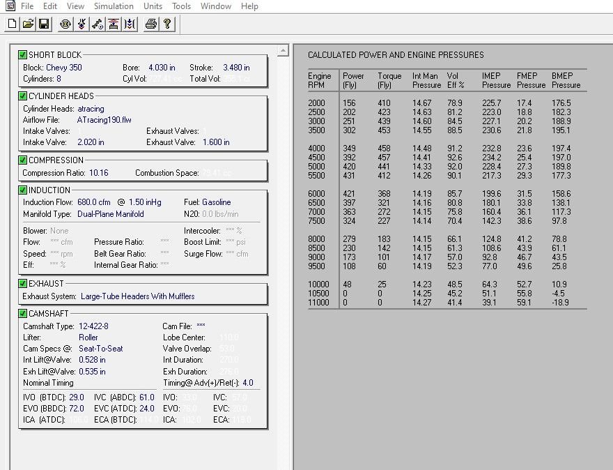

I have similair wants with my car as it also never sees 5500rpm and just sees spirited street driving. I used the smaller comp xe270hr for my 10.2:1compression engine as the dyno software showed the best overall torque and hp IN the correct rpm range that I want that power to be there. I have 3.55 rear gears I swapped in to replace the 3.08 gears It had up until this summer. honestly that gear change made a minimal effect on my combo. your gears are a bit weaker so you would see more change. the downside though is without an ovrdrive in that trans you will also be turning much higher rpms while cruising. this is why im installing a 2004r trans. the following desktop dyno numbers are optimistically higher than I believe they really are (its likely only around 375hp) and the timing @ adv number should be set to 0 vs 4 which lowered the results here in this simulation but this just givs you a ballpark idea of the rpms at which the power curve comes in with this much smaller 218/225 cam.
Im building a 406 now and ill be using a larger summit 1223 retro roller cam for that sinc the larger displacement allows it with less tradeoffs.

Thanks augiedoggy, i had my car on the interstate a little while breaking it in. The 2.87 gears let me run 70 at about 2600rpm's. I am changing the gears after the cam for more spirited driving around town but I want to keep a happy median between the interstate and town. I was thing about the 3.08 or maybe 3.31. I also have 17" wheels and tires which help, my tires are 27 1/8" tall
what software is that you are using?

I finally got ahold of the company that built my crate motor, the cam that was supposed to be installed was a
Howard 180255-10
2200-5800
231/235 @ .50
510/530 lift
110 lobe separation
The other cam I'm looking at
Comp Extreme Energy
1900-5600
224/230 @ .50
502/510 lift
110 lobe separation
When speaking with them i was told they didn't have the Howard in stock so they substituted which was their mistake. Someone less experienced pull the wrong substitution and I wound up the the monster cam I now have.
I asked if any other substitution changes were made like springs, push rod or rockers and was told no. I will however be reimbursed for the price of the Howard cam and something for labor but I doubt that will be much.
I don't see a whole lot of difference in these 2 cams but I am not that experienced.
I have a 2200-2800 stall converter in now that was hoping to tame the big cam. If I leave this converter in and use the Comp Cam, will my stall converter affect the performance or are the numbers close enough.
Will I get a good lope at idle with either cam?

This was a big help. After punching in new numbers for my TH350 I came up with
3.55 gears 3084rpm @ 70mph
3.36 gears 2919rpm @ 70mph
Not a big difference, both are tolerable but still undecided. Would there be much difference in bottom end take off ?

You won’t see much difference between the 3.36 and the 3.55, if you feel anything it will be the change you’ll feel by swapping from the 2.87’s.
Your cam choose 1900-5600 would probably work better with the 3.55 but if you go with the 3.36 you might look at cams that come on at 1500.
I know a lot of people worry about wanting a cam that creates choppy idle.
You should worry less about a choppy idle and more about how the cam performs and where it produces power.
My 496 has very little or no chop at idle, but everyone instantly knows it is a monster as soon as I push the go peddle, even a little.
