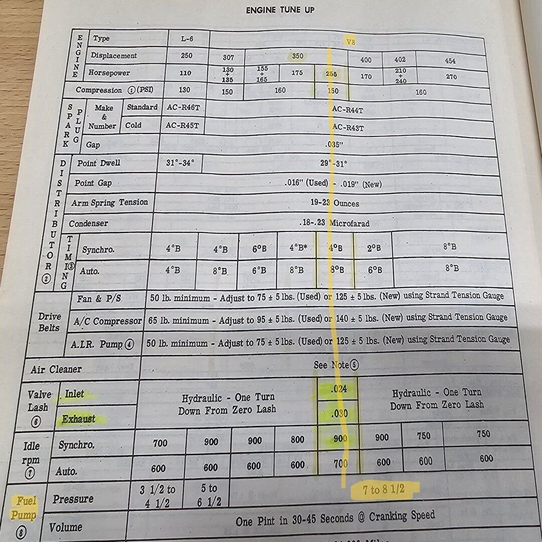

Okay, from the 1972 Chevrolet Service Manual the fuel pump pressure for the 1972 LT1 is 7 to 8.5 psi. Volume is one pint in 30-45 seconds at cranking speed.
The 1972 LT1 uses the AC 40956 pump so I am assuming these are the correct specs for that pump.
The Service Manual instructs to test the pump deadheaded.

Well I tried several times to upload photos from the manual but couldn't get it to work. Sorry

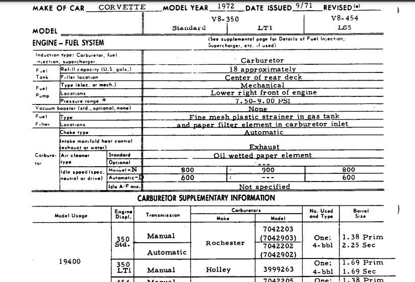

This is from the GM Heritage Center -
Here's the entire 163 page document -
https://www.gm.com/content/dam/compa...t-Corvette.pdf

According to that doc the fuel pressure is 7.5 to 9 psi at the pump.
