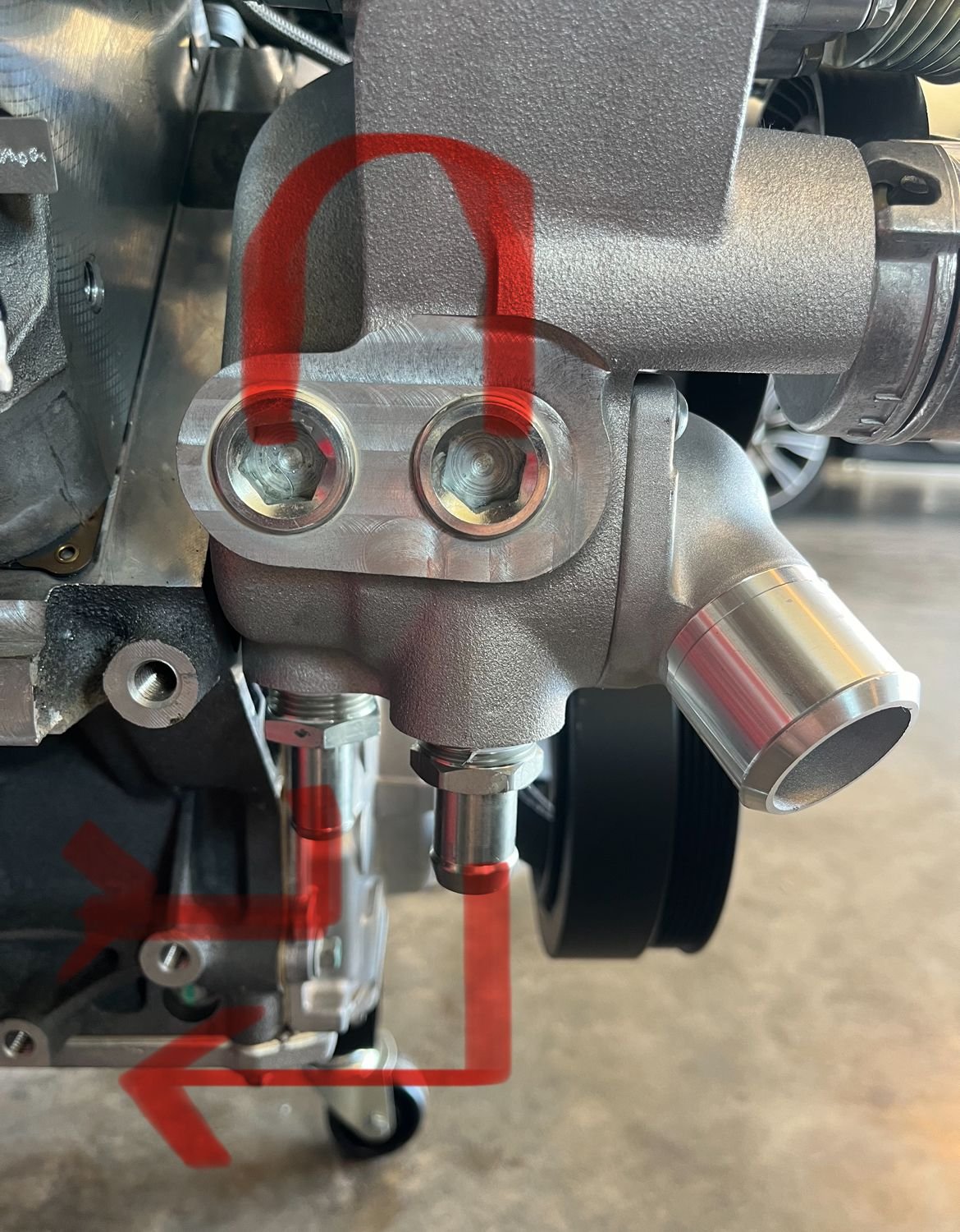

Stock LS routes water thought the heater core full time. I’m told that connecting the heater hoses from the LS pump to the C3 heater valve and heater core will cause the engine to overheat. This is because the C3 heater valve blocks the water flow returning to the pump when heat is not on inside the car.
I currently have the ICT heater core bypass hose installed on the LS water pump and therefore no heat.
I have the Holley Mid Mount that has 2 sets of heater hose ports. (Bottom and side of the pump) Would leaving the bypass hose installed, and connecting the other ports to the heater core and C3 heater valve work? Any other ideas to get the heater working in the car?

A heater bypass (U shape hose on pump) is what causes difficulty cooling because hot water is bypassing the thermostat and going into the engine all the time.
What you want is to block off the heater core outlets at the pump itself tap the heater core and plug them both.
https://www.yellowbullet.com/threads...ummies.621363/
Its not like an SBC. If you leave out the thermostat the engine recirculates hot water and overheats. That is what a U-shaped hose between the heater core ports causes also just not as fast

The LS thermostat is mounted backwards, and requires a hot signal on the cold side to open. It's more complicated than that, so I'd suggest you read up on it.
OP, you may get better answers with less snark if you post LS-specific questions in C5, C6, or on LS1Tech.com. I read up, and watched YouTube videos, and decided to drill a hole in my $100- LS water pump, rather than risk overheating.
Start by reading what @Kingtal0n posted.

Morning I agree with Bikespace on how the thermostat works. The way I solved the problem is I had a block made that went in the heater hoses with a 1/4in bypass hole drilled between the 2 lines. I have vintage air so I installed the bypass block before the shutoff valve.

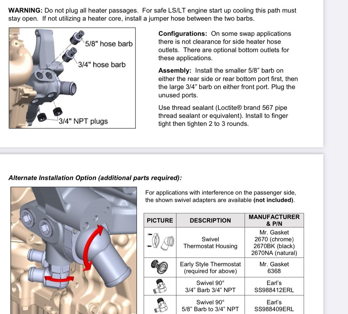

You are 100% correct on the LS thermostat operation. The Holley instructions clearly state not to block the heater hose ports and that a bypass is required to maintain flow. My thought is to use the ports already on the pump itself. Put the bypass on the Side ports maintain the flow. Lower ports connect to the C3 heater valve and core. Thoughts?

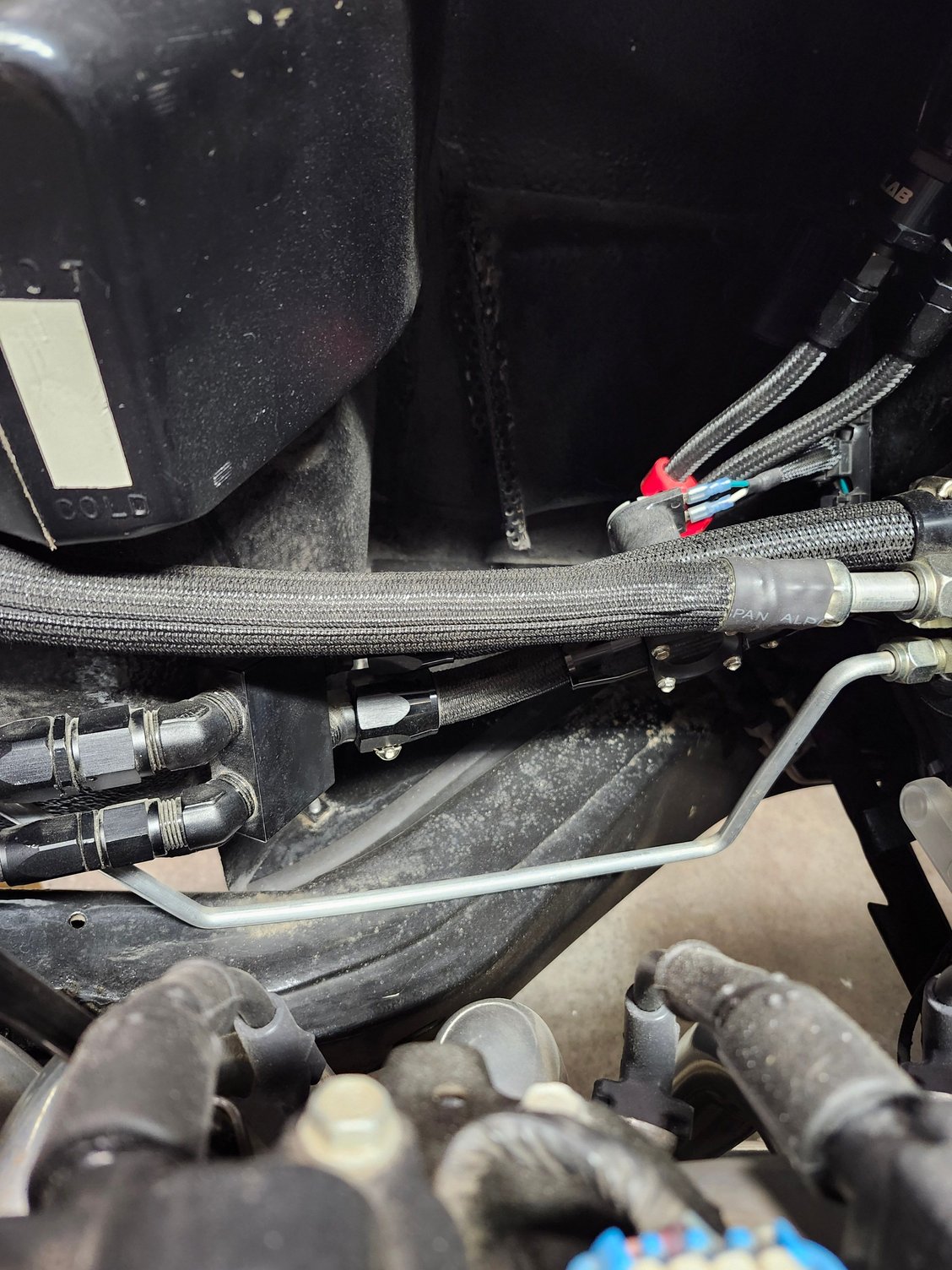

If you don't want to drill a hole (which you could always plug), I'd add the bypass to the heater line to avoid interference with the A-arm.
Easier, cheaper simpler,and more robust to drill the hole.
Great idea! I can add a Tee in the 3/4 line going to C3 heater valve. Connect the Tee to the rear port of the pump as there is clearance.

I'd like to see where it says in some holley instructions that they need to be kept open because I think its either a mis-print or incorrect and I will contact Holley over it
Although maybe they have provided a non-standard water pump? Or some aftermarket thermostat that interferes? Is this a kit? Like engine pulleys and thing? Can you provide part# for water pump I am intently curious

Here are the instructions.

It must be because of this 'LT1 Water pump design'
As in, not an LS water pump design? Looks similar to me I will check into this

To be honest. I think whoever wrote the Holley instructions was just guessing and being cautious. In other words, I don't think even they knew.
I don't think the person who wrote the instructions designed the pump or understands how it works. I've found a couple mis-prints or typos in the holley instructions before so it wouldn't surprise me if they winged it.
It may be, that somebody decided to play it safe and do what people have been doing (wrong) for so many decades already. Because if you tell people to let the water flow, the worst thing that happens is the engine seems like it always wants to overheat and has difficulty cooling, but it will still 'work' and pump fluids around. If you notice this behavior then, thats probably the problem.
Waiting to hear back on this though. I don't know what "LT1 PUMP" means tbh. I opened a thread on holley site and if anybody wants to send them an email or take pics of the insides of this special pump so we can compare to LS1 pumps that would be great too

To close the loop on this, it seems that @TorchZ51 is using the Holley Mid Mount pulley/accessory kit. The second set of heater hose holes is unique, AFAIK. All other LS engine water pump solutions require plugging and drilling new holes to avoid the C3s A-Arms (unless you get very lucky). Perhaps you can confirm that the kit uses truck spacing (-03) for the accessories?
Anyway, this thread came back to life, along with a solution of how to build that system for almost a reasonable price. The author of this video "saved" enough to buy a running LM7.
https://www.corvetteforum.com/forums...mid-mount.html
I don't know if I'd be willing to drill a hole in a $350- part, either, but that's what the crucial part costs (Holley 97-163).
