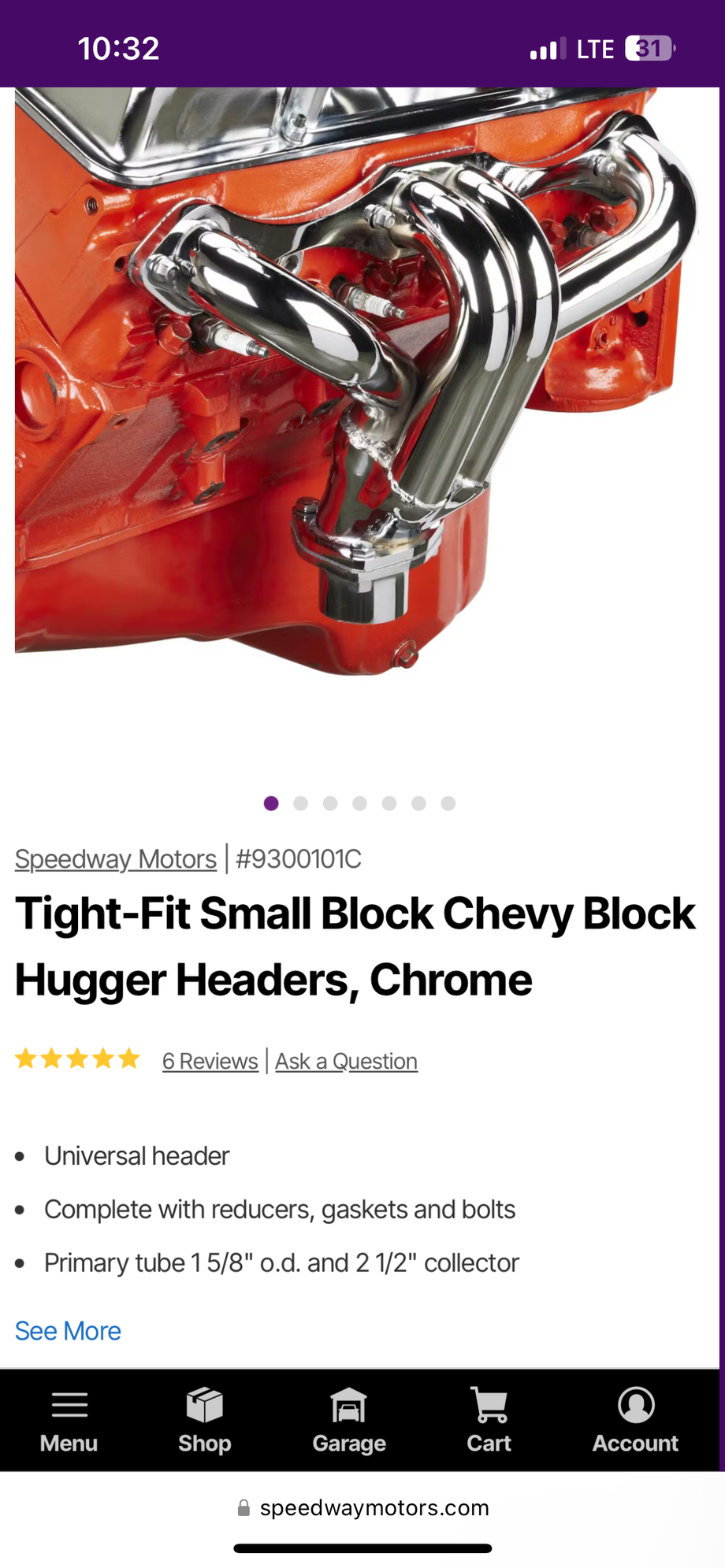

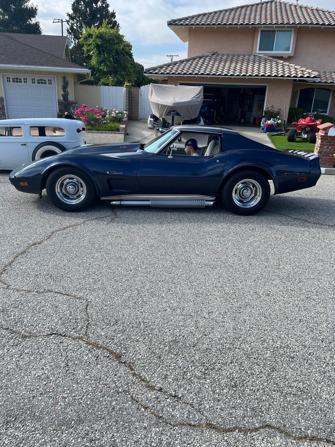

So I just order a Flowmaster Force II crossmember back exhaust. Before I get it installed I was thinking of putting new headers on. It has headers currently but they look old and thinking of getting these from speedway. Anyone ever got these? Any feedback is always appreciated. For the price seems like a good deal for the price. Going from side pipes to this set up. See below for reference of car and pipes I’m looking at.

For the price they are pretty useless. Very difficult plug wire clearance. These are NOT long tube headers. You would be no better off than factory manifolds.
Why not look for proper headers? Or 2 1/2 inch manifolds.
100%….
They might look a little sporty but not worth it at all. I don’t want to waist your cash so get a better performing header. Then if it's not an option from the seller send them to be ceramic coated inside and out. That’s a good way to reduce under hood heat also.

I agree with the above posters that the shorty style headers are not worth the trouble. Long tube headers are tougher to install on newer Corvettes with all the restrictions under the hood but they make hp. The ceramic coating does help with the under the hood heat levels which helps makes the car more fun to drive and use.

Thank you for the feedback. Car already has the shorty style headers. My concern with the long headers is ground clearance. Since the car is already lowered. Any recommendations?

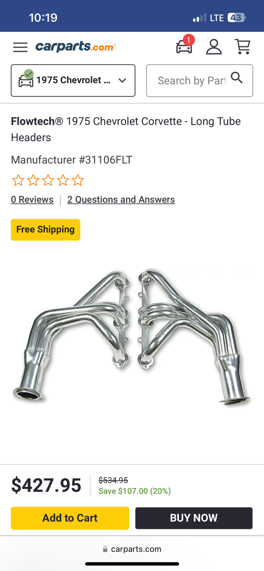

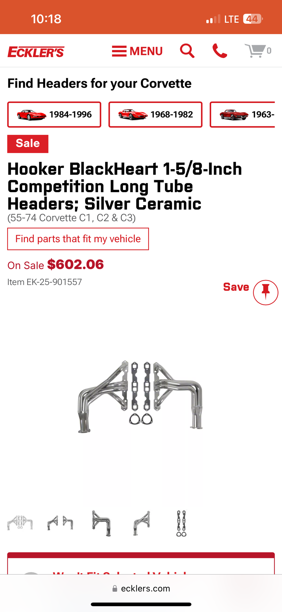

So what are the thoughts on these two options? I like the flow tech price but I know hooker is also a good brand.

I think my car is lowered more than one inch in the front. I think a least 2-3 inch drop. How much ground clearance do you have from the header to the ground?
