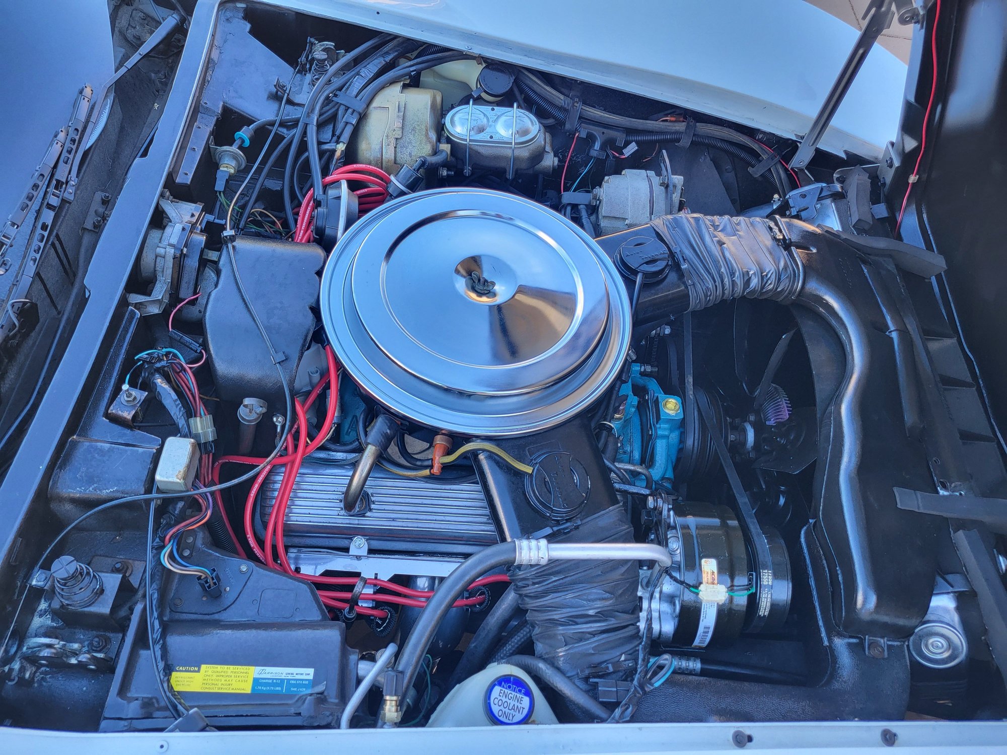

Hey everyone,
I am about to install Doug's Headers on my 1980, I have read the instructions and I am not a stranger to installing SBC headers. My question is around what is never really published in full, the deletion of the smog/pollution components from the car. Hypothetical question of course. I can see the air pump and the exhaust connected hoses/pipes but the other hoses and components that need to be bypassed/plugged I have no idea. Has anyone documented this fully?

Only thing that comes to mind is the vacuum line to distributor advance should be connected to manifold vacuum directly, no TVS valve. Everything else isn't needed.
Are you running the stock air cleaner?

I removed it all from my 80 when I installed Doug's headers

I plan to run stock air cleaner yes. Any picks of the direct to manifold you speak of?

Start the engine place your finger on the selected port and feel for vacuum at idle and above idle.

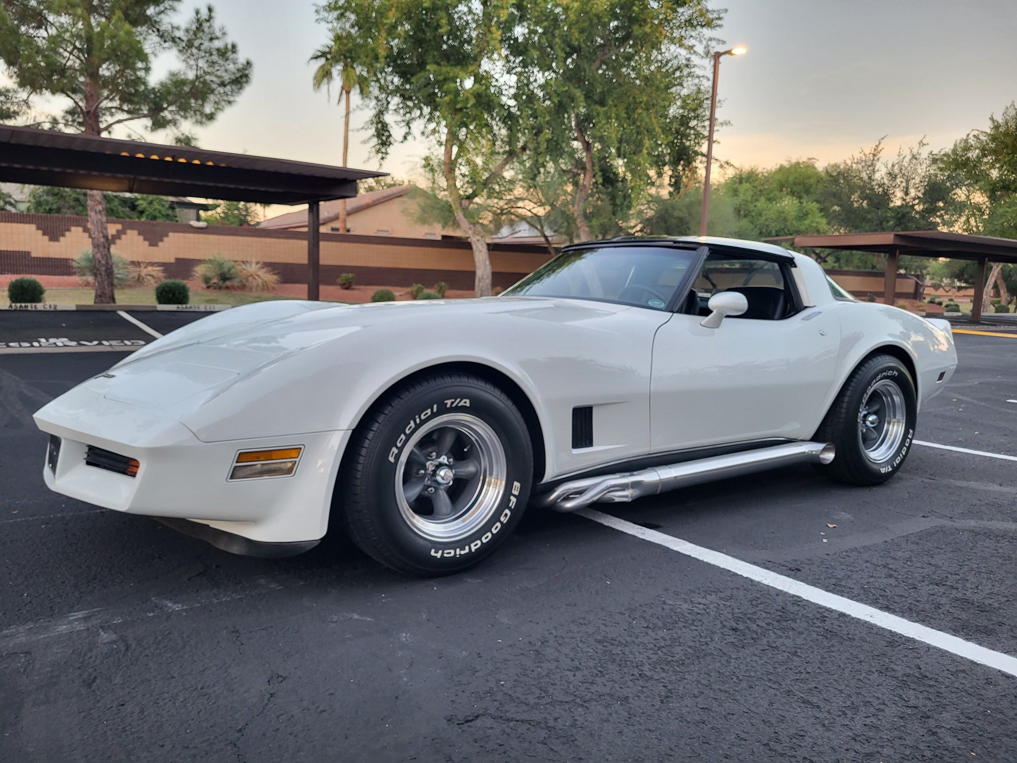

I actually installed Doug's headers and side pipes so perhaps a little different under the car but no modifications needed at all, just shorter spark plugs

Torque-Thrust wheels and chrome side pipes.................
