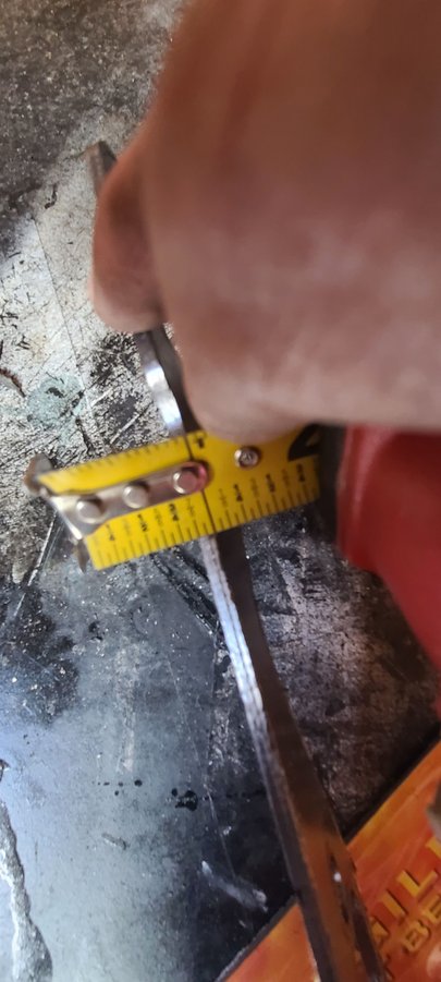

One of the issues I have had are with the embossed/raised edge of the copper and aluminum gaskets. The exhaust ports on the headers are D shaped and the header inlet is oval. I could not find oval metal gaskets, only square and round. It looks like Earls have a much wider surface area, but the Remflex are pretty flat. They compressed a lot - from 1/8" thick to 3/32" (a guess - I didn't measure). I think the compression allows them to seal initially, as well as handle heat/cool cycles.

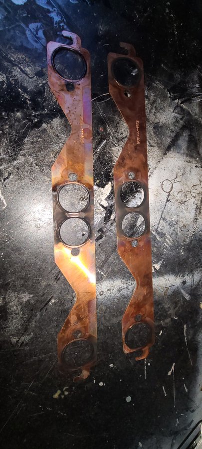

The Soft Aluminum and Soft Copper header gaskets are awesome as well. I have used them for over 30 years without a single leak. I thought headers gaskets were supposed to leak a little but with a thick header flange and soft copper gaskets they never leak or get loosened up.

Why do so many headers leak so badly that we have to use expensive specialty-made gaskets? I was familiar with all the old horror stories about headers and header bolts. What gives here? Are they using thin flanges or something else marginal? Is the loosening all caused by thermal cycling of the hardware?
Hedman headers come with a thick flange (3/8") that doesn't have issues with hardware getting loose. I put them on the Corvette and that was the end of it. I have never had to do anything to stop any leaks or loosened hardware.
